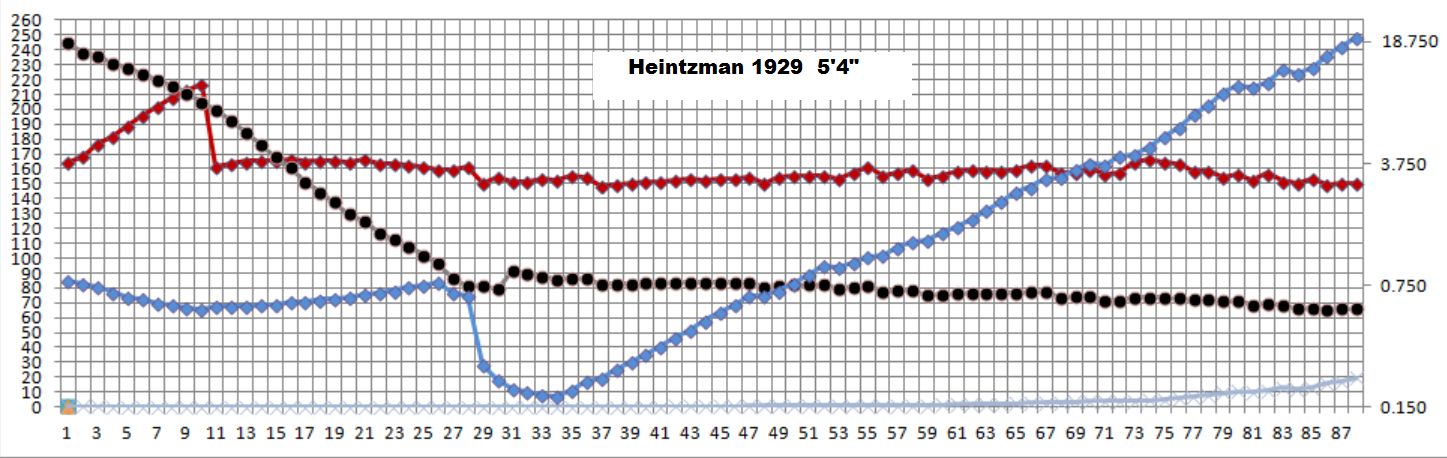

A great designed little piano with tons of potential. But, you're not going to improve the scale too much. It's pretty darn good as is . Heintzman knew what he was doing.
Here it is on a spreadsheet. Tension, InHarmonicity, and Impedance.

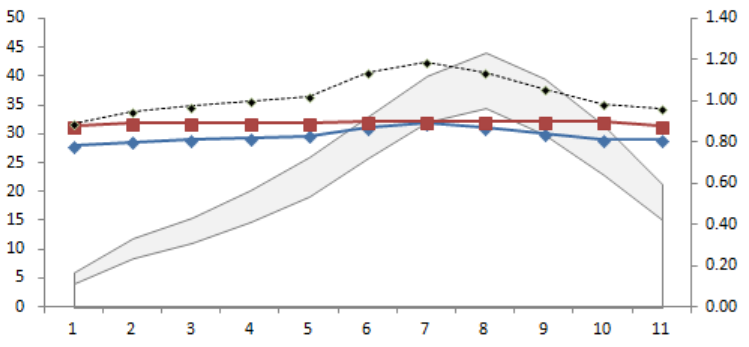

The problem with the piano is the soundboard Rib scale. IT'S HORRIBLE!!  It might as well be a dining room table in there.  The panel was a non tapered solid 3/8 through and through.
Notice in the diagram that the largest rib #7 is not the longest rib #8. Just one of its many problems. Plus, I suspect that their procedure of installation is faulty. At least the board I removed was. It was flat as a pancake in the piano, but crowned up significantly when removed.
I made a new soundboard with a classical structure and Improved the rib structure. Incredible sounding piano now.
Putting a hybrid rescale on a terrible rib scale don't make sense to me.
​​My philosophy on restringing software is to not use them.  Better to make your own. Learn the math formulas and how they work first, then create your own speadsheet with the proper knowledge to back up your rescale. Rescaling is NOT just looking at smooth lines on a computer screen. My 2 cents.
