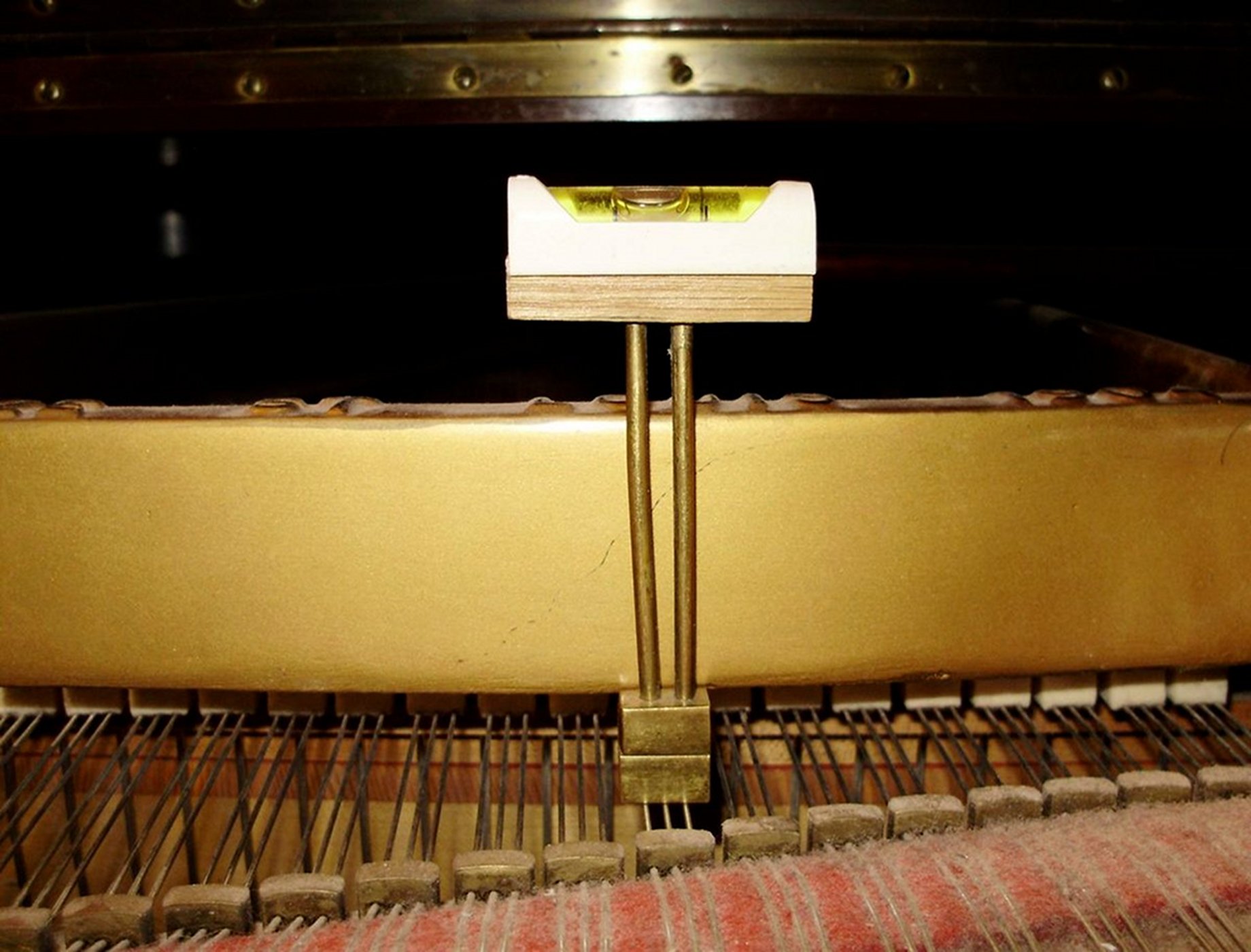

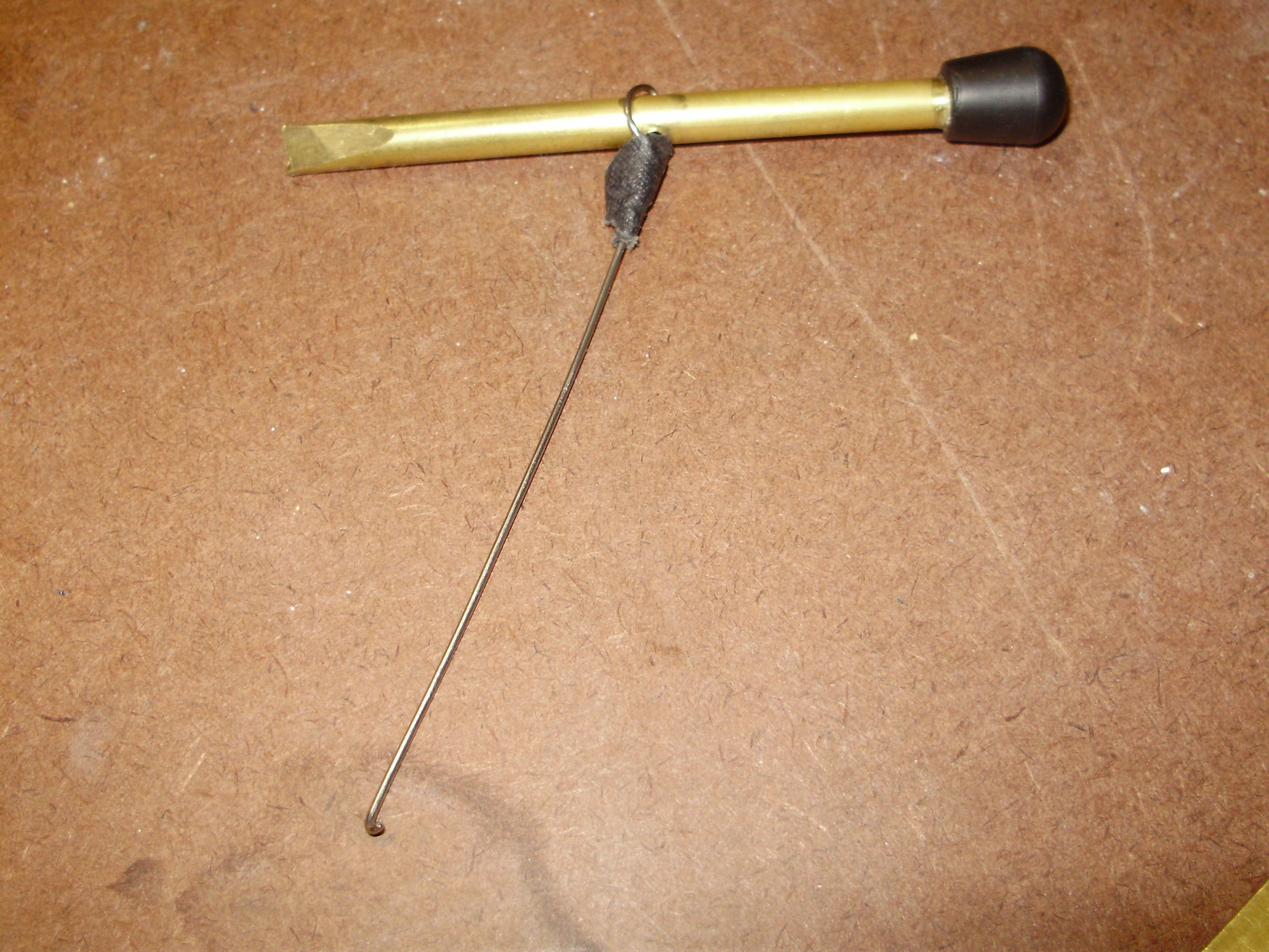

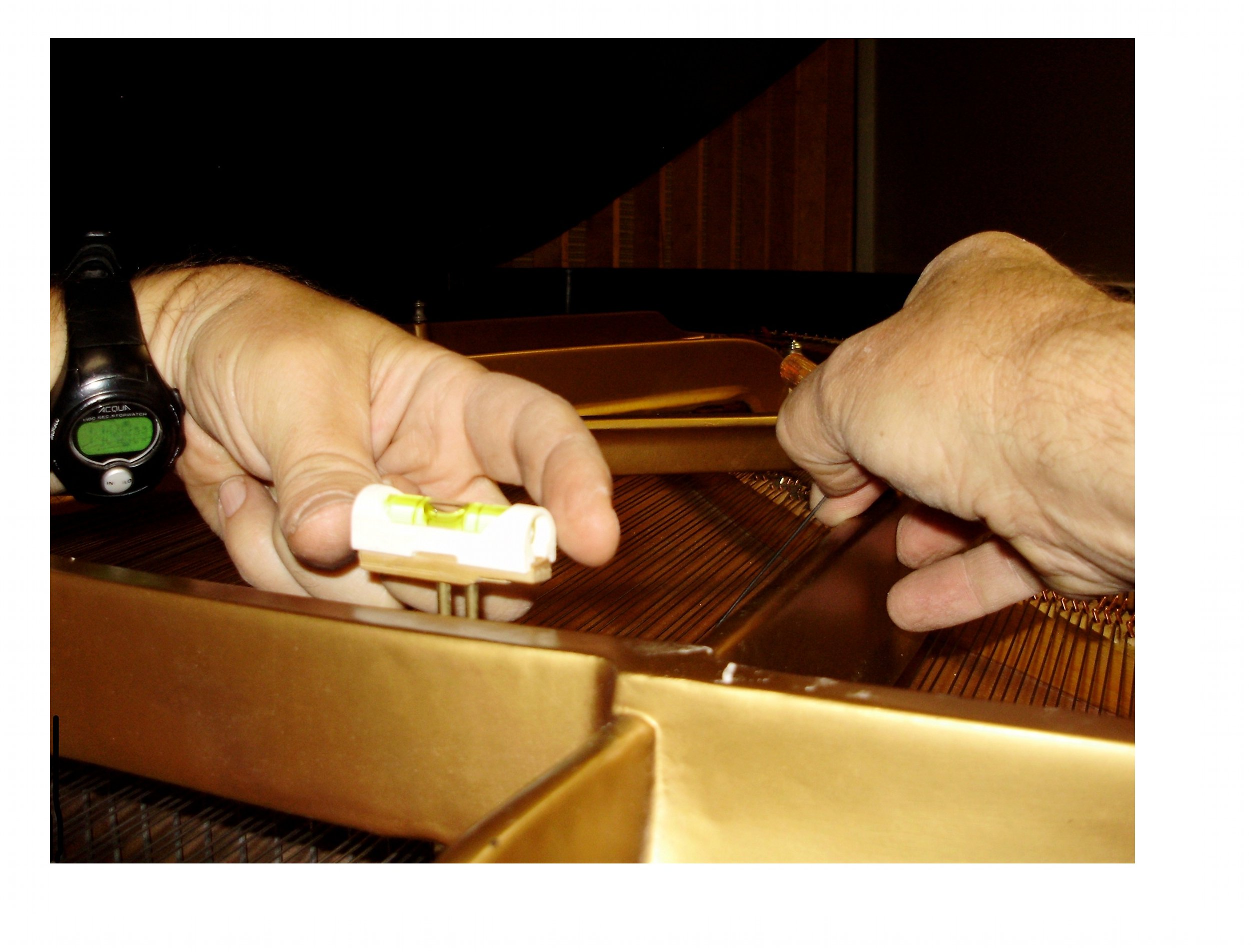

    As for technique, I have often posted photos of my own homemade tool, but perhaps not on Pianotech. Here it is, pretty self-explanatory. Brass square stock on the bottom, two layers because I needed that much weight. A couple 1/8" brass rods to extend upward, so the level clears the capo or plate strut. A pocket level attached via a small piece of wood. Get it level, shoot with CA. I made two of these about ten years ago, and have used them happily ever since.
    The technique requires that the level be very lightly steadied with finger and thumb of one hand, while the other plucks the strings to check. Otherwise, it will rock with the vibrations of the string, and you'll get a false reading. The plucker is also the puller (made of round brass stock, a music wire hook). Tool stays in the same hand, for maximum efficiency. The Goss tool is OK, but it is very short, hard to see, and hard to get fingers down to steady it. It also won't do the unison next to the strut, which tends to be the one that needs it the most.
