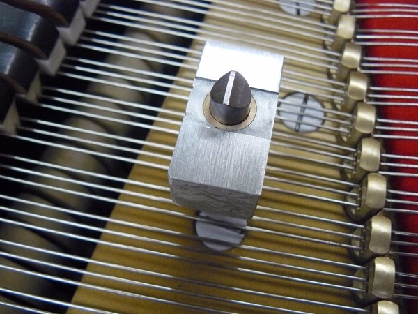

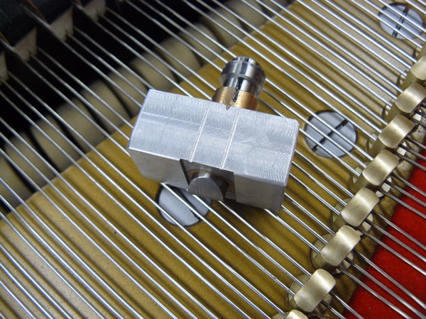

    Re the missing bubble thread, I have tried every string leveling technique under the sun, and have and viewed the process with extreme skepticism. Not skepticism as to the utility of having the strings sit in a flat plane @ strike, but skepticism about the measuring accuracy of that plane. The repeatability of measurement with the tools I have used seems extremely subjective and liable to be misread, or at best unbelievably clumsy to use. The down side of misreading is that a misread string level is an absolute waste of time.
     As often happens in the shop, it is when I try to teach someone else one of these ridiculous processes, processes that I have put up with for far too long, that the ridiculousness becomes obviously and completely untenable.
    So my son Dave works with me in the shop, and is quite good at these picky-ass skills. However when I put him on this task and watched him struggle ineffectively with the measurement and then the adjustment, watching his frustration, I just said, "No more"!
     It took a couple of hours and several tries to get this tool working…I had tried the concept a couple of years ago, but it didn't work, because close machining accuracy was required…ie there was too much slop in the plunger. I got the accuracy nailed this time
    So once I got this working, I tried it out, and literally flew though the process with repeatability that escaped me before. I put him on the task, as a newby, and he moved pretty well too…none of this paying your dues crapola…the process sucked. It is in fact relatively easy if you have an appropriate tool.
     Here is the interesting part for me. I had previously fingered the wrong part of the process as "the problem".
    Many techs have complained, including myself, that adjusting the travel of the wire off the termination seemed to be the problem in this task…ie you read the out-of-level condition, adjust the bend, re-read level, adjust bend, ad nausem. The problem seemed to be that it was too hard to calibrate the exact force needed to adjust that bend to the precision needed. The result being that one was always going too far with the bend, then having to yank all the others further than they wanted to go.
    But I was incorrect about the calibration of the bend being the problem. With a tool that stays seated on the string, and gives a consistent, repeatable reading of the string plane quickly, first, you don't have to figure out which string is high or low by tilting the reading tool or reading a bubble, etc. You just place the tool on the unison, allow the light plunger to drop of its own minimal weight, and lightly pluck the strings…actually not the strings, but the string in the singular. You don't even do the 3 string comparison, rather, if you hear the string vibrating, adjust it up. One at a time, since the tool remains on the string giving repeatable readings, gently incrementally increase tool pressure to the bend until that single string's vibration is stopped by the plunger.
    When adjustments happen quickly in succession, ie very soon after the last try, the body retains a memory of the previous force used…the relative increase from try to try becomes much easier to incrementally calibrate. The difficulty of calibrating bend force is really a matter of being able to quickly read the change in string height, so you can incrementally increase adjustment force in a period of time that allows the body to remember the how much force was used last try.
    So my take is it is not calibrating the force that is the difficulty in this task, but the difficulty is being able to read the out of plane condition very quickly with repeatable results.
     Any thoughts?

    And... you're selling this tool for how much? Plans, dimensions, ?

    Charles Faulk has a tool identical in function (though not identical in shape. Works great!

    Very nice Jim!
    Isn't that actually an invention you could patent?

    The Faulk unit basically levels relative to about 4 or 5 other unisons.  AFAIK it is not intended to make everything perfectly level...just PRETTY level so that, if you have shoe shined the 'squared ' hammers at strike point level, it will not take much work to mate them up to the 'leveled' unisons. I really like the way the thing works. Plus, he includes a nice little tool for bending the strings.
    Jim arrived at virtually the exact same device...just a different design. Should work equally great. Yours works great too!

    The business end is simple to build with off the shelf parts. A short length of 3/8" precision shafting for the plunger.  1" x 3/8" bronze bushing. A 1-1/2" x 3/4" x 3/4" piece of aluminum jig plate. After you get the plunger fit right and smooth without any side to side slop in the plunger, the important thing is, as the final step, to lap the business end of the plunger and the bottom surface of the aluminum  together so they are in a perfect plane.
    If there were sufficient interest I would make up a run of them, and come up with some pricing...but my post was more about the discussion of string leveling in general. I am a string level skeptic. When leveling, I am tuning each unison right where it needs to be, leveling, re-tuning and correcting level as needed. After a couple iterations of level-tune-level-tune-level tune, the level seems to become stable. I  am not convinced that subsequent tunings don't change plane of the strings. Confirming level over time, is difficult, because dampers are in the way...strike point is often under or very close to the dampers, so the tools can't get in where they need to be.

    re the tool, its just gratifying to beat a recalcitrant process at its own game.

    By the way, I have decided to make a couple of the leveling tools I showed in the thread's initial post, to see if others like the tool as much as myself and my son liked it...Gen II...PM me if interested.
