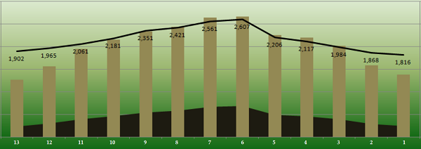

Chart Legend:
Dark area at the bottom is the load on each rib
Vertical Bars are the size of the ribs
The Line at the top is the stress levels of each rib
Board 1:
Analysis: Uneven stresses and incorrect dimensions for ribs. Both stress levels and rib dimensions not in sync with load distribution.  Profile: 82%  Stress: 2,099 Psi  Load 975 lbs 10.8 sq in.

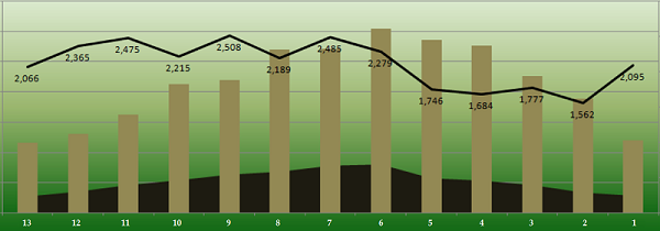

Board 2:
Analysis:
Not quite identical to the first board. Some ribs vary in stress up to 200 psi more than in the first board. The stress levels and rib sizes are again not in sync with the loads. Profile: 83% Stress: 2,044 Psi  Load 975 Lbs 11.0 sq. in.
Why copy those obvious mistakes when they can be fixed and improved?

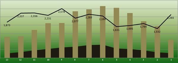

Board 3:
Analysis:
Now the load, stress levels and rib sizes are in sync. As they should be. Profile: 74%  Stress: 2,208 psi  Load: 975  10.6 sq.in
Amazing results.  Live demonstration at my shop June 6.
