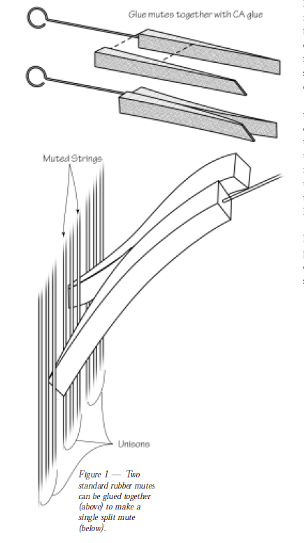

    Have you tried going stripless? Use only rubber mutes in the treble section, not only in the upper middle section, but also the entire top treble.
    I don't even own a temperament strip any more, and do the whole piano using mutes. I'm not trying to talk you out of using a strip, but in your case, starting at about C5, use two 2" long rubber mutes on handles. Put one in the right side on top of the damper, but you can also pull the damper out and put the mute behind the damper. Do the same thing for the left side.  Tune the middle string, pull out the right damper and move it to C#5. Tune the right string to the middle string on C5. Then move the left rubber mute to C#5, and tune the left string of C5. repeat.
    When I get to the top section, I use a split rubber mute. Some people like the pabst mute, and they are fine. My prefference is a split rubber mute. Again, if there isn't enough room between the hammer and the damper, you can put the mute behind the damper.
    After a while you'll realize that using two rubber mutes for the whole treble section save you time, and in my opinion, results in a more stable piano. It will also hone your skills tuning unisons. I use a 4" rubbermute for the bass section.  On a grand I use two felt mutes, except for the high treble, where I use the 4" rubber mute.

  • 9.  RE: K25 muting
    Posted 09-22-2021 20:02
    The following idea from Mitch Kiel,  RPT, appeared in the April 2003 Piano Technicians Journal.  I use mutes that are 1/4 inch thick, and put an offset bend in the handle to make things easier to manipulate.  I've not used these in a K-52, as far as I can remember, but they are my go-to choice in tuning the treble of vertical pianos.
