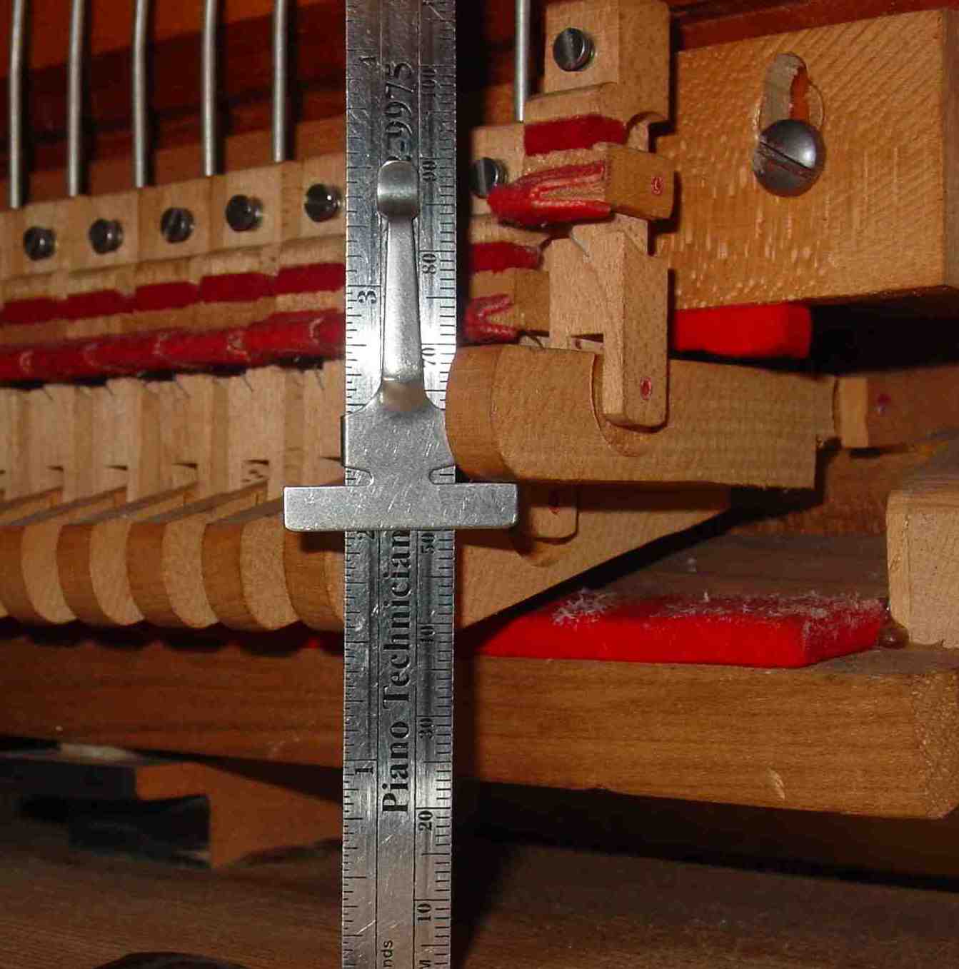

    The way to reconfigure back action geometry is to measure the height of the end felt with the key fully depressed. Measure the height of the underlever when it is lifted to being parallel with the keybed.  The key should lift the u/l to that height.  Subtract the end felt lift from the previous u/l measurement, that is the amount that the tray has to be lowered. The key should lift the u/l to being parallel with the keybed. Pay attention to the back of the tray and the dags for clearance.

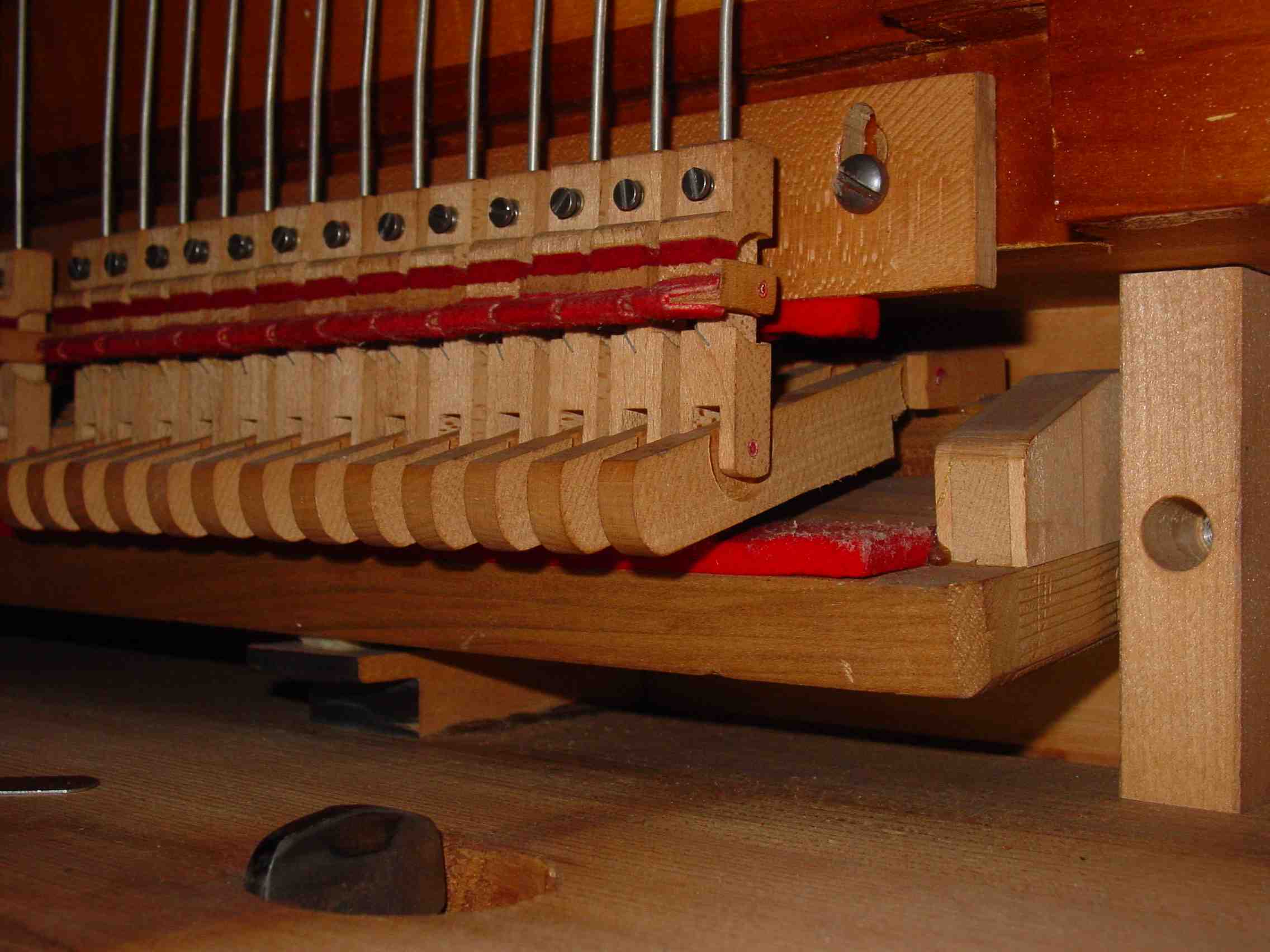

    That and maybe who ever replaced the original end felt got the wrong felt. There could have been compression of the original back rail felt, I believe the back rail felt I choose is what the original was, judging from the height of the felt at the cleats when I was done. The under felt on the back rail looked like it was just out of the box. I'm going to try and attach a picture
    Would the distance at the step down at the end of the key indicate the thickness of end felt?
    Jon,, It seems to me that the damper lever can't be level at the end of the stroke.
    Since the lever contacts the key end about 10+ mm from the key end,, as the end of the key rotates up to or past level, the contact point will move to the very end of the key. That will add extra lift to the damper lever at the very end of the stroke. Wear or compaction of the felt at the point of contact will increase the problem so there should be a slight down angle of the damper lever at the end of the keystroke.
    Hopefully from the picture you can see the end of the key has a slight tilt to the front at the end of stroke.

    It has been my observance that most if not all tray pivots are too high creating excessive sliding friction on the felt. The least sliding friction is created when the underlever is lifted to parallel with the keybed. The end felt is not at an exaggerated angle to have the u/l crushing the end of the felt block.
    Extreme slope digging into key end felt.
    Lifted Parallel to keybed

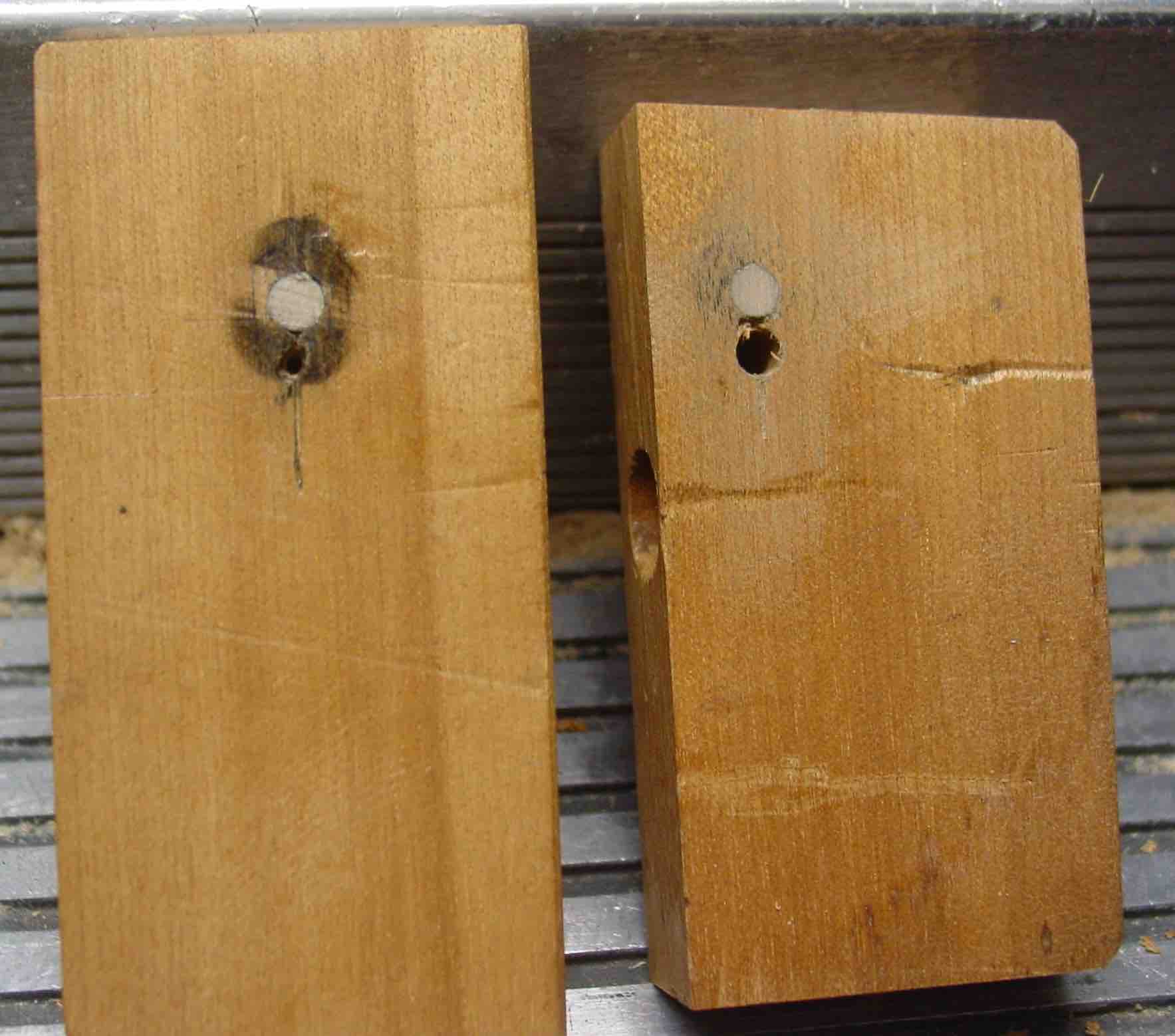

    Relocate pivot holes, this can be done with dampers installed. It will delay lift timing due to the top flange acting as a pivot witht he u/l suspended by the wire. Sometimes the timing is corrected from compressed felts, a two-fer.
    U/L set to key rise
    New u/l configuration
