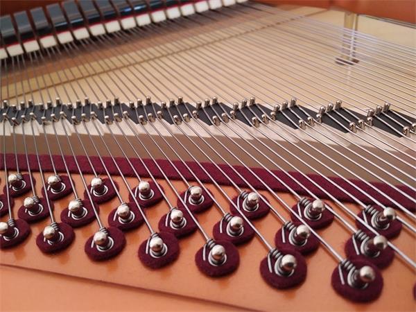

    Here is a photo from DanPiano.com found on a Google search of what Bösendorfer eyelets look like. The curve of the tail seems to diminish as you go from left to right in the picture so they are not all perfect examples. But a nice effort was made and the tails do end up at a 45 degree upward angle. As I searched the internet for hitch pin loops on Bösendorfer, virtually all the other photos had straight tails going straight out and that is not how they were made.

    The double loops would have 2 circles in the eyelet and usually end in a straight tail going straight out. Original Bösendorfer plain wire loops have only the one circle. Or at least they did in my time.

    Bass strings and plain wire gets ordered through Yamaha. Initially I was under the impression that they could make a duplicate set of strings from just the serial number but I have been informed that is not the case due to the age. I will need to measure everything and fill in their little form.  Also, the form states that they have changed the spec of 10mm from agraffe to winding to 25mm (probably to give the string maker a little more wiggle room).
    The plain wire loops are single, and I have in fact seen the video of the guy making them. I even practiced a bit and got pretty good at duplicating it. But it would definitely be easier to simply pull them off a wire and install at this stage of my life.
