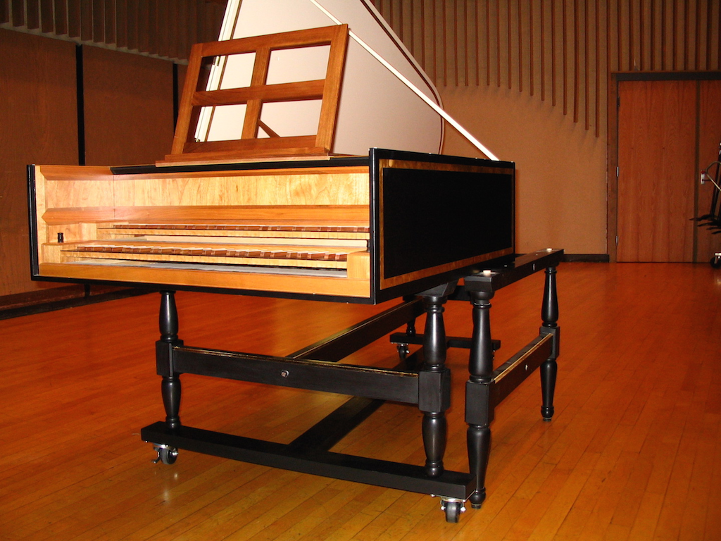

    We have adapted a number of our harpsichords with 1.5"-2" casters installed under the bottom horizontal member of the stand. Not all instrument stands have a lower cross member like this, but I created one for our 1970's Dowd, which is the gray one in the photos. The casters are permanently installed to raise the instrument only about 1/4" above the floor to allow for ease of rolling within a room or onstage. They usually still need to be put on their sides to fit through doorways, but the harpsichord prof is quite pleased with the modifications.
    The thin spindle leg with the 3-wheel leg caster is on a fortepiano, and needs to be moved very carefully to prevent the leg from snapping off. The 3-wheel casters do work in a pinch for the harpsichords, but they do leave the instrument about 1" off the floor, which is really too much to leave on while being used.

    Posted 07-04-2015 20:21
    Sounds good, John.
    Have others been able to view the images John posted? All I got were several "image not found" prompts.
  • 8.  RE: Harpsichord Casters
    Posted 07-04-2015 20:50
    No luck on viewing the photos, Safari or Firefox. I sent Clint a note.

    Some years ago at IC I made trucks to use for the harpsichords. We still had to remove and replace the instrument for use and performance. Both the Hubbard and the Dowd are heavy instruments so I had a local builder make shorter legs. We used the original front to back stretchers in the design. One could argue about the aesthetics but for institutional use it works and I never heard complaints. The third harpsichord at IC has eight turned legs with stretchers at the bottom so it was not in the budget to make a shorter stand. I did make a truck for this instrument however as we needed to move it around the building safely.
