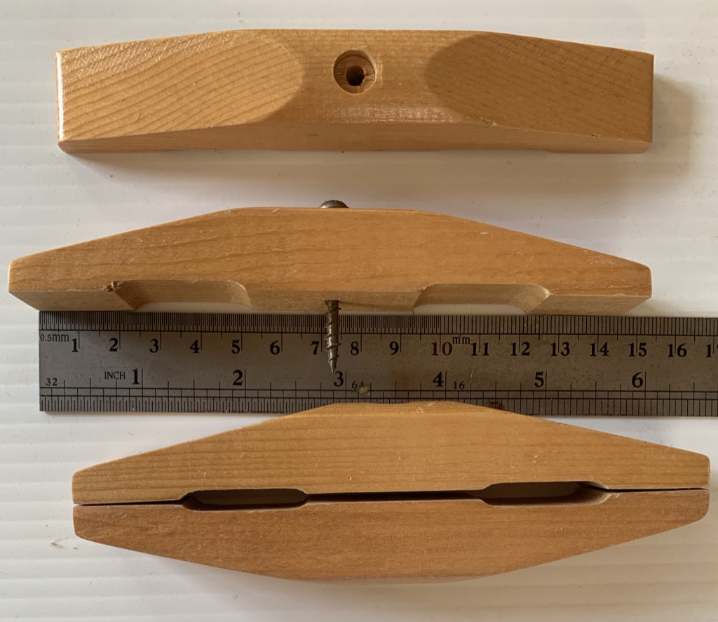

    Have you considered Fandrich Riblets?
  • 12.  RE: Lost crown at treble end of soundboard on historic piano. Any remedy?
    Posted 13 days ago
    Here is a photo of Darrell Fandrich riblets.
    Note the slight concavity of the flat surface.
    They are meant to be attached under the soundboard, screwed into the bridge, in between the full ribs.
    The purpose is to add stiffness to the bridge-soundboard structure. The added impedance can reduce the impact sound and add sustain.
    Drill a small hole from below into the bridge and attach the riblet.
    If it helps, leave it. If not, unscrew it leaving a small hole in the bottom of the soundboard.
    Darrell is deceased, but I believe you can buy riblets from the family company. http://fandrich.com
