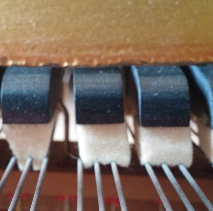

    The middle damper in the pic below leans to the right and is not seating squarely on both the front and the back of the two damper felts. The left string has noticeable bleed through. The dampers are all fairly new and soft, like new. The piano doesn't get played much so I'm guessing the damper got accidentally nudged out of place and then sat there for a very long time uncorrected. I'm thinking that I may have to remove the damper felts and place them a bit further to the left, since they are noticeably not centered. Any other suggestions?

    The problem is, the damper head is not centered between its neighbors. Increase the bend above the guide rail to center the felt over the unison. Make certain the wire below the rail has the proper bends for the wire to enter the top flange unimpeded and the damper travels straight when engaged, the easiest way to observe this is to engage the pedal or lift the tray. It's Damper Fitting 101.

    Additionally, note whether damper guide rail bushing is (roughly) centered between strings, or at least not egregiously off.  If so, that should be attended to first,  Also, if guide rail holes have side to side play (some being normal), make sure wire is bearing positively (but not excessively) toward the bass, which, in picture would be to the left.  Felt appears to have been glued slightly to the right.

    Then after doing that, if I bleeds, replace the felt and you're done.

    Caution! Making this bend can easily hurt the wire to head connection. Avoided by holding the area in place with a parallel pliers and /or removing the damper before bending.
