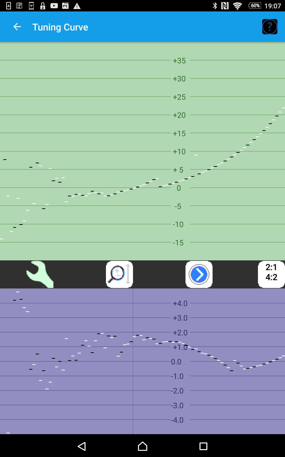

    But this didn't work on the Ruch. The tuning was all over the place and sounded hideous. Years ago I used to use the shareware version of Tunelab but haven't had need of it for years, my current technique in every other instance giving better results than standard inharmonicity measurements and curves. But newly having the trial version of Tunelab on my Android I thought I'd do the inharmonicity measurements to see what might be wrong and measured every note up to treble C.
    The strings are old and weren't cooperative in moving with the pin movement and two broke on me just at the start of the coils on the tuning pins. As the graph shows, the inharmonicity was all over the place.
    Screenshot from Tunelab
    As an aside, I'm not sure of what the green and blue graphs are on the Tunelab display, so any enlightenment from anyone would be really appreciated.

    Responding to your initial post, I'm fairly certain the two graphs you shared above do not represent the inharmonicity of the piano, and I would be hesitant to make any big decisions on the basis of those. The green graph seems to be showing the tuning curve itself: that is, the offsets of various partials (in cents) from flat equal temperament. The blue graph I believe is showing how wide or narrow various intervals (in your case 2:1 octaves and 4:2 octaves) are being tuned, I think, again in cents.
