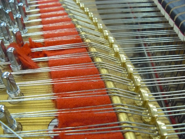

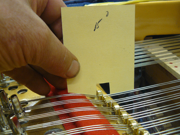

    Karl,  That piano was a really interesting project. I gave a chapter technical on it before it was sold. The fatal parts were:  Tuneability and the action. Secondary was floating and a short cut diaphraming to the bass end of the board.
    1- the major fatal mistake...it was absolutely untune-able. Strings did not move up or down...every single note was a struggle. Once you got a string to render somewhat, the amount it rendered was absolutely untrustworthy, and would usually drop significantly anyway in 15 minutes.  ​I can tune recalcitarnt pianos these days...but this one was unbelievably frustrating and sounded like s..t after fighting with it..
    The problem was in how the front segment, what I'm calling the "stabilizing" length of the wire, between agraffe/capo and pin, was set up. Purchasing must have bought 200 miles of brass quarter round, and said use everywheret. So tenor string termination angles were all 40+ degrees out of the agraffe,  before going over the brass counterbearing, changing angles again at a steep angle for the pin wire takeoff. As well, between brass and pin , it bore very heavily on a wide expanse of very dense felt. In the capo, again high termination angles and heavy bearing on the same felt.  Capo shape was not too bad. Also i suspected the wire quality itself  being somehow involved, but I can't prove that. Removing strings exhibited a flattening and actual bend, rather than a curve at the agraffe contact.
    Strings were discarded. Agraffes re-profiled so only 1mm contact was in the agraffe and the rest of the agraffe hole was widened to assure undisturbed wire next to the termination. All brass counterbearing removed. Removing the brass knocked the termination angle way down. In the tenor, 3/4 or so 1mm bushing cloth on thin maple, ending up with 15 deg termination angle.
    Capos, reprofiled to a V with a 0.5mm termination land. Brass counterbearing chucked, plate reground to create an upward slope for copolymer counterbearing to sit on. 12 deg termination angle.
    Tuning is normal now. Capos render a little too easily, so I will probably increase termination angle with copolymer counterbearings in some situations Restrung and scaled plain wire and new bass with paullelo.

    Terry,  My thinking on falseness is doing and interesting morph after a couple of eye opening experiences over the last couple of years. One was a Bechstein B rebuild. New bridge and nice tight grain maple top. Minor falseness had nothing to do with the cap or pinning. I have noticed on 88 agraffe instruments, that the treble seems to have an interesting quality to falseness. Pressing on the bridge pins in the way we normally do, to prove pin involvement not only does not quiet the falseness, but seems to double its speed. I have no idea why, but it does, and does it in every non-capo piano I've worked on or service.
    The Bechstein has a steel insert in the agraffe as well, so the wire travels a weird traverse through the agraffe, especially if the wire deflects laterally as it goes to the tuning pin. The falseness is slow, and not really in your face, but it is there. Coupling well reduces it but does not eliminate it. So its tuneable, as you just look for the best sounding tuning spot. The result is that the treble takes on a pleasant shimmer. Its the shimmer that I am liking.
    2 years ago I did a CA treatment to a Forester (communist era East German production), which always had had an attractive, but active treble. Thinking falseness was diminishing the potential of this pianos sound, and having the tenor up to beginning of the 4th octave, producing more and more of the annoying slow beats that develop down there, I CA'd the bridge. Initially it killed the treble. Went back and made sure the CA was not mucking with the bridge pin contact point, cleaned that up, but still, the treble lost its shimmer, and neither I or the customer liked it. Cleaning up the tenor was a success, as that falseness is just a pain, with no up-side.  Tuned it really well, and gave it a year, and the treble falseness returned enough to recover the nice shimmer. Client and I are very happy (and relieved). But there is no question, that the falseness gave a pleasant shimmer to the treble...not wild beating but movement which, interestingly, is different movement to my ear than an out of tune unison.  I think this difference between gentle falseness and out-of-tune unisons is the point here. I don't know why the falseness movement sounds different that poor unisons, but to my ear, and my client's it does.  The cap on these Foresters is odd. being soviet era, sourcing of really nice quarter grain stock may have been an issue, so they edge glued many very thin 2" wide boards like you would a key set or something like that, and then cut the cap out of that glued up panel. Its all failing at the glue lines, but you have to look close to see what's going on. This falseness responded to the screw driver test normally.
    The Chinese piano in my post's falseness, responds to the screw driver test positively. Falseness. is for the most part only enough to create a shimmer, which I really like. There are a few wild ones, and I will treat those individually next time I see the piano. I do not trust this cap, though, now that I know the wood is untrustworthy, and of unknown provenance, and will recap if I experiment with one of these Chinese pianos again. If the opportunity arises, I definitely will...but I have to get it for very short money to make the re-work billable.
    Terry, you may find the way I did an after-the-fact float, and dead simple diaphram to the bass of the Chinese piano, interesting. Board was very stiff.
    That and the scaling were a complete success. The low bass and tenor were gorgeous, and sold the piano very quickly.  Here is a marketing youtube I did to sell the instrument, which somehwere toward the end, maybe minute 6 or 7, illustrates the low end sound.

    Jim - you've done a wonderful job on that instrument and reducing the termination angle to 15 degrees will make all the difference. Just why do so many instruments have a termination angle of up to 40 degrees? It's really absurd and makes tuning hazardous and difficult. It's great to see what can be done with such instruments.
