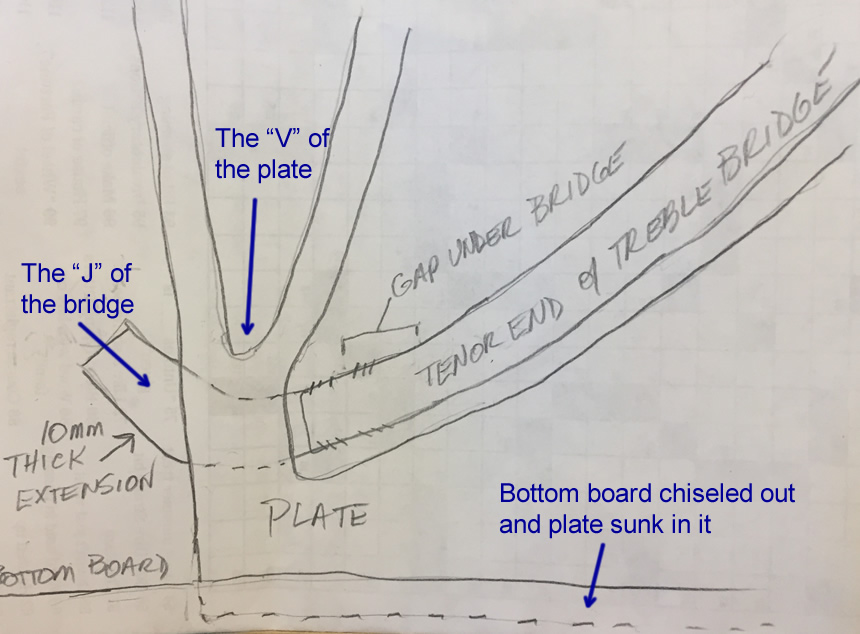

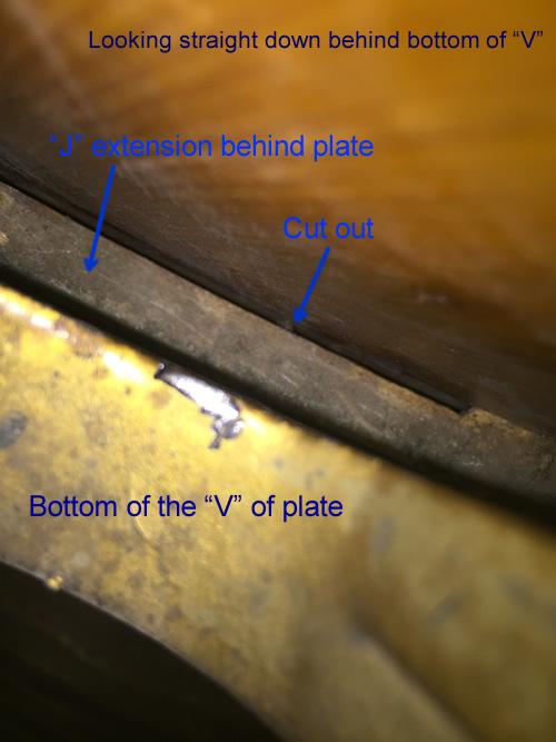

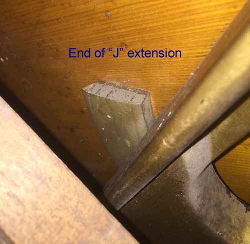

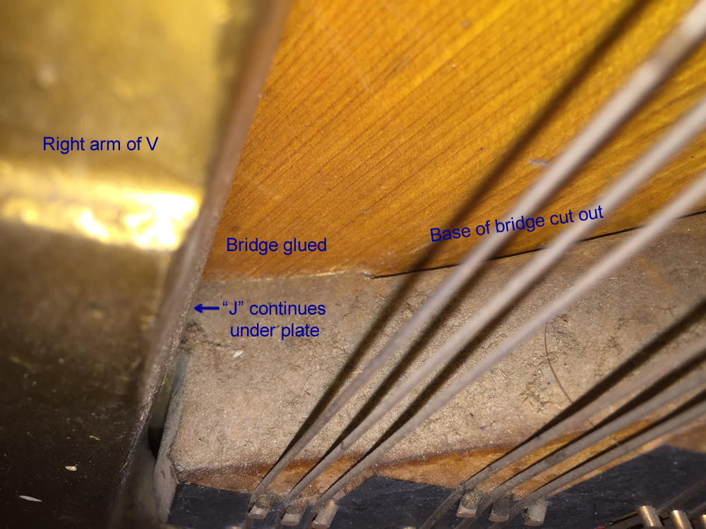

    Here is a photo of the part of the bridge I thought looked strange. I am 99.999% sure it has nothing to do with the buzz. But someone requested a photo. It's pretty blurry.
    Basically, the first few inches of the bridge (starting at the bottom/left end of it) are glued "normally" to the soundboard - the part of the bridge to the left of the first set of strings. Then there is a stretch of maybe 5" where just the edge of the bridge that would be against the soundboard is carved away a bit (behind the next few sets of strings), and then it's flush against the soundboard again.
    I know manufacturers were always experimenting, but I can't figure out what the point would be.

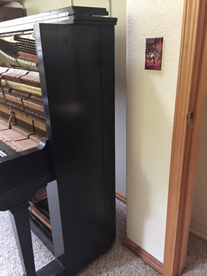

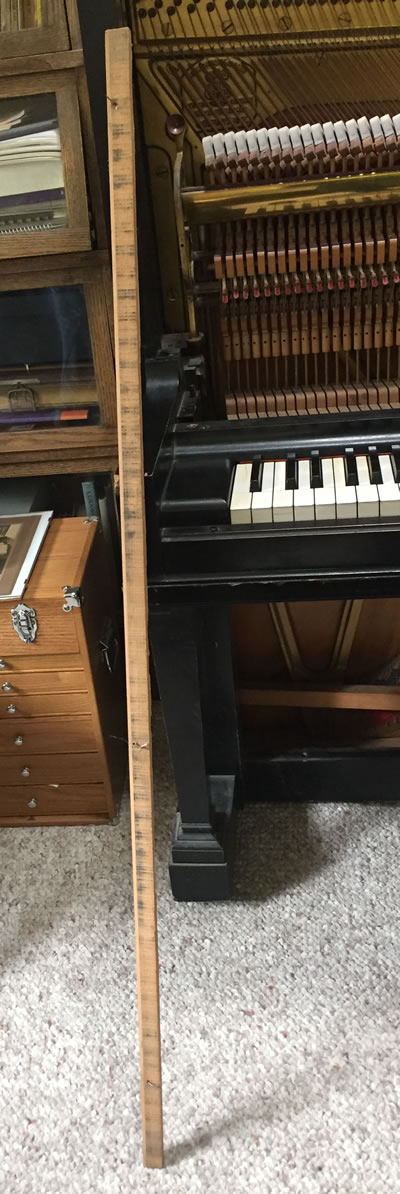

    I did go back to the piano yesterday. Spent a lot of time and got some excellent photos, but no solution.
    Just now I spent probably a couple of hours getting the photos I took ready and then typing a detailed post about what I found. But working without my usual two monitors and with stupid laptop keyboard and mouse pad, I managed to lose the whole post. And I need to get ready for a rehearsal.
    When I get home (to my real home) tomorrow I'll recreate it all. For now - no solution, but yes, the previous guy tilted the piano over twice while he was there. So stuff could have fallen behind the plate and be causing the buzz.
    I told my friend since I can't bring a tilter when I come back next month, we should get that guy and me to work on it together. I think that's the plan.
    To be continued ...
