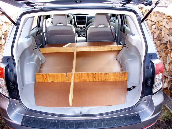

    Here's what I did on my Subaru Forester, 6 weeks after buying it in 2010. I ran a straight line down the middle of the back, and measured outwards perpendicularly from that line to at enough points to capture the curvature. That was my template for both sides, and it was quite close fitting. On the nearest end of the center board, you can make out a piece of steel angle on its but end, the horizontal part of which has enough of an off-set vertically to allow the masonite to slip between it and the center board. The masonite is locked in place by the bump-outs just beyond the rear wheel wells, and the dividers are locked into the masonite. The only trick on the dividers is figuring out how high they should be, but there are items I can't reduced the height of: a medium-size mechanic's tool box, and an extended version of a milk crate (I love'em!). When I'm picking up an action, they get slide over to one side, and the action has plenty of room to sit on the dividers.
    All you'd have to figure out is the dimension of the sections. Hope this helps. BTW, I had a single car accident for which I figured the chances of walking away from it (which I did) were 2%, add another 3% for wheel-chair-bound, and the rest GAME OVER.
