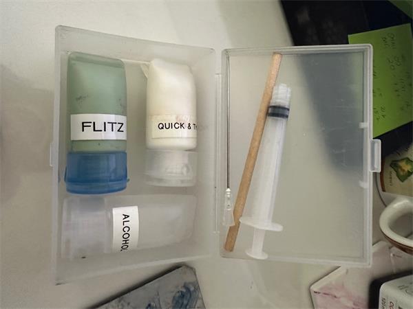

    I don't know if you have a Daiso in your area or if you go back to Japan once in awhile but I always find good containers there. I have a small rectangular case where I keep a small bottle of Quick & Thick glue, Protek and alcohol. Also, I keep a long nose syringe/pipette and a hammer shank. Photo shows a small bottle of metal polish instead of Protek.

  • 15.  RE: Glue Containers
    Posted 08-20-2026 19:17
    Daiso! 😂 Yes! I go back to Japan every year and my next trip is coming up soon, so I'll definitely check out a Daiso store while I'm there.
