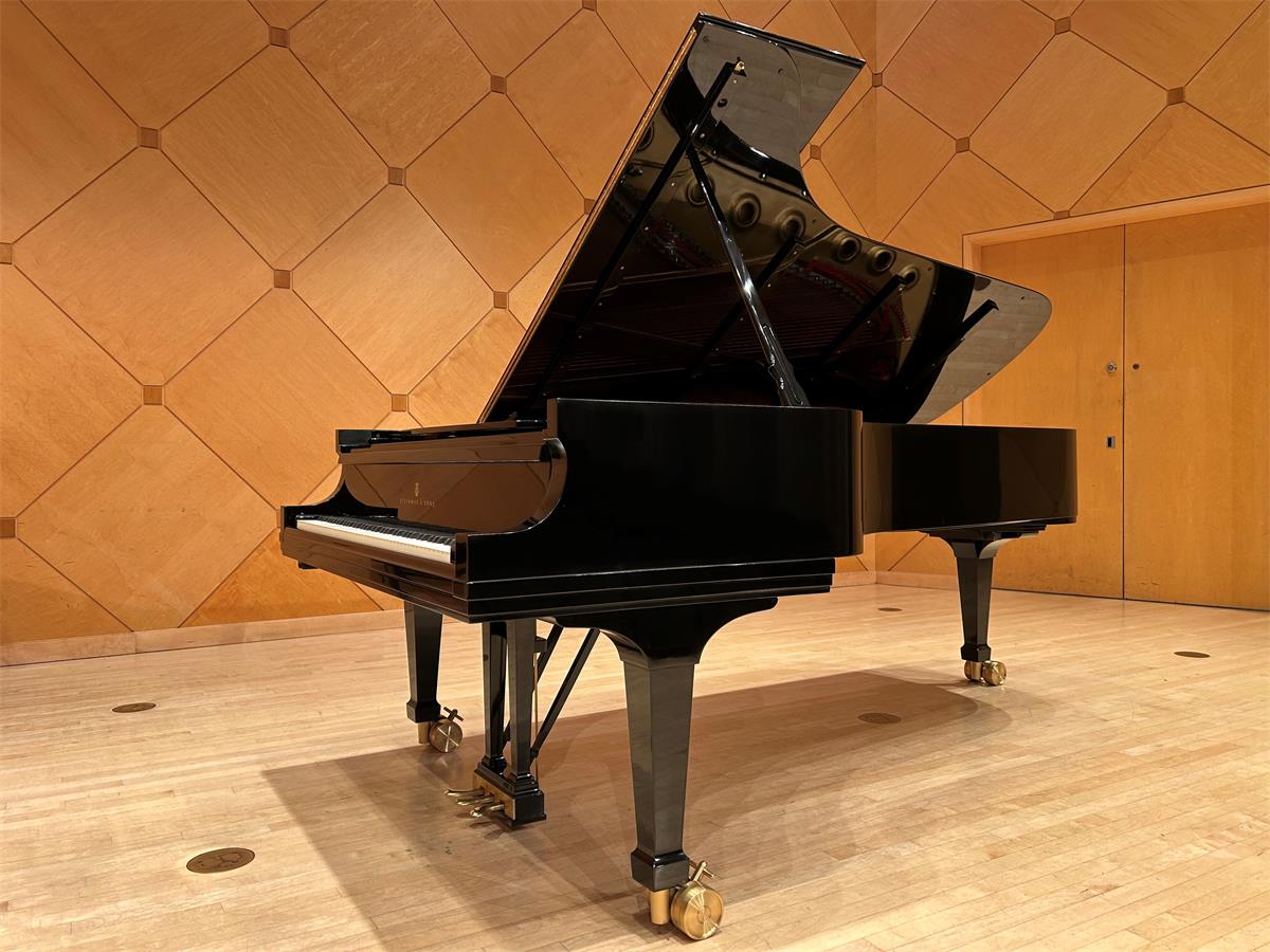

    Rick Florence RPT
    Gilbert AZ

    Hi Rick, if you mean you're cutting off part of the spade portion on an original NY leg (longer and thinner) what did that end up looking like? We figured having that much of the spade cut off could look odd proportionally, and the socket and the pressures it exerts will end up inside a thinner leg than the shorter, beefier legs meant to go with the big casters. Can you send any photos?

    Rick Florence RPT
    Gilbert AZ

    Thanks Rick! Beautiful photo.
