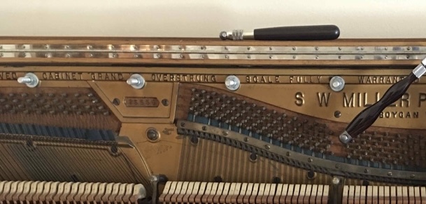

    5/16" bolts is what I've always used on these. Sometimes flathead, sometimes hex depending on what was used where. This assumes putting them through from the front. Sounds like you want to put them through from back, thus the carriage bolt style with the squared part under the head. Either way works.

    Please don't leave like this.
  • 4.  RE: Pinblock/Back separation repair
    Posted 15 days ago
    But Larry, the one in the middle gives you a great place to hang your rubber mutes till you need them.��

    3/8" might work too depending on what's already in there, that might be overkill, plus you'd need a long drill bit, plus grade 8 is somewhat overkill too.  Ive never had a 5/16" bolt fail under this or any other condition. Its not a boiler on a submarine... 😉

    I've done dozens of split pinblock repairs. Most were done with heat-treated threaded rod cut to length onsite with nuts on either end. That way they don't have to be overlong, and I didn't have to worry about having the right size, or the proximity to the nearest hardware store. All were done with standard wood glue.
    Spinets are problematic because there is often little to no space for a bolt above the tuning pins. A friend advised me, if you can't go for quality, go for quantity. On one, I chose to use a couple dozen wood screws aimed in between tuning pins. Held fine.

    Yes, and this is why I also use (where needed) a flat head bolt inserted from the front and a recessed nut from the rear. Excess bolt length gets cut off.
    Between the sandwich bolts and whatever adhesive one puts in there, it ain't comin apart anytime soon. Interesting how '50s Steinways seem to have this problem regularly (then again it simply reinforces the fact of the "design lifespan" of all of these products).
