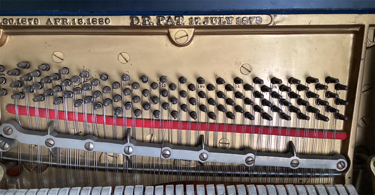

    Greetings All,
    Restringing a 1904 Steinway Model I upright with what appear to be original strings. The strings all measure half gauge smaller than the gauge sizes stamped on the plate. The first gauge stamp is 13, but the strings measure 12.5, etc. Is it correct for me to replicate the string sizes that are in the piano, not the gauge sizes printed on the plate? Finally, why the mismatch? Did they use metric gauge wire?

    It's possible it has been restrung, but the strings are corroded and brittle (started popping when I tried to bring it up to A440, even with lowering first to break corrosion). There are 5-6 windings on every tuning pin, and very uniform - like a factory job, which leads me to believe they're original.
    The first gauge stamp at the top of the soprano is 13, so I am assuming all the strings to the left of that should be 13 (they are measuring as 12.5), consistent all the way down to the bass break.

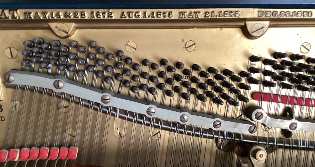

    Thank you for the information! There's one less row and a few differences between the scale you sent and the plate stamps, but otherwise pretty close:
    13 - 7 (instead of 6)
    16 - 8 (instead of 9)
    18 - 10 (instead of 11)
    As an aside, I really enjoyed your class at the convention!
    Plate Stamps 13-16
    Plate Stamps 16.5-18
    Thank you Steven for the suggestion, David and Blaine for the interesting ideas about stretching, and Trevor, Alan, and Horace for the measuring advice!
