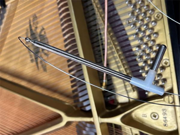

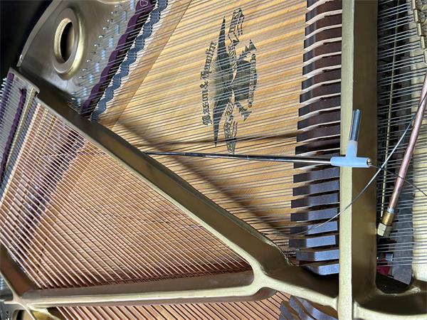

    It's pretty straightforward to replace a string in the overstrung area with the right tools and techniques. The first step is to measure an amount of wire longer than what you need and put a bend in approximately the middle for the hitchpin - or procure a replacement wound string.
    The first tool is a guide to maneuver the wire or the replacement bass string under the upper level of strings.
    • Schaff sells a tool called "The Stringer II" for this purpose - sectional construction and ready to go.

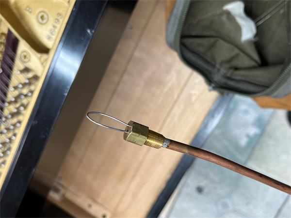

    • You can also make one out of brass tubing with a fitting soldered to the end and a cap with two holes for the plain wire loop. The cap is generally removed for bass strings. The copper can be gently formed to conform to the angles you need.
    • understring tool 1
    • A third option is the telescoping tool that you will find from some Asian suppliers - not useful for bass strings but easy to carry and fits in tight spaces.
    • telescoping1
    • telescoping 2

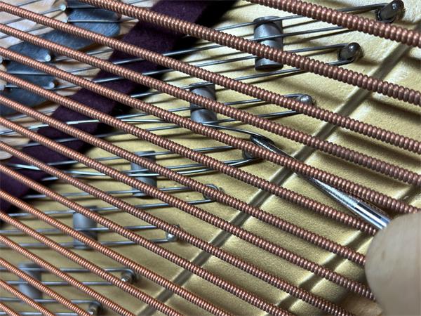

    • Slip the loop over the hitch pin and seat around far side of the hitchpin then secure with hemostats.
    • hitch 1
    • Use a standard stringing hook (for lifting) and a string leveling hook (for pushing) to thread around the bridge pins.
    • hooks 1

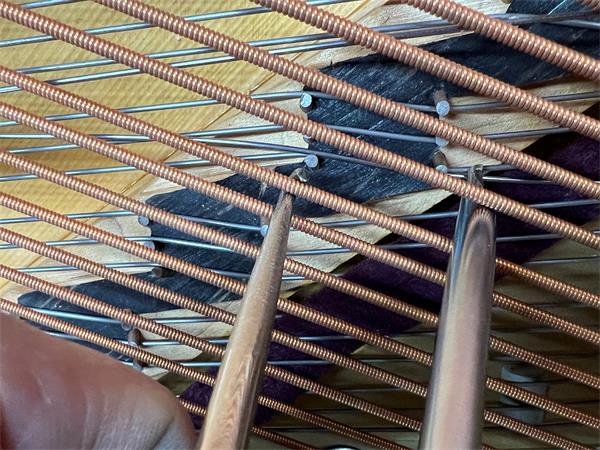

    My preference for this was two 24" lengths of 1/8" brass tubing, taped together parallel.
    Bend the string in half and feed into the tubes. Attach to hitchpins and bridge pins as others have mentioned.
    Slide the tubes up and off the string(s).
    Being Sure to maintain the left/right orientation of the strings.
    And that's the point of having double tubes.
    It's no fun to go through the repair and realize, as you start pulling to pitch, that the unison pair has crossed over itself.
