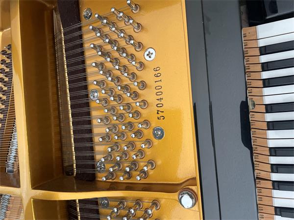

    Does anyone know anything about a Vienna brand piano? The client wants to figure out what year it was built, but that brand isn't showing up in the Online Piano Atlas. The serial number looks like a Pearl River, but Vienna isn't listed as a brand that PR owns. Any thoughts or ideas? It appears to be a newer piano, probably built sometime after the year 2000.
    Edit: I saw one online post that suggested the Vienna brand was built by Nordiska. However, Nordiska appears to have used letters in their serial numbers. I don’t believe this is one of their pianos.

    I tried to look it up, and one suggestion was Nordiska.  Years ago, I worked for a Nordiska dealer, but I don't remember mention of Vienna.  Bosendorfer and Kimball had a brief collaboration and they had a Vienna series made under the Kimball name.  This is not the same because I have a client that owns one.  Sorry I could not give you a definitive answer.  Check out the action frame for hints that might be printed on it.

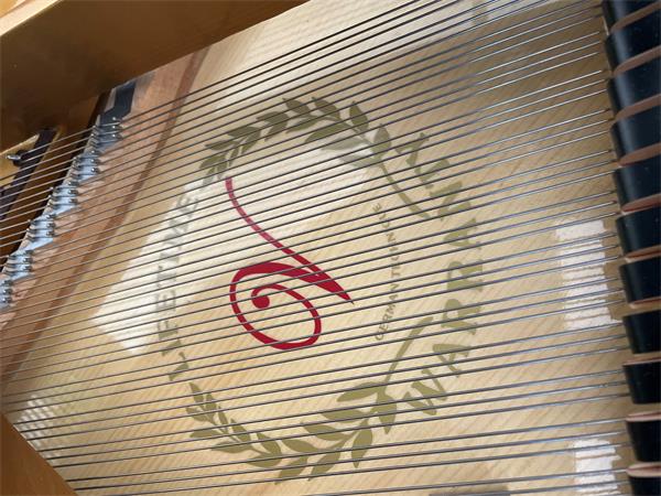

    Wow! 570 million made so far?  And a "lifetime" warranty!  Strong likelihood that Dongbei manufactured it...late 1990s to early 2000s. Now defunct.
    Edit: Possibly back in production now though.
