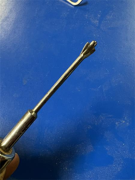

    There are two common friction problems in these actions. You've gotten some wonderful advice on the action center issue which is a potential problem. Before going in to treat, check the action vs the keys for sluggishness. If it's in the action centers, go ahead with repinning. If the keys are binding, take another tactic. You may have to address both.
    On these actions, the thickness of the wood at the bottom of the mortise can be too thick. There is a useful tool for "thicknessing" this point. Schaff 3156 - referred to as a Balance Pin Hole Reamer but this is a misnomer.
    counterbore
    Hold the key in your hand and insert the tool from the top. Place your fingertip over the opening in the bottom of the key so you can feel the top of the tool as i protrudes through the hole in the wood while turning the tool. Once this is done, you will probably need to use a CF tool to fit the balance rail hole to the pin and possibly the keybushings as well.
    I also lightly lubricate the keypins before reinstalling the keys.
    This area is especially susceptible to humidity changes.
    I hope this helps.

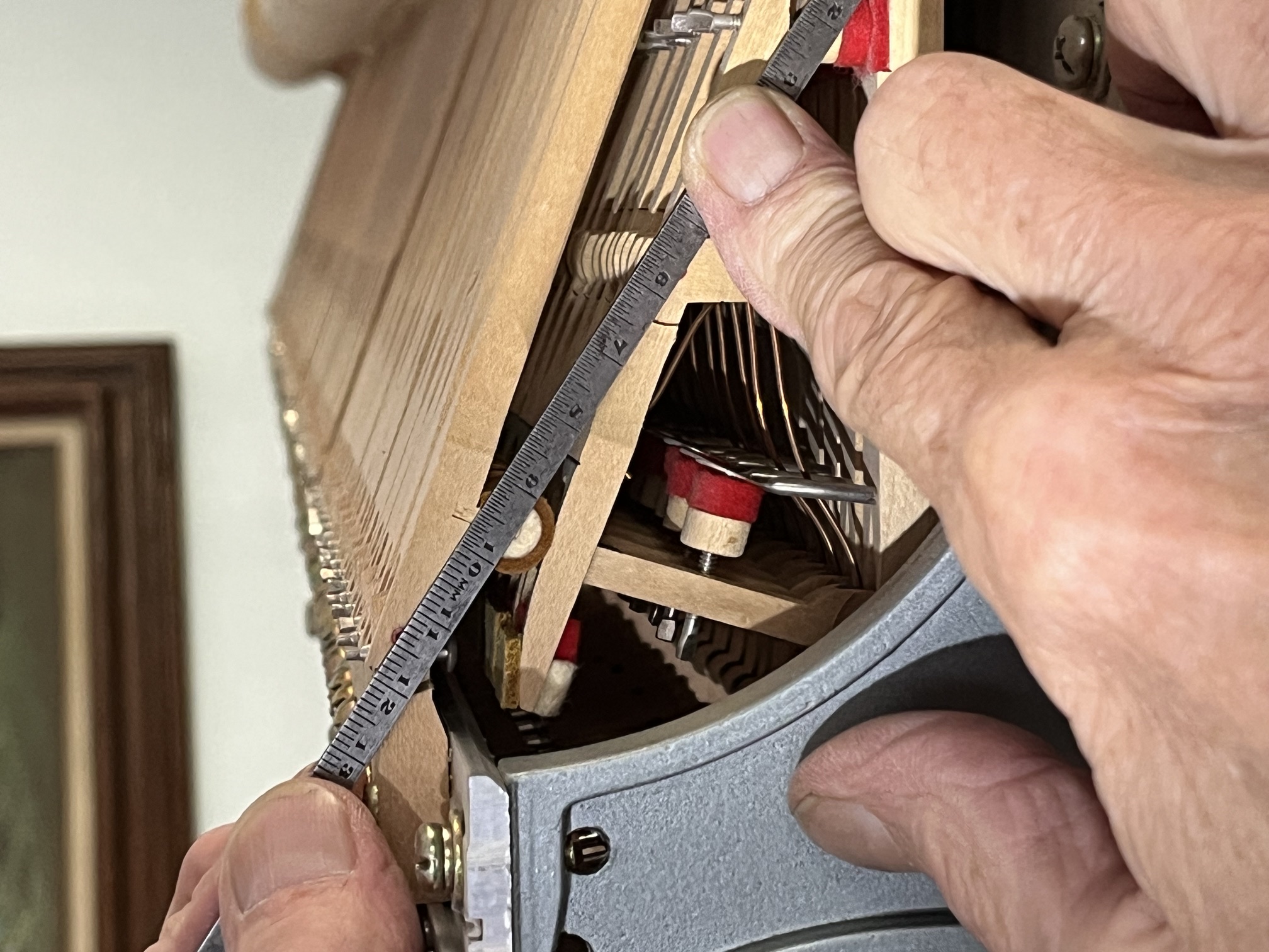

    I pulled a wippen and checked center pins. They were clean, bright and shiny, rounded ends. All the pinning looked good.
    Here is the action spread. It looks to be 114mm. Shouldn't it be 112.5?
  • 26.  RE: Young Chang Wurlitzer 1989
    Posted 10 days ago
    That's what the expanding brackets does. Replace them, and you can make the spread 112.5
