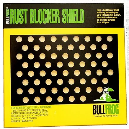

    Some people recommend a product called Bullfrog rust inhibitor. The type put in pianos comes in a 1/2"x12"x12" perforated cardboard box and emits a chemical that binds with metal to inhibit rust. The local piano dealer includes them with all his pianos. It was discovered here in the islands because the US Navy buys it in liquid spray form by the case. It can be found on amazon. People also use it in one form or another in shops, gun safes, etc. It won't solve your problem but might slow it down.
