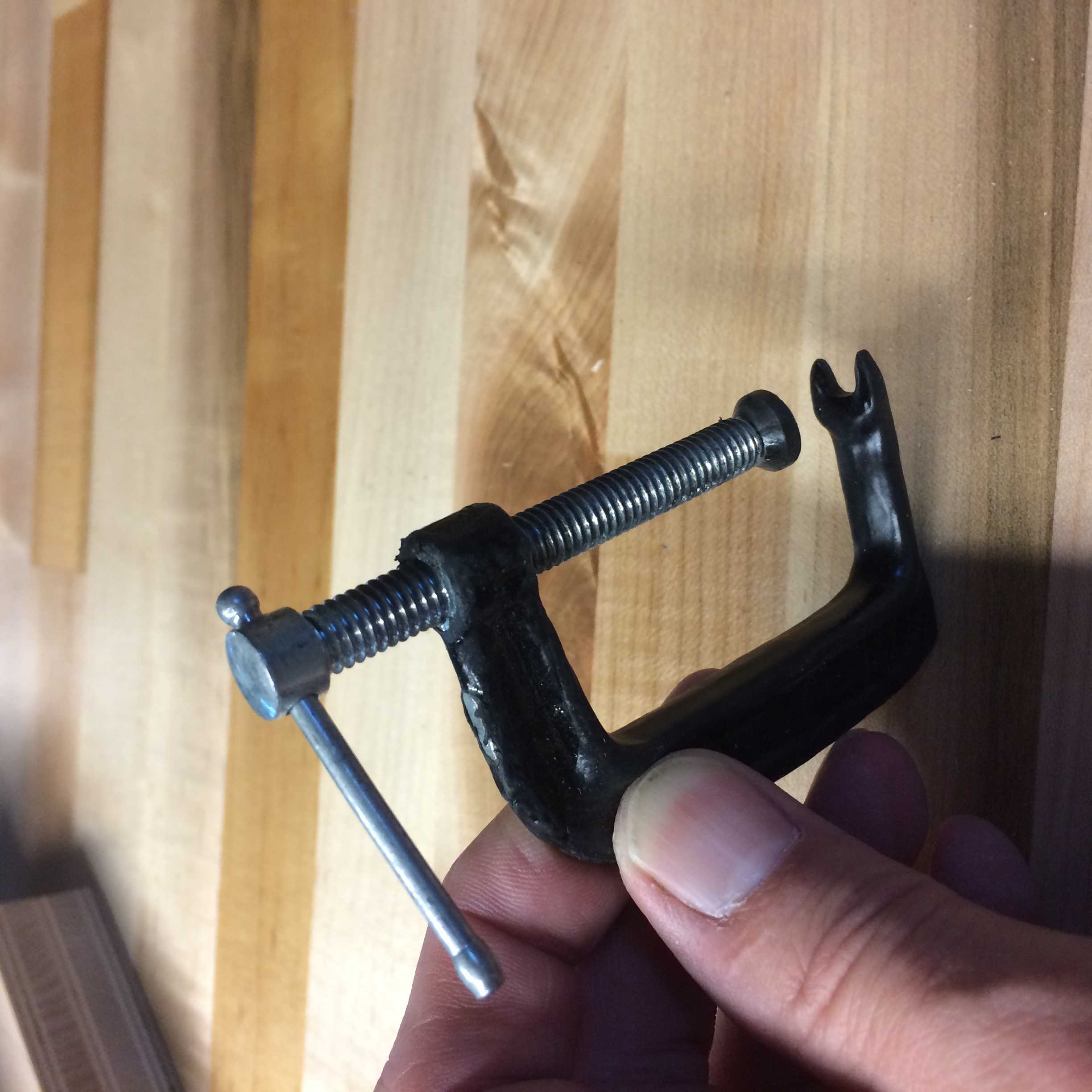

    Good morning Norman,
    Here's a little device that we made in the shop since we've restrung quite a few Baldwins with Accu-just pins. It's based on an old Baldwin Factory tool and is simply a 1" or 2" c clamp with the end of the frame ground thinner (to allow more clearance between the string and the surface of the plate) and a notch cut in the end to fit around the accu-just pin. Driving the string down on the pin is pretty easy but this makes lifting the string (to decrease downbearing) easier.
