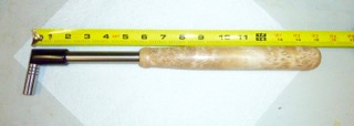

    Lots of great levers available.  I started with a Hale extension lever, then went to a Jahn extension lever, then went to the first Fujan (aluminum), then a Fujan carbon fiber. Right now I have the Fujan carbon fiber that I use for verticals, and a homemade lever that I prefer on grands. I also occasionally use a Levitan C hammer for some grands, but I much prefer the traditional levers.
    The Fujan is light and very stiff, and does great for my karate chop style for uprights. My homemade lever is heavy and stiff, but I like the length and feel of it when tuning grands (mostly smooth pull method). It has a 10º Jahn head and a stainless steel shaft with a pool cue ball epoxied onto one end.
