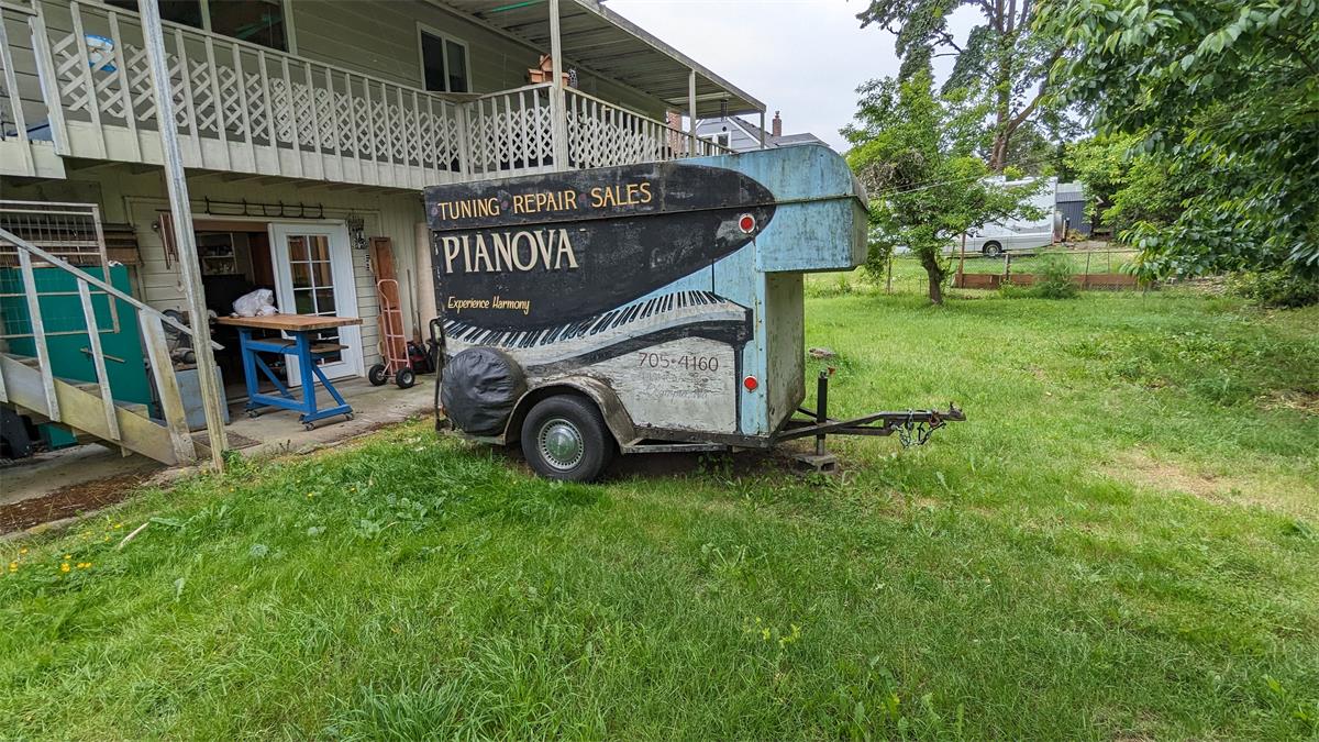

    Including a shot of the inside of my trailer. Extra foot tall, e-track installed at the factory for nominal cost. I have never regretted getting doors instead of a ramp. MUCH more versatile.
    The guy who taught me used a tall canopy on a pickup with wheel wells. Grands were positioned in the middle and cross-strapped to the front and both sides.

    I found this whole thread very useful and interesting! So I'm reviving it.
    After 20 years or so I'm finally retiring my old piano moving trailer. (tear rolls slowly down cheek)
    I think I'm the 4th owner - the original owner being former PTG president George Morgan who had it built in 1957 and was part of his very successful piano rental operation. I've been a little nostalgic about it because it has served me well.
    Originally owned by Seattle piano technician and former PTG President, George Morgan
    I'll probably still hang on to it for hauling stuff to the dump, but the time has come for a new trailer set-up.
    Here's what I have gleaned from this thread so far:
    1. You want a trailer with extra height so that grand and large uprights can stay on the dolly for easy loading. David Stocker recommended getting a foot higher than standard.
    2. You want 'barn doors' instead of a ramp because it is way more versitile
    3. You want to have Etrack installed. Jon Page suggested 3 rails per side: 12", 32", and 48" for versatility and cross strapping
    4. Lower deck height helps: Jon Page's trailer was 'easy load' with a bed height of 16"
    5. Flat front is better than the V shape which can interfere with raising the hatchback on a vehicle.
    Here's some questions that have come up from researching trailers:
    1. Aluminum is lighter than steel, doesn't rust, but is more expensive.
    2. A vent is important for letting heat out in hot weather
    3. Putting an epoxy coating on the floor can make it tougher and more waterproof
    4. Good to have lights inside
    By the way, for those going to Reno: I highly recommend David Stocker's piano moving class that is being offered this year. I've learned a lot from Dave over the years, and of course we both learned a lot from Puget Sound charter member John Grace, one of the few completely blind piano movers who ever lived. RIP.
    I've decided I'm going to have the trailer built for me, so any other things I should be thinking about since this thread started in 2015?
    Ryan Sowers RPT
    (360) 480-5648
