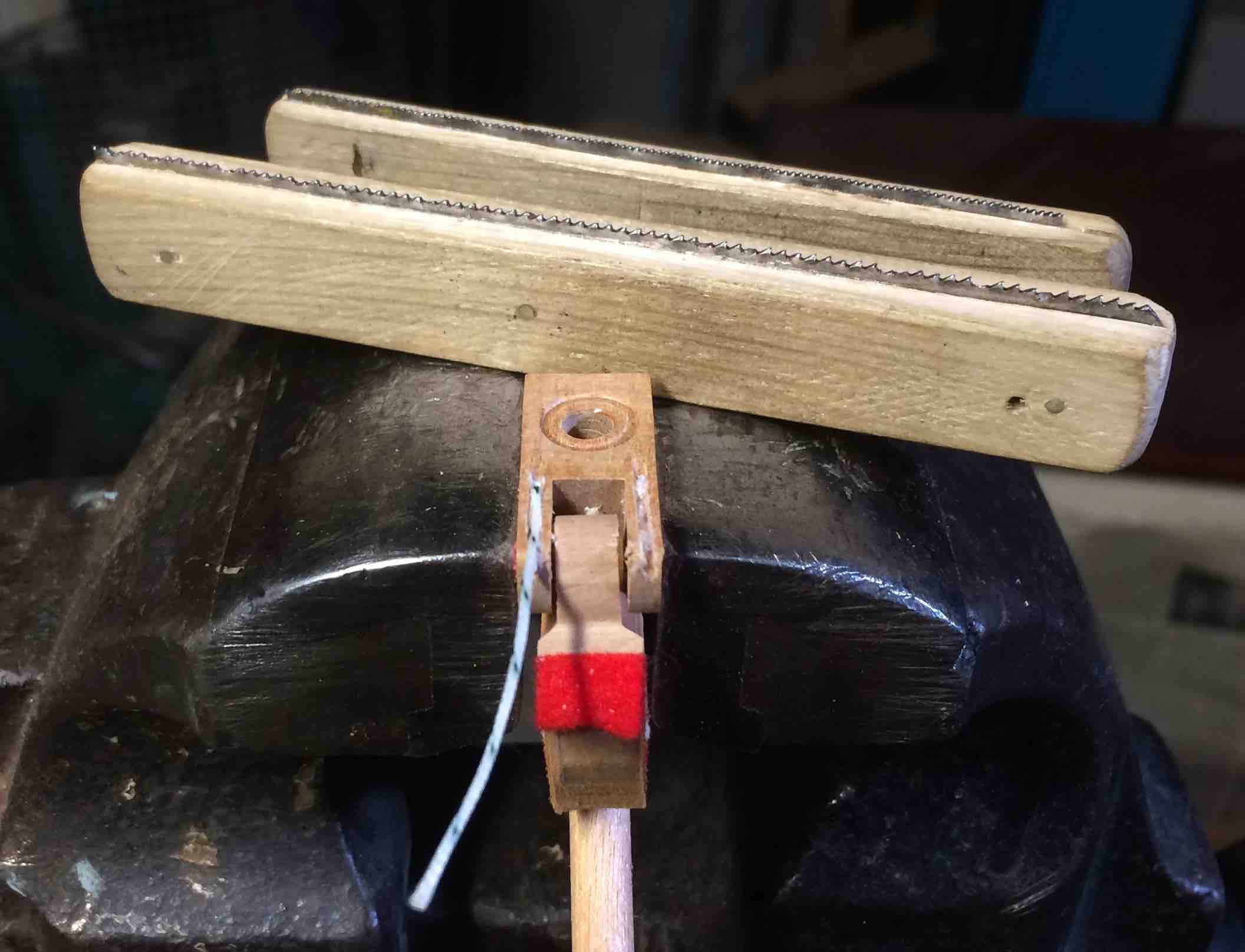

    I'm about to do two. Attached is my procedure. Attached is a photo of the tools I use.
    The tool on the far left has the pin for the drill to wrap the cord around. I use fishing line.

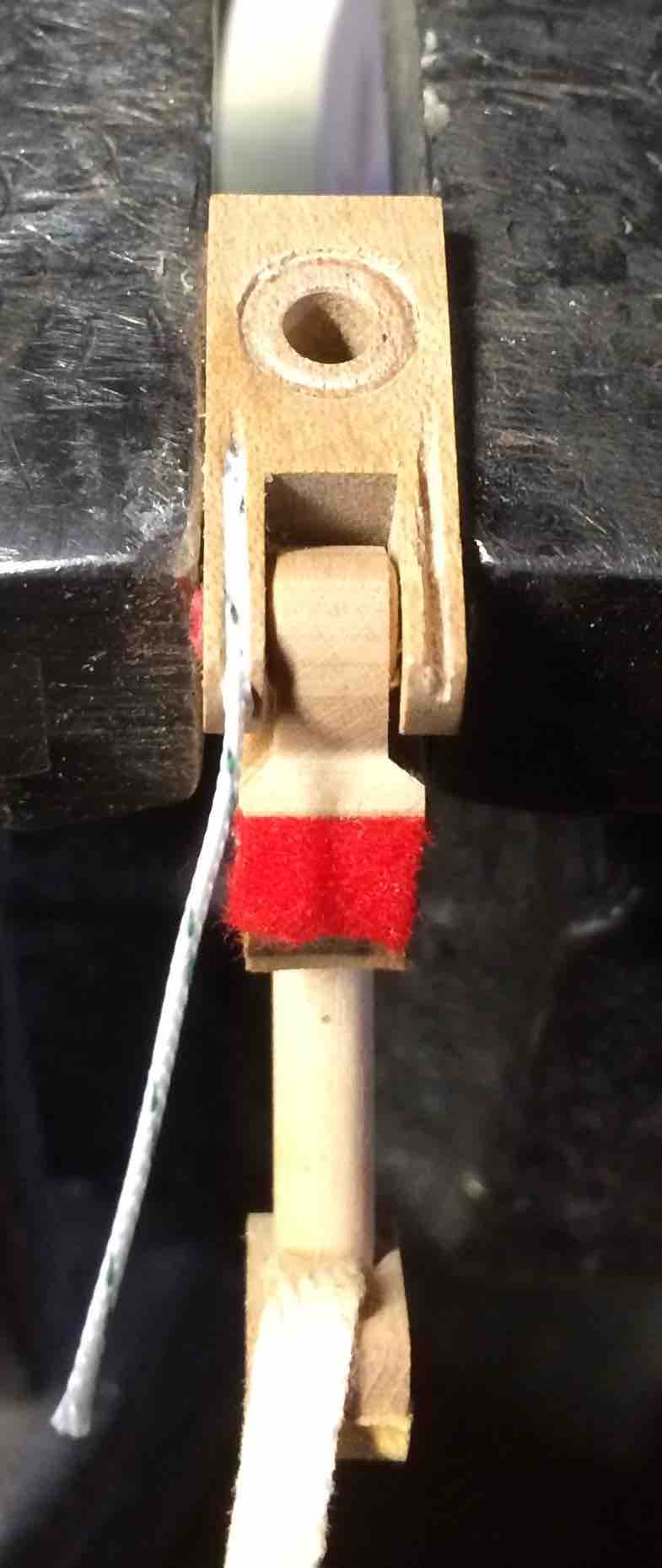

    When there is not a butt plate, I hold the flange in a vise and clean out the slots.
    To glue the second side, the hammer is rotated in the opposite direction on the flange.

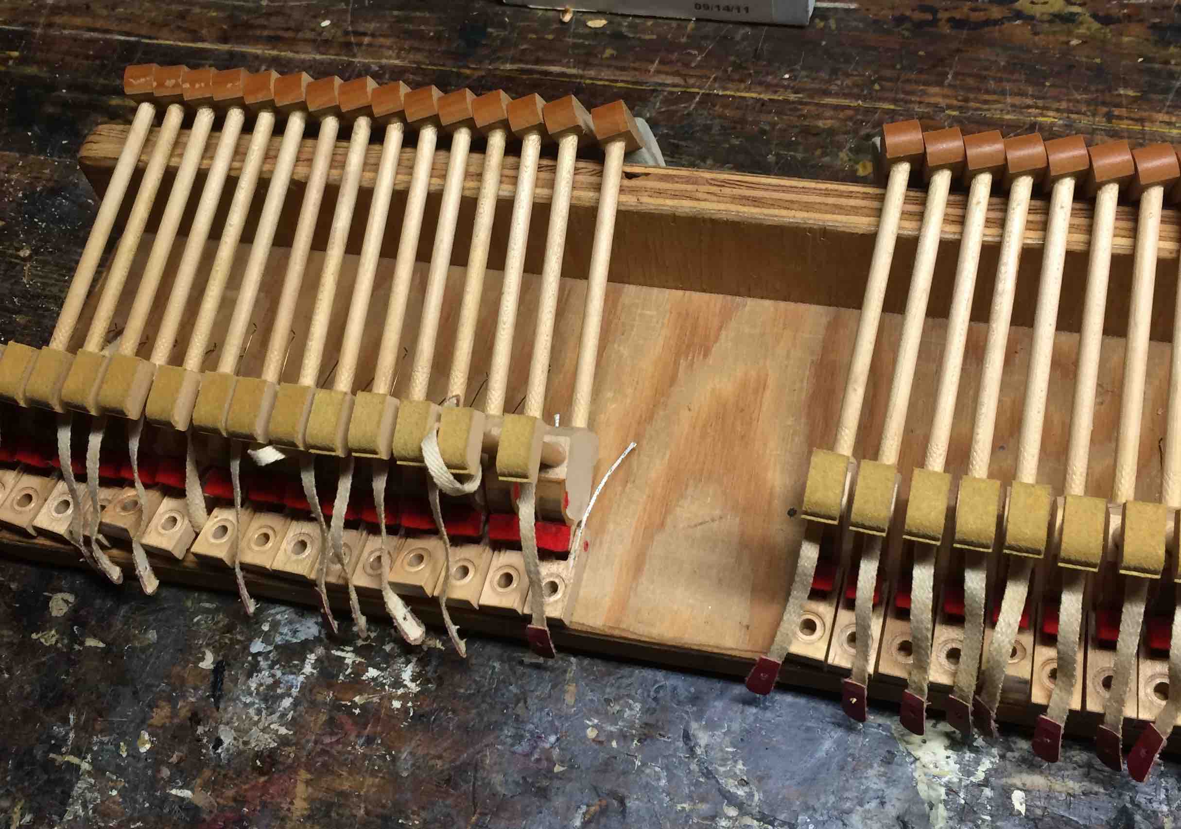

    You can replace the cords on the standard butt version without removing the assemblies from the rail.
    Proceed as usual, removing dampers and rails, unhooking tapes to drop the wippens out of the way, clean out the old cord from the slots and cut new cord to length.
    Glue the cords to one side of their flanges.
    Support the action a little tilted back, let the hammers drop to the back side of the rail and support the hammers such that when the cord is pulled around and glued into its second slot, the hammers don't pull against the cord.
    Put a tiny drop of glue in the slot. (Use a small point or toothpick.) I use yellow wood glue.
    Use tweezers or a small hemostat to pull the cord in place and press it in the slot with a tiny flat blade screwdriver.
    The flange geometry gives you an index for the cord ends.
    The top section is easiest, so start there and work out your details of sequence.
    The tiny bit of glue dries quickly.
