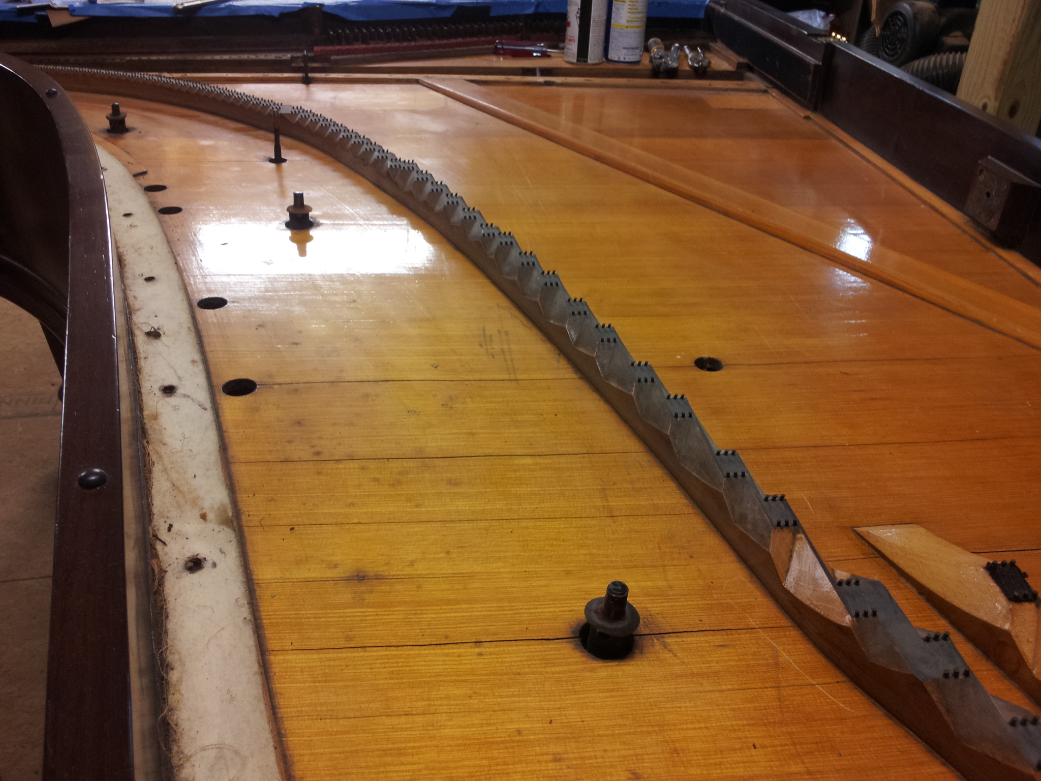

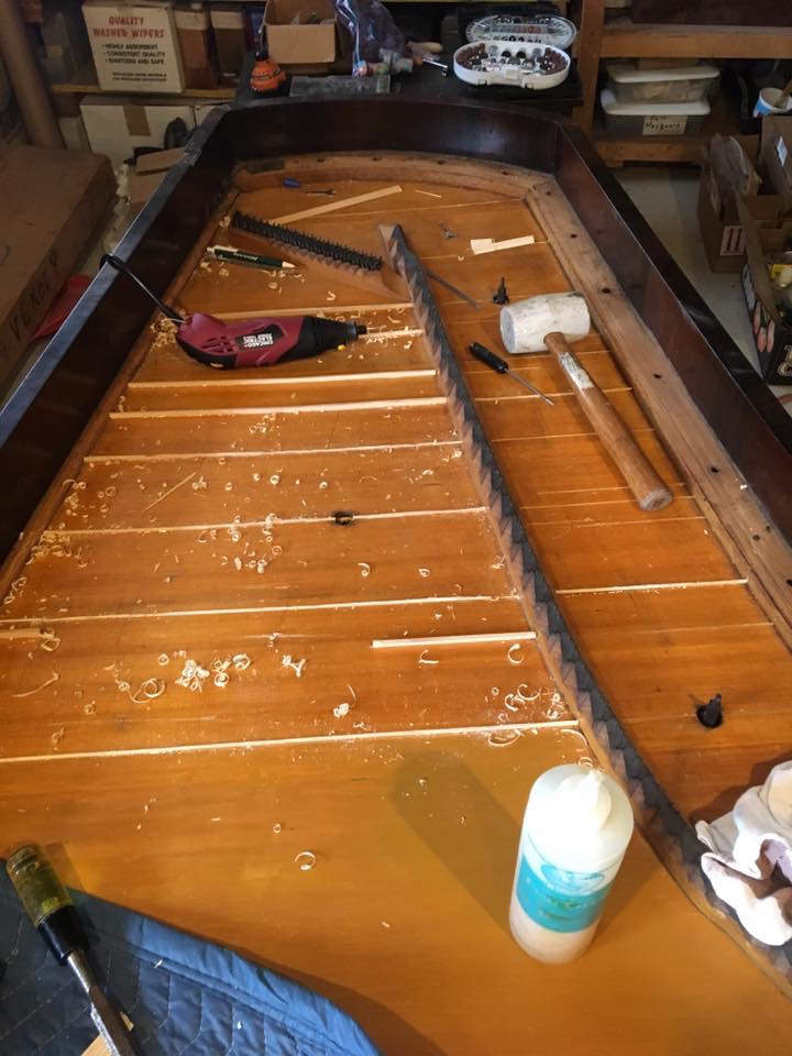

I am restoring an 1884 Broadwood and Sons 8'4" Grand. The soundboard is slats of wood pressed side by side. I don't have experience to know if back in the day they were glued together. Fast forward to today you can see light between the boards. This is not cracks but just space between each board that comprises the sound board. Should I leave it as is or should I force glue into the seams to make it more like 1 continuous piece?
Michael
