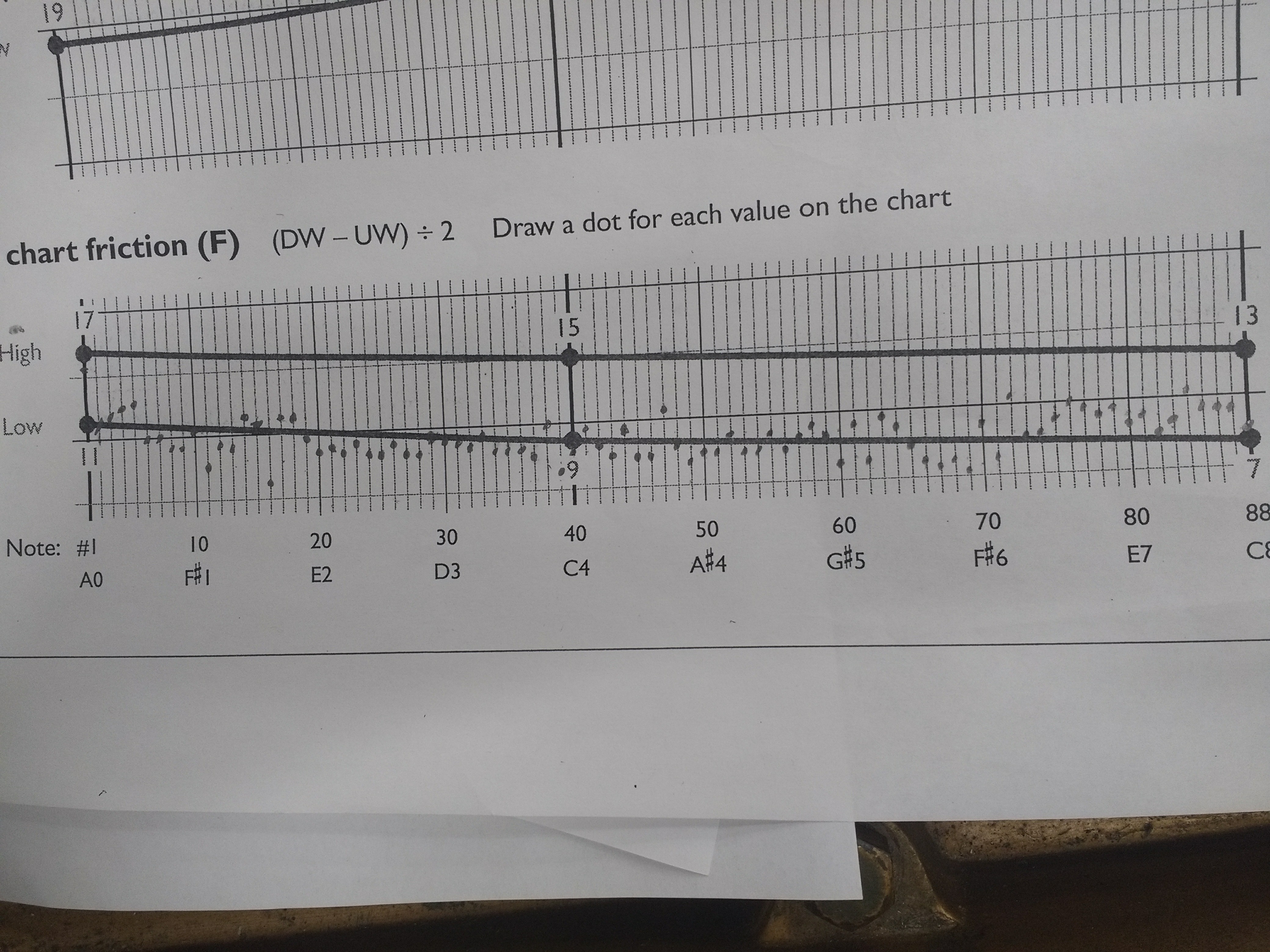

In your action the data is somewhat varied, probably owning to a somewhat inconsistent strikeweight curve, but generally it is on the high side. That means that there is a relatively high FW required to achieve a mostly "highish" balance weight. It suggests that the relationship is not optimal. I generally like to see the FW around 85% of maximum with a BW between 36 and 42g. My personal target is 38 grams BW. If I have a higher BW then I'd prefer a somewhat lower FW. Below is a table of FW maximums as outlined by David Stanwood. While this is not a number written in stone it can be used to help determine if that relationship is poor. BTW the FW can be too light as well which would indicate that there is not enough inertia, the action may feel "fly way" or the pianist will not be able to feel the mass of the hammer well enough to be able to adequately control the throw.

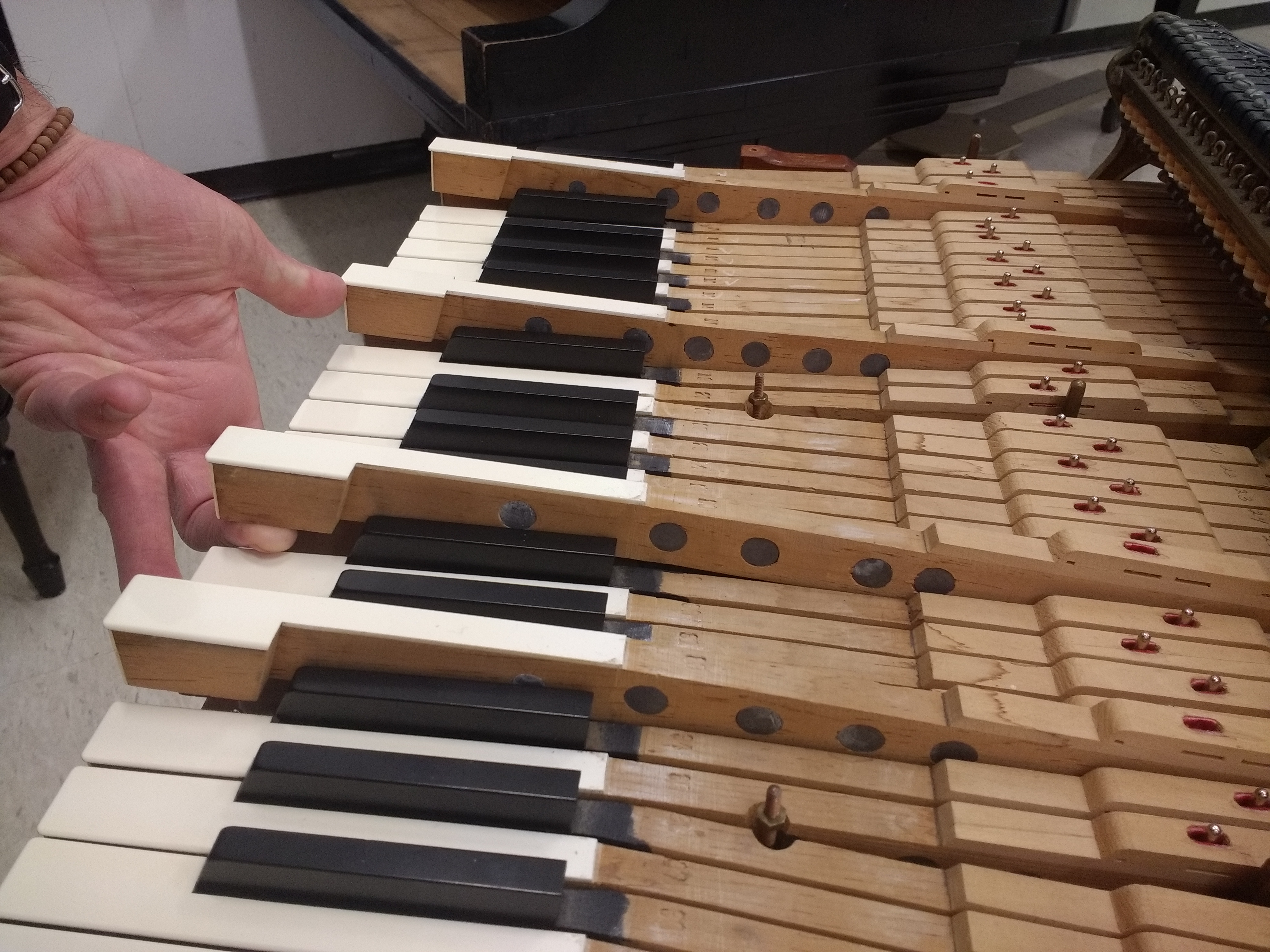

It also tells you that the amount of lead is not so important without knowing the location. While there are quite a few leads in these keys, that they are located closer to the fulcrum shows you how many leads can be used without exceeding maximums if they are located closer to the balance rail.
Curiously, you reported that the complaint was that the action felt too light. That I only attribute to an issue of personal taste with the pianist. I would not call the action "light" and the inertia would be, relatively speaking, on the higher side. But in these numbers there are some notes that are light, 34 BW at F#22 for example. I think what is apparent is that the action is quite uneven, if these numbers are an indication. There's certainly nothing inherently wrong with a 90% or even 100% FW max number but it does indicate higher levels of inertia. That may or may not be desirable.

It's hard to know if the lead is excessive without knowing the front weight. Since the leads are located mostly toward the balance rail then it's possible to have this many leads and not exceed front weights that would indicate high levels of inertia. Recall that inertia is mostly based on the relationship between the action ratio and the hammer mass. The FW along with the BW gives a good indication of that relationship. To get a better sense, having the FW data along with the BW on some sample notes would allow one to perform a simple analysis.

If you want to do the least amount of work, reducing the FW (removing lead) to attain approximately 40g BW. With a scale remove the lead that will give that BW. Since you have the BW already, create a new spreadsheet for the Hypothetical BW. The formula would be Desired BW minus Current BW. The result will be the deviation needed to achieve the desired BW. The extremes are higher than 40 and would require the addition of lead but since they are rarely played, they can be left alone. A move of 2 to 3 grams is negligible unless one of the inboard leads are that amount
Have you graduated the SW. If the extreme hammers are too heavy, that would cause the elevated SW.
