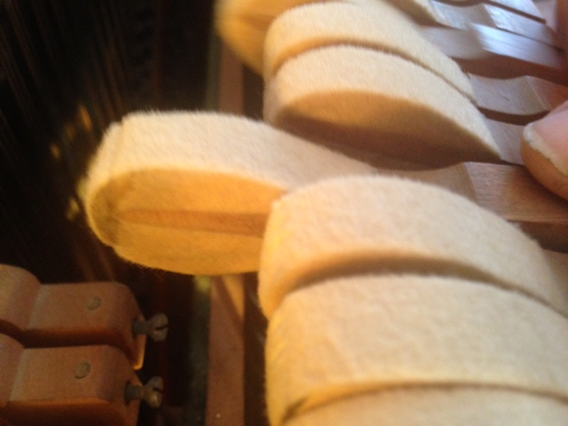

    I'm not recommending this solution, but I did see this creative approach in an old piano I tuned recently:
    Felt glued to striking surface of flattened hammer
