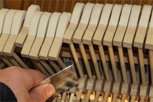

    I came up with a way to burn upright shanks and do the final alignment in a way that I really like...not messing with uprights to this degree usually.
    This is for a Renner upright frame...I don't know how it would work with other upright frames. The key is to remove the hammer rest rail, which on this frame is just 3 easy to remove screws. This gives ready access to the relevant parts.
    I wanted to use a square to read the hammer head's relationship to the string plane, but being an upright, the hammers you are not working on are in the way. I also wanted to use a heat gun to burn the shanks, with the same curved heat director I use with grand shanks, but said hammers were also in the way for this step. The trick was, with the hammer rest rail off, pull the jacks out from under the butts on the hammers you are not working on, and there is adequate room for a square against the strings.
    the low tenor hammers have their jacks pulled out from under the butts. A small aluminum shield hooks on the shank you are not burning to shield it from the heat.

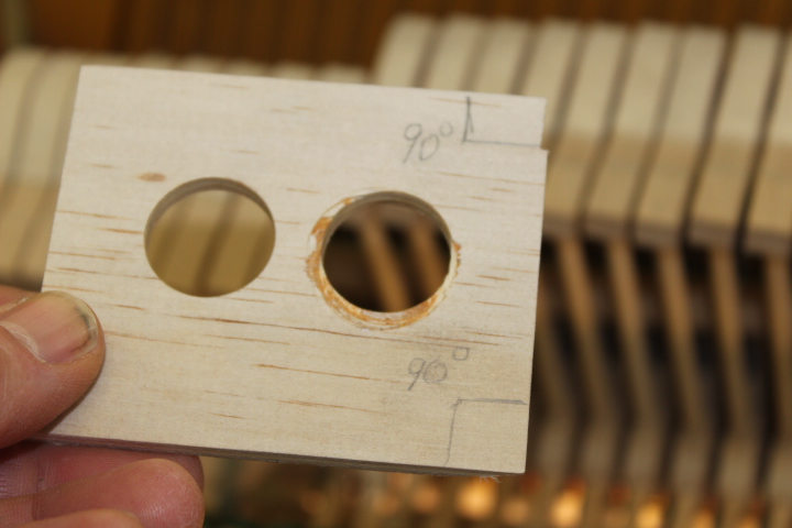

    The square...the two holes make it easy to hold in place against the strings to gauge square. One holds the square indexed off the string plane, perpendicular to the angle of the hammer molding, and reads to the molding, which on uprights has not been tapered
    Then mess with the flange screw to align hammer laterally to the strings. Proof is in the pudding, spacing was excellent, and after filing hammers, its sounds real nice, without messing much with the hammers or string mating.

    Jim, admirable. I would like to add that there are smaller, more aimable heat guns, (about 600º I think). I worry about the unintended areas that hot air is blowing.

    However, the curved deflector that slips onto the nose of many heat guns, I think for heating shrink wrap, really does a decent job of deflecting the hot air so it circles the shank, and exits vertically, up or down, not back. One would have to experiment or, use the tools Ed suggests or Fred suggests in his articles. Me, flames give me the willies. I use cheap aluminum shields as I show above for all kinds of protection in this work and other work. They are available in any lumber yard as "step flashing", can be cut easily with a utility knife, and bend ultra-easily.

    I have a Portasol torch, that has a deflector. It works well, though I find I almost always use an alcohol lamp, for uprights as well as grands. Faster than an electric heat gun, simpler than the Portasol to operate.
    That's what they used at the Sauter factory (alcohol lamp). When I saw them doing it, I was initially skeptical, but I found that if you have a smooth, reasonably fast motion, there is no issue with catching felt on fire or whatever I was worried about. Just keep the flame moving. (Do avoid checks with ecsaine instead of leather, as it will melt or catch fire pretty easily).
