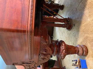

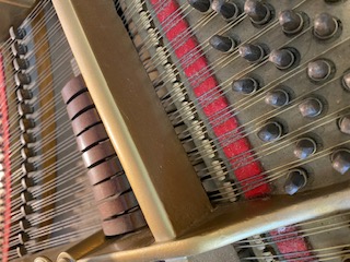

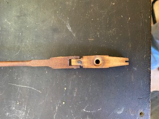

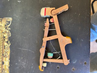

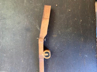

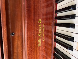

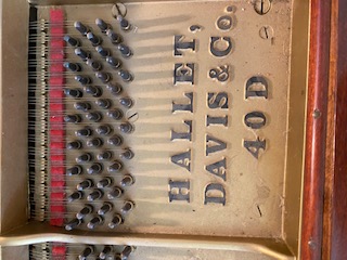

    Anybody have any insight into this piano?
    The owner thought this is 1852 but it has an overstrung scale. I'm thinking 1882
    I can't match up the wippen. the schwander style action has the wippen and jack pin on the same line but has a separate rest cushion.
    How would you make a rest cushion?
    I'm hoping one of the replacement jacks from Schaff will work. Then I only need 2 new wippens
    The agraffes on the bridge is different than I've seen. The damper upstop rail is on the front where a sostenuto would be.
    I'm guessing hammer and flanges were replaced

    Do you have a serial number ? Is the jack toe broken off and not repairable ? I needed a whippen for a Knabe and got one that worked from Brooks LTD.
    Agraffes on the bridge ? seems unusual . Not sure what you mean by a rest cushion since on a grand it should be a rebound cushion so hammer shank hits it ut should be off of it at rest, You may just have to swap out the whip from note 1 and 88 . I think I have seen hammer flanges like this on an old Connover

    No serial number that can be found.
    Yes of course rebound cushion.
    Most of the whips from schaff need a rebound rail.
    I'll check Brooks.
  • 4.  RE: Hallet and Davis 40 D
    Posted 05-31-2021 00:06
    Pianotek has several whippens with the rebound cushion - Steinway Style, Mason & Hamlin, Yamaha but I think Brooks is also worth trying

    It's not a square. It's a 6 and a half foot grand.
    Overstrung scale and a flat plate raised an inch by a wood rim piece. The plate is NOT bubbled,
    Sorry I thought I took an over all pic.
    When did they STOP using the agraffes on the bridge?

    Thank you Steve.
    I will look for the number between the bass and tenor.
