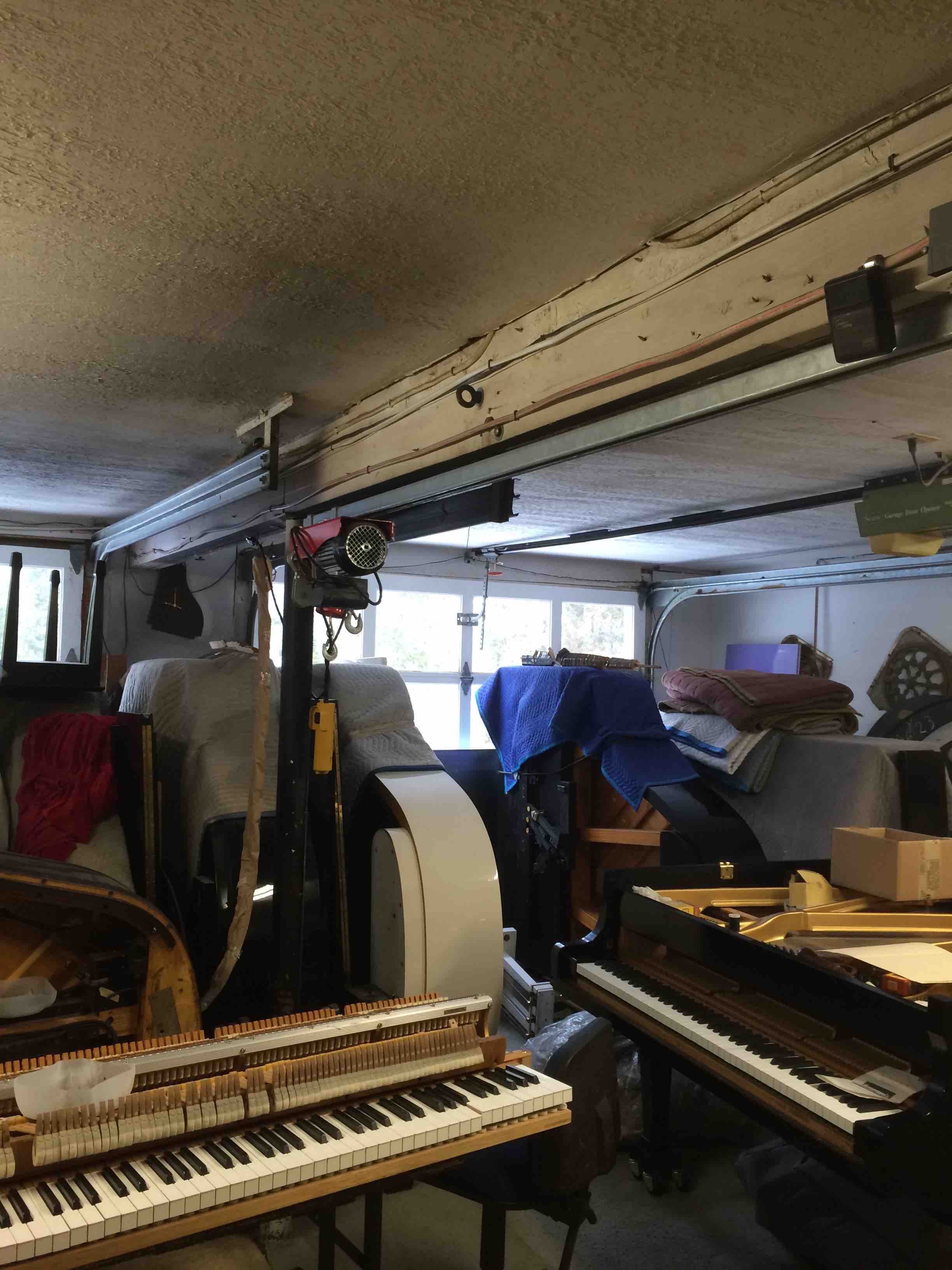

    Similar to Ron's setup, I have a half ton hoist on a track. My shop is in my cellar and it is attacked to the main central beam. There are two pullies so there are three cables lifting. The eyescrew in the beam supports one of the cables via a hook end.

    Another advantage to a hoist is being able to use it to set up a piano by yourself. I set up and took down an SD10 with it, also an Ampico player. Also for flipping the plate to bang out the hitch pins for vertical hitch pin installation. The cable ran to a pulley to drop down to the plate. You need more space to use a lift because of the area the lift itself takes up.

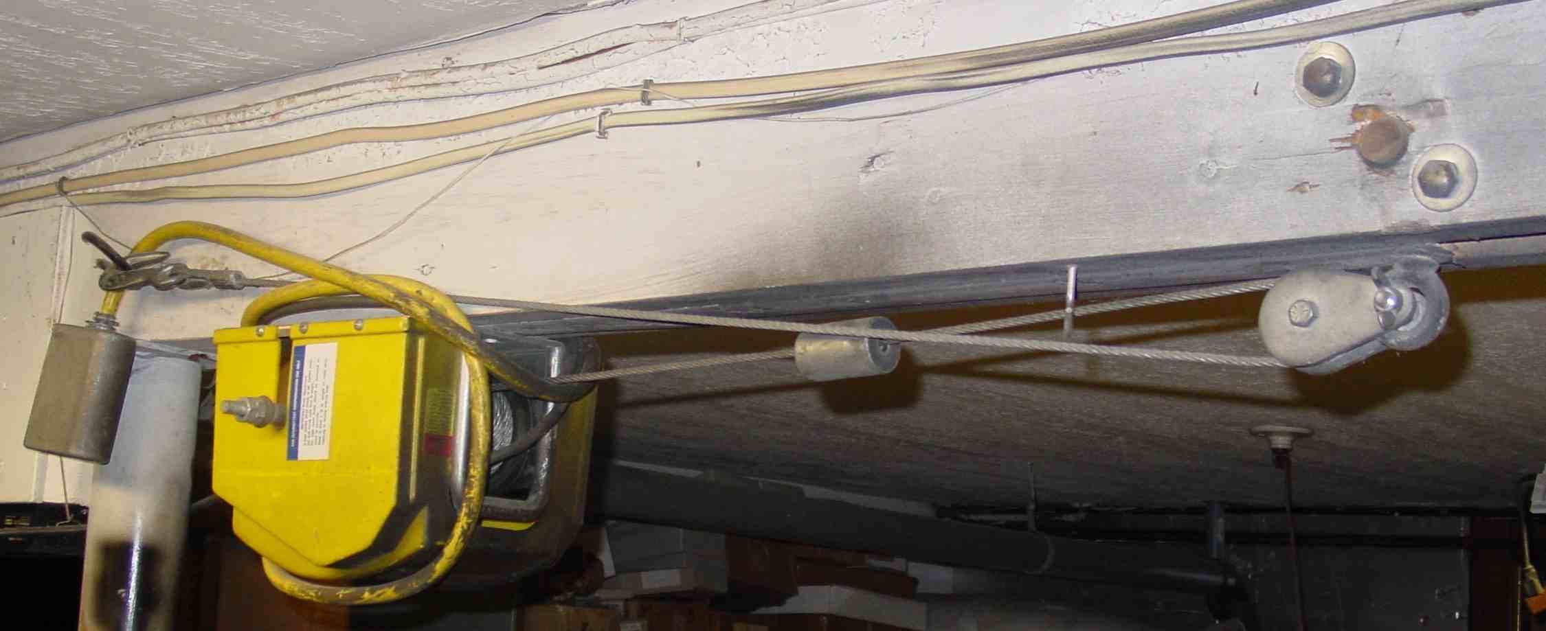

    My first hoist was not on a track but fixed to the beam. You can see salvaged opposing upright plate bolts reinforcing the beam on both sides. The eyescrew that once supported this first hoist's pulley is now installed on the other side of the beam to support the third cable. This hoist was initially used in a second floor shop to hoist pianos up thru a cut out in the flooring. This shop location is much better.
