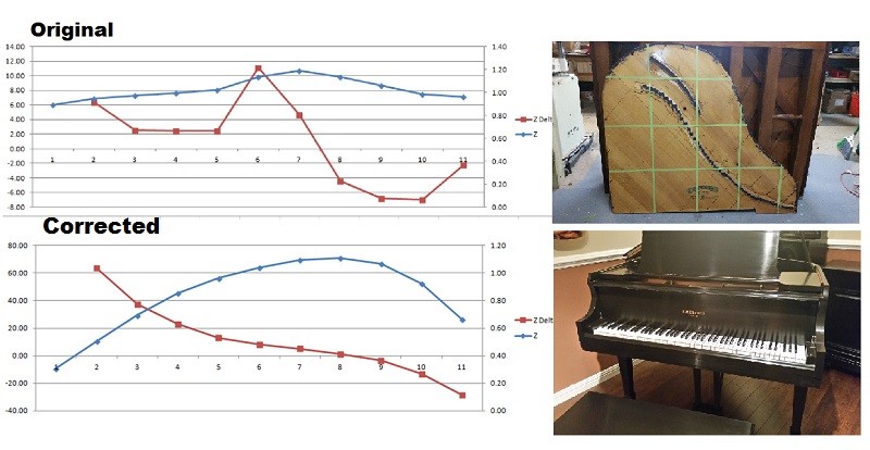

    I recently rebuilt a 5'4" Heintzman Grand piano. It was built in 1929. It had the worst soundboard and rib scale i ever saw. 29 probably not a good year eh!
    The Z Delta parameter of the rib scale was atrocious and ill conceived. Below is a graph of the Z delta before and after. The design of the heintzman was sound, but the craftsmanship was lacking.
    I could only imagine it getting worse if it is carbon copied in asia.
    Oh well.
    #caveman
