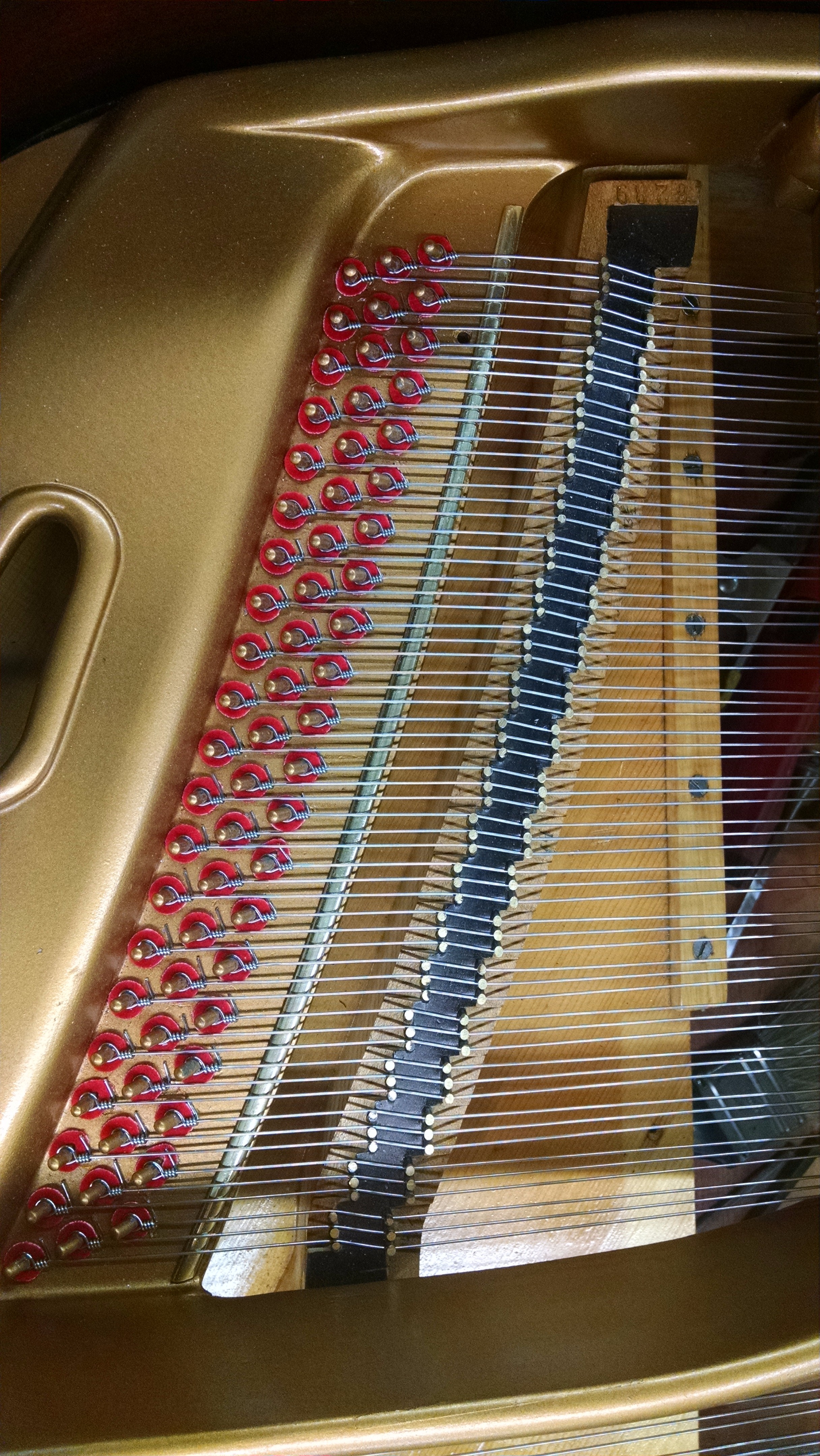

    Hi Tech String Looper (for Bosendorfer stringing in this case).  Wanted a new method after several different mounts over the years.  This proved very effective and kept my knuckles from dragging on the bench vise.  Not pictured, the small Visegrips used to grab the wire with my right hand and the wire spool (1/3 lb with brake) holding the wire taught with my left hand.  YMMV.

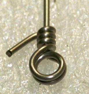

    Here's a German loop.

    Ron Overs makes a more elegant German Loop.
  • 8.  RE: Wire looping jig
    Posted 08-13-2017 23:14
    The double german loop may be more elegant but not necessary or practical for this. The double loop has the benefit of not cinching up against the hitch pin and can be nice if you want to remove the string, for some reason. They also raise the wire so if bearing is an issue then it will reduce it slightly. For the plain wire section of this and most pianos the double loop is unnecessary work and provides no benefit. For bass strings it does have the benefit of keeping the backscale more flexible when compared to more conventional bass string loops.  That can help pianos with short backscales.
    There are other jigs available as pictured in other posts. I have tried them all including the Nossaman jig.  Those jigs are fine for a single string replacement on site but I would not want to be handling a little dowel tool for some 200 strings. For on site single string replacements I simply use a round nose pliers and a small visegrips. For an entire piano I find this method easier, faster and produces a more consistent result with consistent loop size out of the jig requiring less tapping to cinch the loop. Less tapping leaves the tails in a more consistent position.
