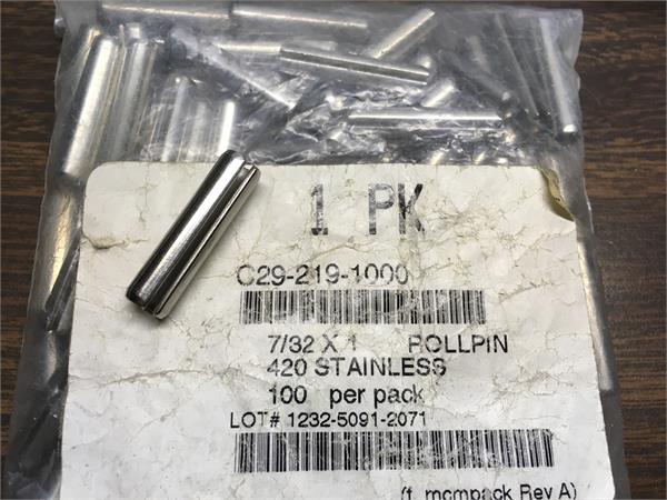

    Shane L. asked:  "Can you tell a little more about your method or replacing hitch pins during remanufacturing?"
    Sure. Original hitch pins are removed with cold chisel - whack! Anything left above grade is ground down with grinder. Holes, grind marks, etc. filled with epoxy fairing filler and sanded smooth. I use 3/16", 7/32" and 1/4" by 1" long stainless steel roll pins from McMaster-Carr. Roll pin manufacturers publish specifications for recommended hole diameters.
    Typically I try to drill the plate for the new pins aft of the originals. Also, drilling for new pins allows one to straight out and better space the non-speaking portion of the strings.
    Here are a couple pictures......

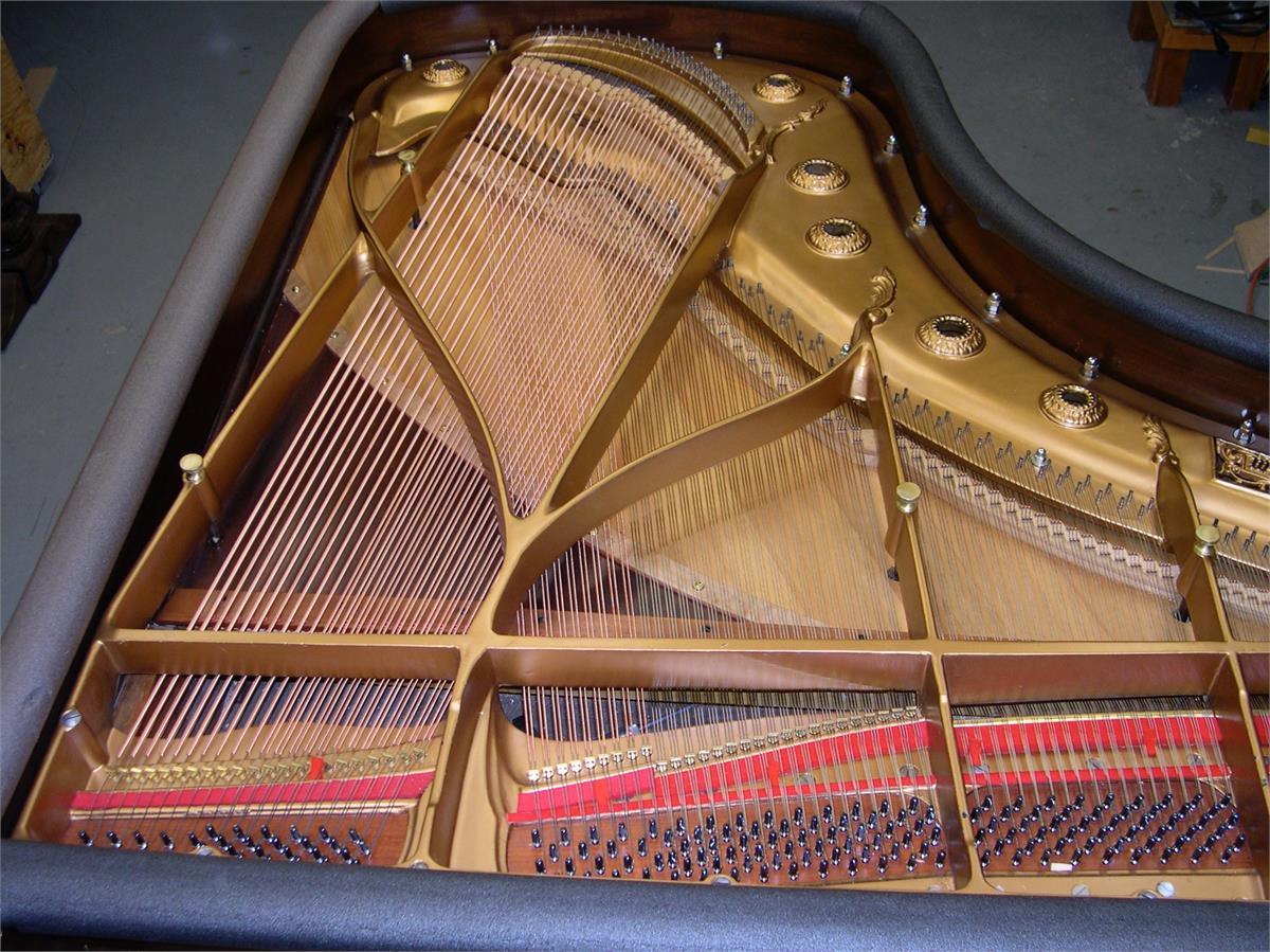

    Picture below shows two sizes of roll pins. I select pin diameter based on which size will keep the strings most parallel to one another. If I recall correctly, the picture below shows a pin installed underneath the strut that I drilled from the back side of the plate. I really don't recall, but I may have installed the pin from the back side also.
    Glamor shot below.....
