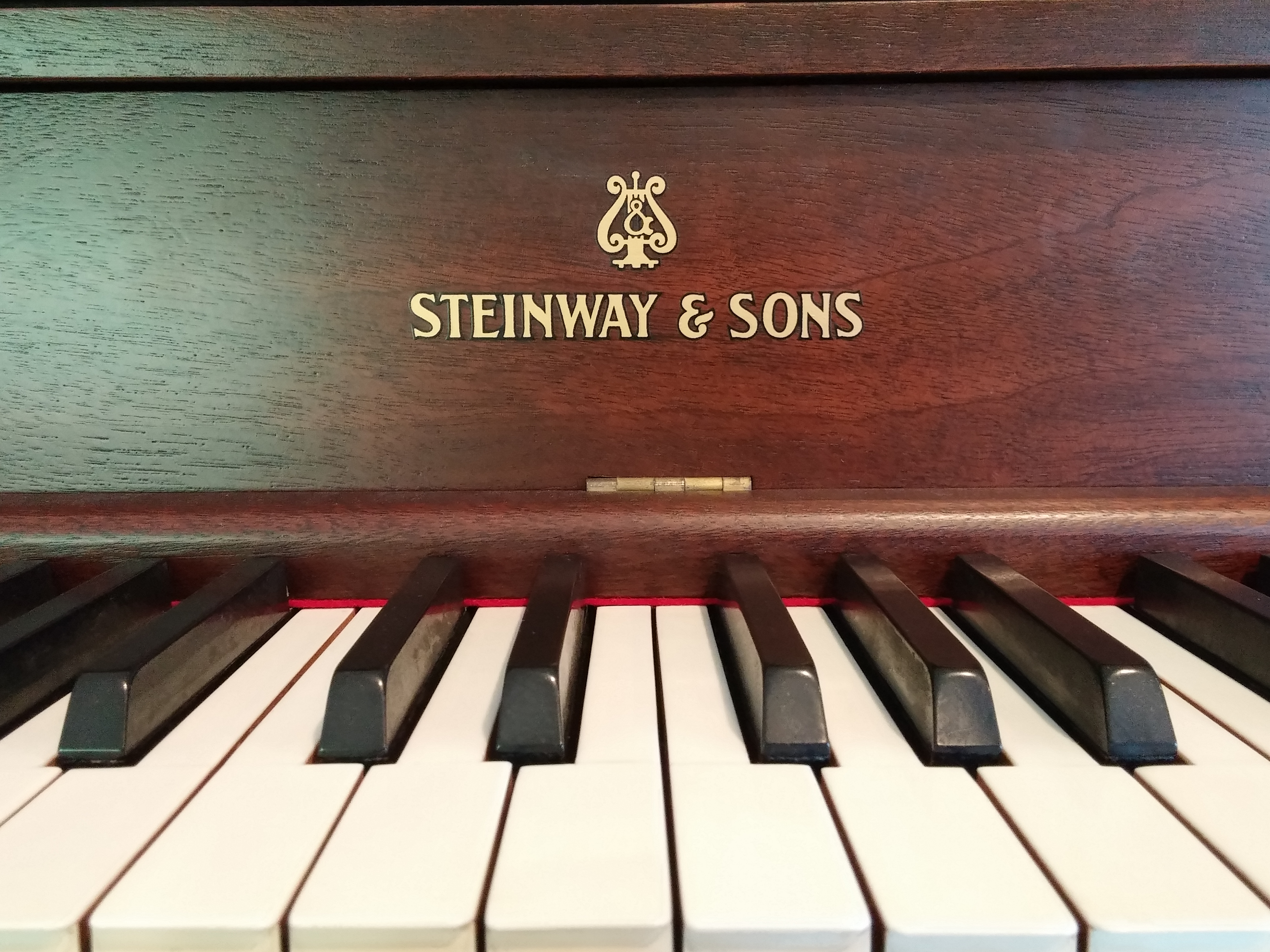

    Had the opportunity to service this beautiful Steinway upright this morning. Purchased new in 1949 by grandma, inherited by mom and now in the home of eldest daughter. Canadian. Mom, who still lives in Canada, had it restored last year by a guy in Guelph, Ontario. A+ job. Now homed in Los Angeles. Today's question: What model is it?
    Yes I have more pics if desired.
    1949 Steinway upright

    <grin> It's a Steinway Model P. I tuned one today, made in 1953. It had a brass medallion celebrating Steinway's 100th anniversary. It is in excellent condition, since it was not heavily used and it seems to have come to the west coast while it was quite new.

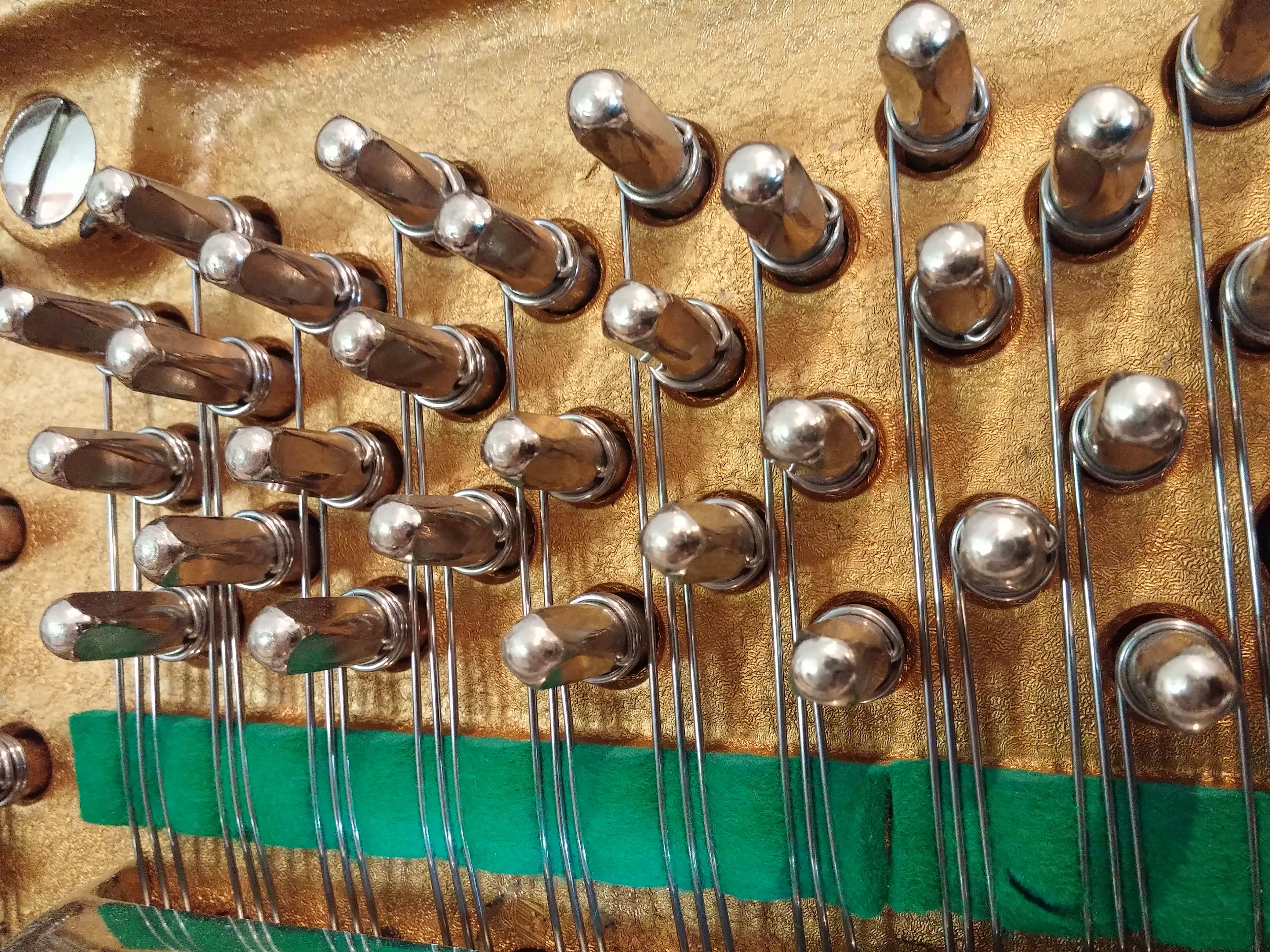

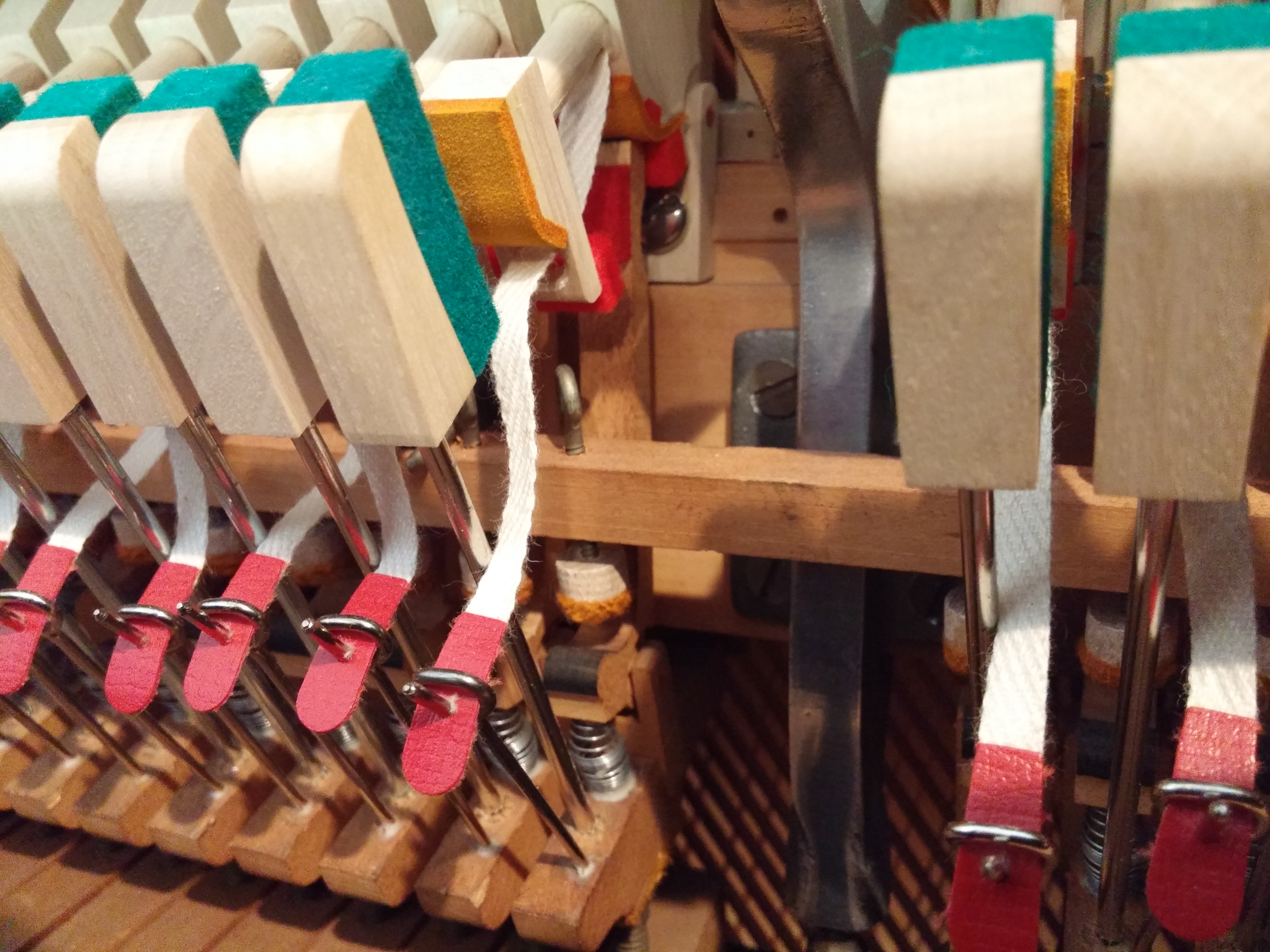

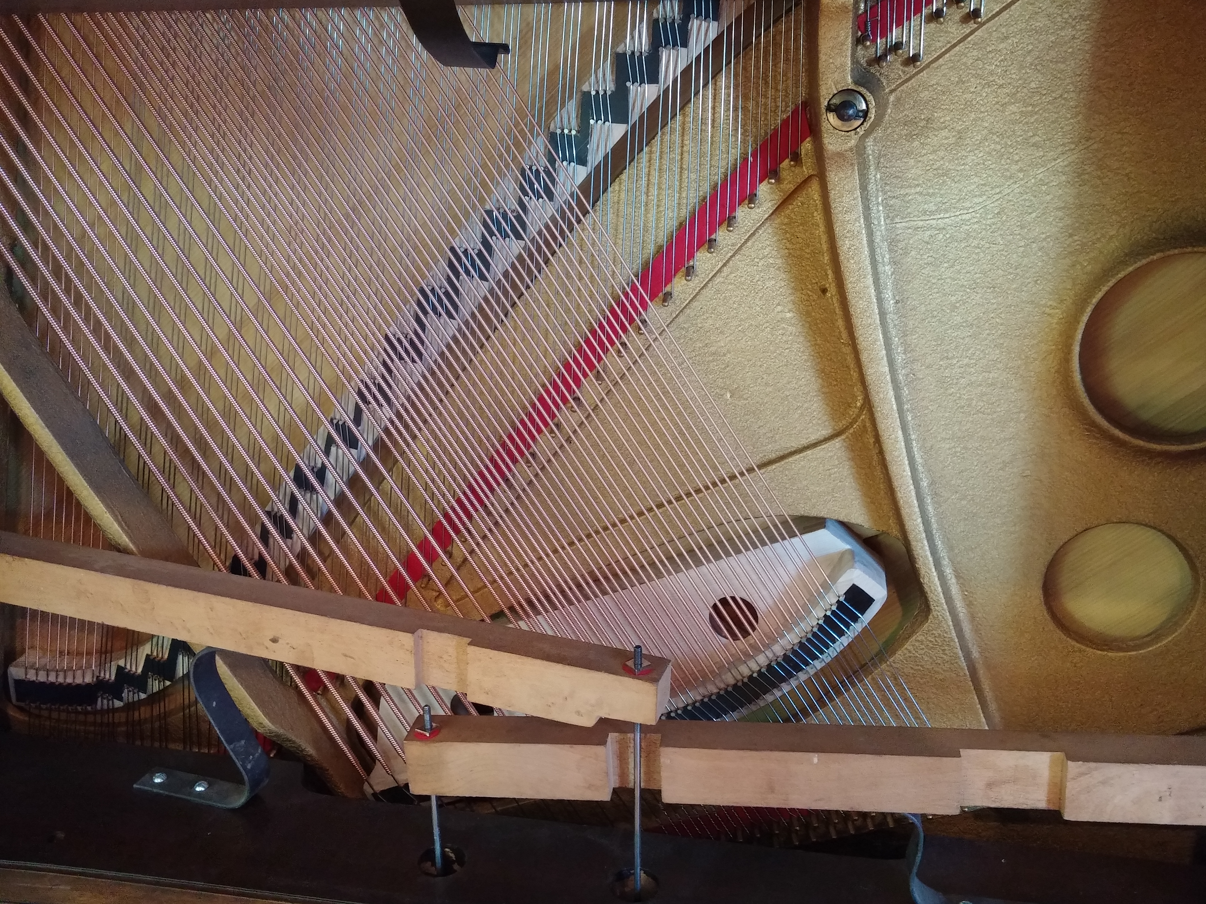

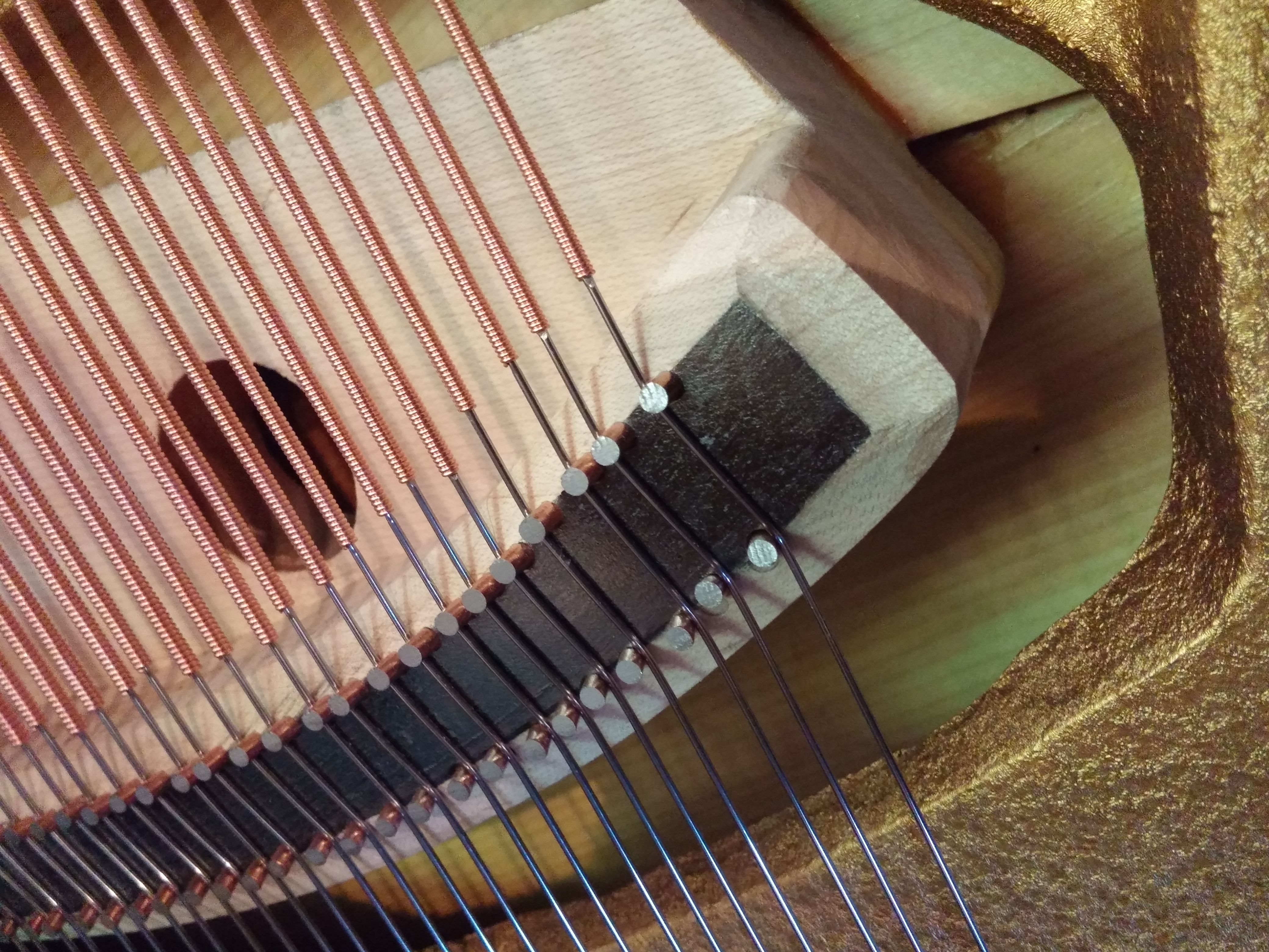

    Like I said, this Steinway P has been essentially restored. Opening it up it looked like new. The detail in the work was impressive. I saw that the original wippens and jacks remained but all the little felt pads had been replaced as well as springs, backchecks & wires and bridle straps & wires. Original ivories that were like new white, and no signs of any damage every having ever occurred to the case. I was told that there was one crack in the soundboard that had been repaired. Like Susan mentioned about tuning, like all Steinway uprights it put up a fight, but it sounded quite good when finished. Quite clear tone, considering, and a long and clean sustain. Here are some closer pics...
