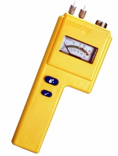

    Here's the moisture meter i'm using. Once 6% is reached it worthless. So, i end up only using it on firewood.
    chernobieffpiano.com

    try lignomat excellent products with various types that can be used for different wood groups they offer moisture meters with built in wood temperature corrections so you do not need to use a conversion chart
    I have a pin meter mini-ligno E/D  that can check moisture in lumber, veneer and fiberboard with a measuring range of 6-45%  for moisture value below 6% the meter will read 6.0 with a blinkingdecimal point   call 1-800-227-2105 or go to lignomat.com

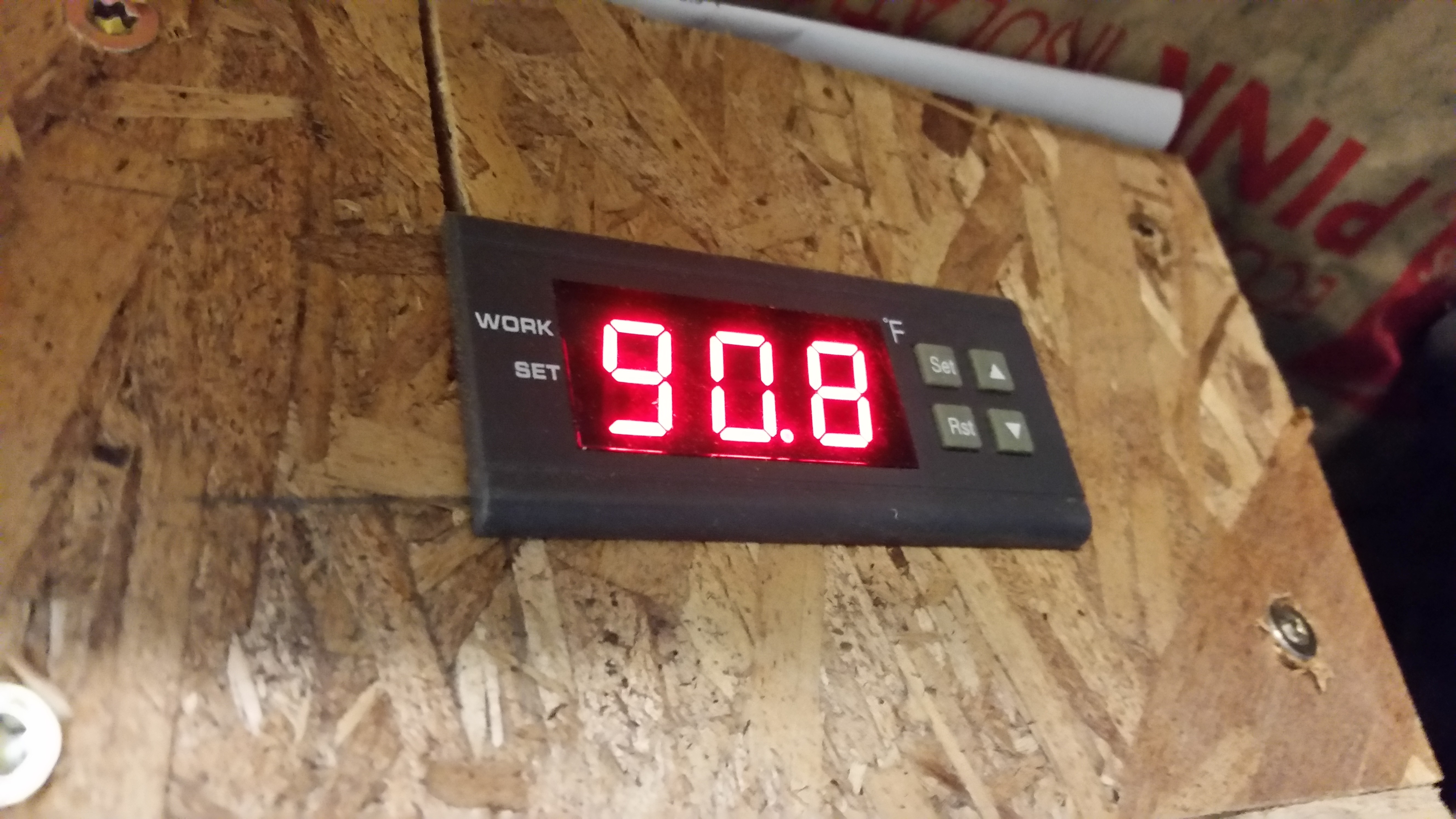

    I upgrade my thermostat to a digital temperature controller. This thing is fantastic!!! It has added a higher degree of accuracy. It keeps the hot box at the same temp within 3 degrees (low to high). Only took about 10 minutes to wire it up and put into service. It was only $15 and wow is the thing sensitive.

    Dang it Jim good question.
    First the mfg is Bayite. It's a tempurature controller. Specs -4 degrees to 220 defrees F.
    It's 110v at 10 amps. Admittedly it's on a 20 amp circuit. I have a neighbor that is a professional electrician, he said it's fine.
    I have a cheapo closet dehumidifier, that IS collecting water. I look at it as an extra way to remove moisture out of the box, the same way a vent would. It's inconclusive at the moment, but it appears I'm operating at a slightly lower temp to maintain the RH I'm targeting with it.
