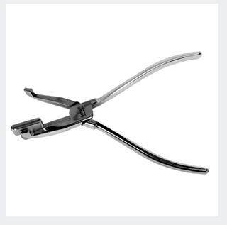

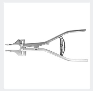

    Does anyone have a opinion/preference on these easing pliers? They both look like they will do the job of easing grand piano keys without having to remove them.  I ask because there is a significant difference in cost.

    The first one you pictured is my favorite. It can ease grand keys without removing the stack. I got mine from Renner.
    I started out with the second type you pictured. It only works if you can completely remove the key. That isn't a problem on uprights. However, on grands that could be an issue depending on how much time you have. I got to the point where spending an extra 20 minutes unnecessarily was causing scheduling issues. So I switched over to the above type. I've never regretted it; in fact, many times I've been very thankful I made the switch. It's worth the extra money.

    You do realize, Randy, that you are asking a dyed-in-the-wool packrat to make a Sofie's choice. I have both pliers and carry both with me. But hypothetically, if I could only carry one, it might be the second one pictured. I some how got it in my head that the smaller jaw in the mortice and the larger plate that goes against the outsides of the keystick (vs. two jaws of equal size) are more benign as it seems like there is more pressure applied to a smaller area of the bushing and a larger area to absorb the pressure on the keystick,. But to make such a judgement may be splitting hairs. Raise your prices for key easing and get them both? ;-)

    I don't have either of these pliers - mine to not allow grand key easing without removing the stack (I'm so jealous!!!) - I honestly didn't know that type was available..... :-(
    One thing I haven't seen mentioned is that the pliers in the first picture appear to maintain two parallel surfaces and the lower one does not - the lower one relies, presumably, on a pivoting pad for proper alignment of the other surface that applies pressure to the bushing. Now that may well work just fine and not be a detriment (I'm trying to think - mine might be like that - and it works well, after you've removed the key!). Perhaps someone with that direct experience might want to comment - it might make a difference.

    In any case, the key stop rail will need to be removed so the keys can be lifted high enough to insert the tool. After reviewing the photos, 'it appears' that the one in the second photo, can only compress the left side bushing when working with the action in the piano. I went ahead and ordered the first one. It is more universal and the twin blades are thinner which helps with clearance. In fact, I'm hoping it will replace my traditional easing pliers -  which means no additional clutter in my already packed tool case.

    The pliers in the second photo can compress both sides of the bushing. There are three elements in that tool: the plate, which goes against the outside of the key, and the two working elements which go inside the key, depending which side one wants to compress.

    - The pliers in the top image have jaws that are always parallel. However, on many pianos, the balance rail mortices are not always parallel to the sides of the key! The second (cheaper) pliers can accommodate this discrepancy. (Keys need to be taken off the frame for this tool to work here)
     -  The second pliers have been known to break. This happens when the tool is over-stressed. It seems some technicians cannot differentiate between easing a cloth bushing and crunching the begeezus out of the wood of the keystick.
