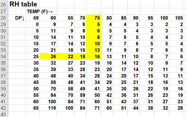

    Having trouble reading the psychrometric chart I have in my shop. Trying to find chart that gives me:  @ a given RH/temp F, change in temp results in what new RH   ​

    JIm, the attached table should work.  The example shows current temp = 60°F at 26 %RH.  Move horizontally to the 75°F column and read the resulting humidity = 16%RH.  PM me and I'll send you the Excel spreadsheet which produced this table with the psychometric equations.

    That's it John, and in the realm I need for my hot box (which currently is cool and has damppchaser pads in it.  I'll PM
