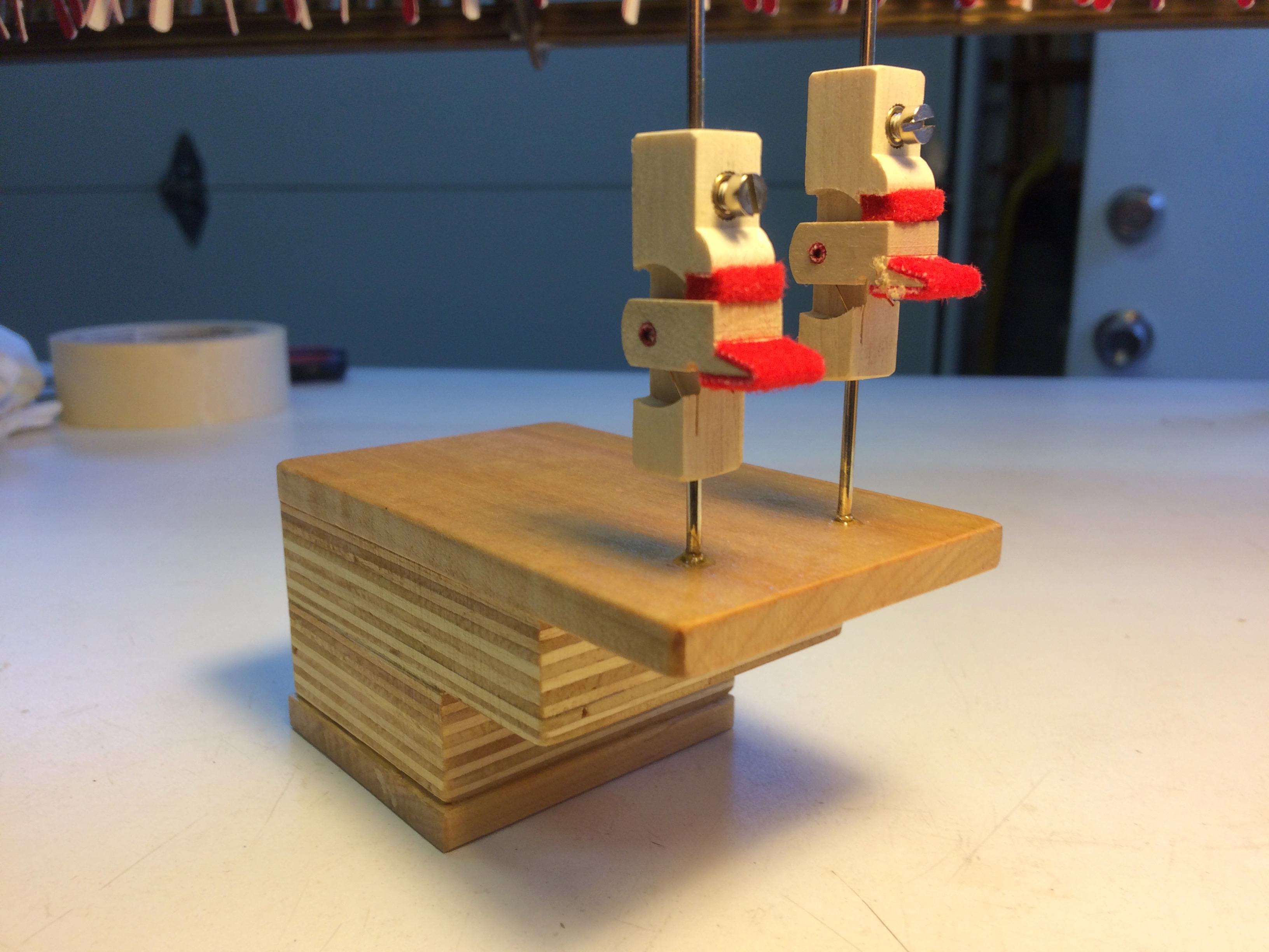

    When I get a problem like this the first thing I ask myself as a shortcut to a solution is: what is the most likely cause of the problem?  The likelihood that the sustenudo rod is out of position is not the first thing I would look at.  That would be the adjustment of the sustenudo pedal.  Often I find that it is simply not rotating enough to engage the tabs because there is too much lost motion.  Try this first--you won't even need to pull the action.  If that doesn't work, proceed to fiddle with the position of the sustenudo rod, but before you go down that path, use a sharpie or something to mark the position of the supports on the action brackets so you don't go making things irretrievably worse.   It is useful to have a transfer jig.   Here's what it looks like.

    that is one fine looking jig. Would you mind explaining how you use it?

    Thank you, Karl.   The transfer jig enables you to duplicate the position of the damper underlever both at rest and when the sustain pedal is depressed while the action is outside the action bay on your work bench.  You can thus adjust the vertical position of the sostenuto rod more easily than by trial and error.  The in-and-out bit  (i.e. the horizontal position) still needs to be done in the piano with the cheek blocks in place as Mario described.
    Credit for this idea goes to David Hughes, RPT, whose excellent articles on grand dampers appeared in the Journal in 2014.
