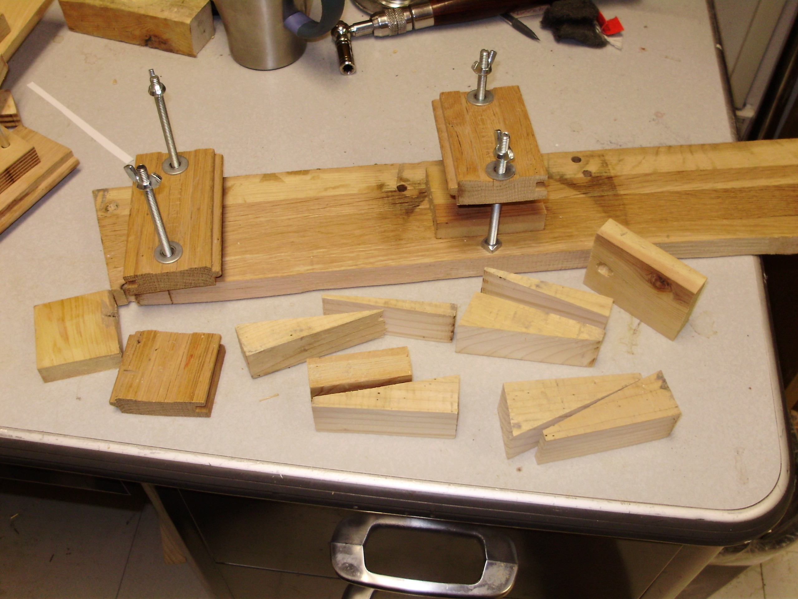

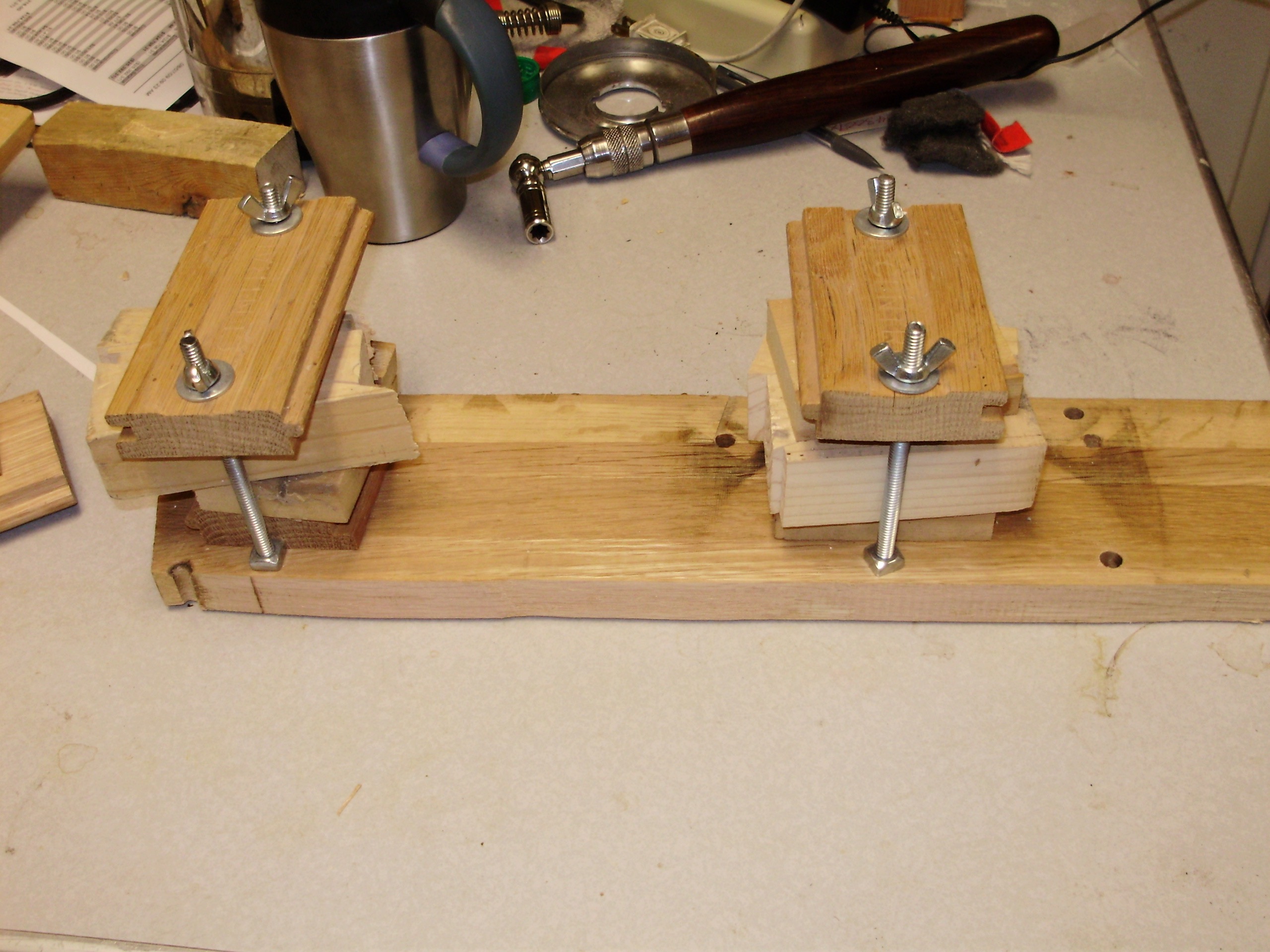

    In any case, I find that I am eventually successful in getting the right permanent bend in a key using moisture, heat, and a clamping arrangement. The clamping jig is pictured. The key is immobilized at the balance point (where it is weakest) between pieces of wood large enough to span beyond the mortise on both sides. The end of the key to be bent or twisted is pulled down toward the base with the other clamp (wing nuts pulling another piece of wood). The wedges are for the purpose of correcting a twist, if any.
    The basic process is to wet the key thoroughly, the portion you want to bend (staying away from felts, leathers and glue joints), by painting water on it, then wrapping in a wet cloth for a while. With that done, clamp to the jig and measure the distance from the part of the key you want to bend to the jig. Take the amount by which you want to bend the key (say 3 mm) and multiply it by 3. Tighten the clamp to pull the key by that triple amount. Apply heat from a heat gun, using a deflector to get the underside of the key (between it and the jig) as well as the rest of it. Get the key good and hot to the touch, and completely dry, moving the heat gun constantly to avoid scorching.
    I won't say it is 100% effective the first time, but after the second or third time I have always had adequate success to call it a permanent fix.

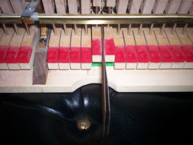

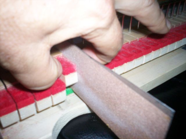

    If the rubbing is pretty minor, I just remove wood. A quick way is pictured: two metal sanding files back to back, between the backs of the keys, hold the keys together with a bit of pressure while you operate the files.

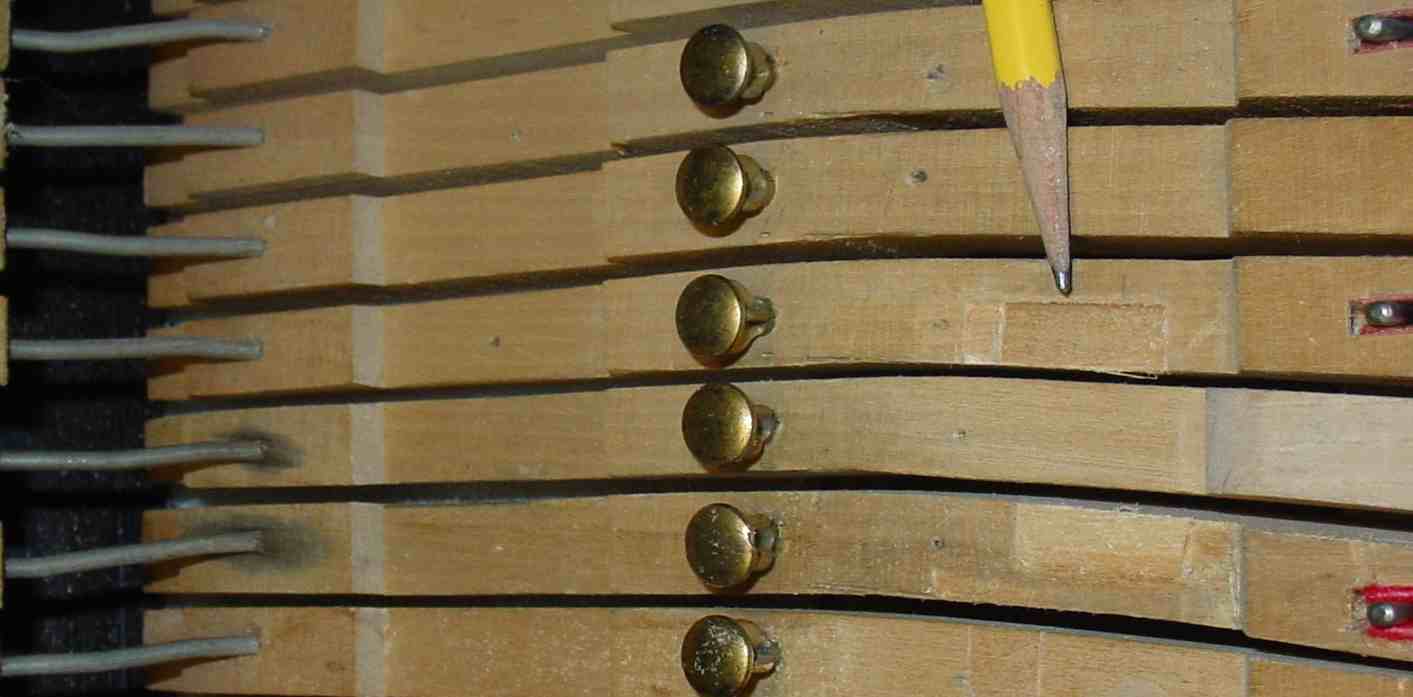

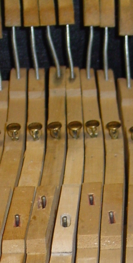

    You could install what I think is called a dutchman. You cut a notch in the key and insert a piece of wood slightly larger that the gap which forces the stock to bend. I've done it a few times with success. Two keys were converging on the center key with the new button. I installed dutchmans to force the keys stright.
  • 14.  RE: Warped Key
    Posted 10-30-2015 07:48
    This was what the keys looked like:
