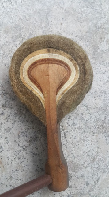

  • 118.  RE: Brahms Temperament
    Posted 01-28-2019 15:35
    Mariio,
    If played with a modern pianist's fingers technique, calibrated to the higher mass and inertia action (and the belly, etc. to match), I could see that the higher ratio might seem less controllable, and that initially it might seem to provide a smaller range of both timbre and dynamics. However, if one's technique is adapted to the finesse, lower energy input, and small finger movement of a higher ratio, lower mass action, I believe the control of layered dynamics and timbre becomes quite noticeably greater. (Granted that the high end of the dynamic range is lower - but so is the low end, so the range remains fairly equivalent). At least that is my own experience.
    This is particularly true when trying to bring out one voice above others, to put it in its simplest terms (in fact, the more difficult part of the equation is getting the other voices below the level of those you wish to bring out). A more complex problem is creating three or four dynamic/timbral levels simultaneously. We struggle to do this, because it is an unnatural thing. Somehow or other, one finger in the hand must accelerate its key to a significantly faster speed than the other(s), thereby making an analogous difference in the speed of the respective hammers.
    With more mass and inertia to move, and a relatively shorter distance for the hammer to travel (low ratio), creating this effect requires a greater amount of "difference of effort level" between the fingers. With high ratio, the same difference in effort/speed results in a greater difference in resultant speed of hammer, because that difference is accentuated by the ratio.
    My opinion about this was inspired first by experience, later by analysis. Ten years ago, I visited a pianist in France, and played her mid/late 19th century Pleyel. I was playing Villa-Lobos, and some pieces where I had struggled to make differences between three and four layers of dynamic/timbre simultaneously. My mind was blown by how effortless that was, and how easy it was to make even larger differences.
    I puzzled over this for some time, and finally analyzed it as I have reasoned above. Subsequent experiences have seemed to bear this analysis out. And other pianists I have spoken with, who are familiar with playing high ratio early instruments or reproductions, have tended to echo what I have said.
    I should add that with respect to timbre, I am assuming hammers that are well constructed with reasonably fresh materials, not 150+ year old, hardened leather and felt that has lost all resilience. in the period prior to something like 1860-80, choice and layering of the materials was done with extraordinary care, to maximize the timbral range, with the low end in particular being made far easier to achieve through the disposition of the layers.
    As one isolated example, here's a sample of a Pape hammer, in which the inner layers would be progressively hard to soft leather, the outermost being two carefully produced felts with a composite of hare and rabbit fur together with silk. The number of variations of shape and materials of 19th century piano hammers is mind-boggling, as each maker strove to create a unique sound.
    For contrast, here's a set of Érards
    and a curious Pleyel (the hollow circle is reminiscent of one of Cristofori's).
    "Art is not a mirror held up to reality, but a hammer with which to shape it." Brecht

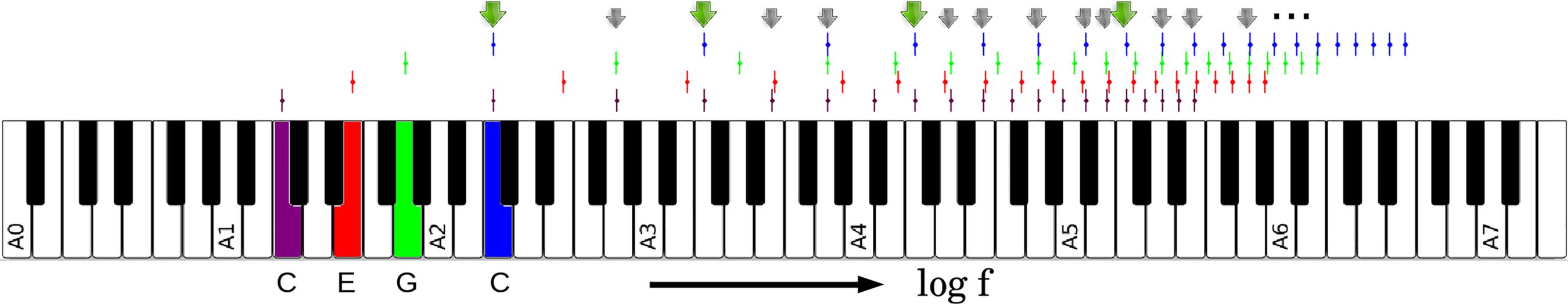

    In doing some more research on the battle of concepts of the scale, an important article on minimum entropy scales http://www.scielo.br/scielo.php?pid=S1806-11172016000100410&script=sci_arttext has a very helpful diagram
    One major assumption is that particular chord isn't one we see often in music - the tuning that derives from its logic is a theoretician's rather than a musician's scale.
    The result of the stretched octave logic tunes the instrument's scale to its own inharmonicity. The inharmonicity is what takes the instrument into the realms of the metallic. This might be the sound that piano manufacturers want but it's not the sound through which to express meaningful music, or rather music meant to convey meaning.
    We can see the logic of stretching the scale so that that E above middle C has both the red and the purple harmonic coinciding. And then actually the major third C-E becomes wider and more harsh. Who's been jibing at wide thirds in Unequal Temperaments? This concept makes them worse, universally so none are sweet.
    If instead we start out from the concept of Kirnberger III which has a perfect C-E third, and we don't stretch the middle three octaves at all, and we tune Tenor C downwards harmonically - that's C2 downwards, then for the chord of C major we have perfect C2E2, C3E3, C4E4, beatless. We have C1 tuned so that its 4 harmonic falls on C3 and the 5th harmonic on E3 and 3rd and 6th harmonics very near to their respective G2 and G3. The sound is wonderfully pure and resonant. When we shift up to C# then with a perfect fifth on C#G# the even harmonics add up, and the 3rd coincides too, and the 5th harmonic is so shifted from F3 it's not associated with it at all. This means that we remove it from resonating with the sustaining pedal down. So at once we remove confusion in the sound, allowing Chopin and Beethoven pedalling to be sustaining passages for many bars, and as the pantalon, and we make the sound more coherent in the technical sense, more resonant. And as we slip from one key to another we really do get a different timbre in the built up chords, chromatically, as in a spectrum that we see in the rainbow.
