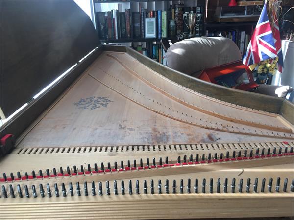

    This morning I began the task of finding out what I have.  It looks like its a Zuckermann Flemish I-III (53 note).  All the strings were loose, rusty, so they came off (detune - then snip).  Next came out all the old plastic derlin jacks.  They are warped from age, and some are missing the adjustment screws.  Being that this is a 8' 4' instrument, thats going to be a lot of work to revoice!  The good part - the soundboard looks pretty good - no major cracks, only minor surface crack near the 8' tuning pegs.  Its missing the jack rail and keyback as well, but I'll call Zuckermann and see if they can make / have extras to sell.  There were two things that concern me however.  One is the upper guide for the jacks - the 8's one.  Where the stop screw goes in on the left, it's cracked (see picture).  The second is the lower guide raill has holes that look like they were put in by a 10 year old with daddy's hand drill. They're not really centered.  The last thing that only minorly concerns me is the legs.  I've seen other Zuckerman Flemish models with the hefty stand Zuckerman offers.  I may opt for one in the future, or have one made.  Last minot minor thing is the keyboard was not mounted, just set in the instrument, so I'll have to properly get it set in.
    All in all I think it will make a nice winter project.  What do you think?  Am I totally mad for attempting this?

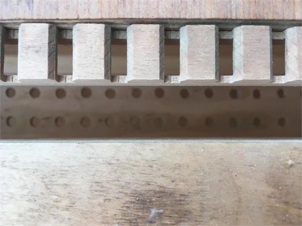

    Not sure how easy it would be to remove the existing lower guide, but it isn't a particularly hard thing to make. Just a line of holes spaced probably 1/2" apart (measure from the top string to the bottom and divide to confirm the spacing). It is nice if you bevel the tops of the holes a bit for ease of inserting jacks. It can be installed with 90 degree angle brackets if the existing method is too difficult to duplicate (often screw holes are drilled on the bottom of the belly rail before the structure is put together, but I'm not sure about that particular year). The challenge is lining the holes up vertically with the string spacing, but that isn't rocket science, just being careful. Drop a few vertical lines from the centers between strings, and use them to find the best compromise.

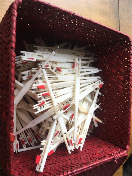

    Note that Zuckermann jacks are no longer made that way, but new Zuckermann tongues will fit in the slots, so you can use them. Their current jack rail would probably work as a replacement with minor fitting operations.

    "Not sure how easy it would be to remove the existing lower guide, but it isn't a particularly hard thing to make."
    Doesn't look like its going to be too hard.  Its nailed in from the bottom, and it doesn't feel like glue was used.  I agree angle brackets would probably work fine.
    "Note that Zuckermann jacks are no longer made that way, but new Zuckermann tongues will fit in the slots, so you can use them. Their current jack rail would probably work as a replacement with minor fitting operations."
    Yeah, and the original design wasn't great.  From what I understand the design works but it flawed and not as 'strong' as it should be.  I've already looked at the conversion kits for this model (they are about $350 per choir) and think I may just go that route.
    I think I got pretty lucky overall.  There are minor build issues, too much glue in some spots.  Also the finish is - kinda 1970's antiqued'.  Not exactly high-end.  I COULD re-finish it - or have it re-finished, but for me playability is far more important than fashion.  Considering I paid a whopping $80, I think I can live with the original finish that was applied.
    The soundboard has some staining on it.  To me it looks like someone spilled some tea on it. and it dripped in from the crack on the case.  I'll know more once I get the soundboard cleaned up.  This being the holidays, I have Tuesday through Sunday off and will tackle the cleaning then.
    The sound that came from the few notes that did work was pretty loud and clear.  I think with the proper strings and voicing it should sound pretty good for a bodged together kit.
    Lastly, the keyboard is good except one key sticks a little.  I'm amazed it isn't all wonky with warping or with bad construction.  Whoever worked on this did some OK work at times, and at others, not so much.

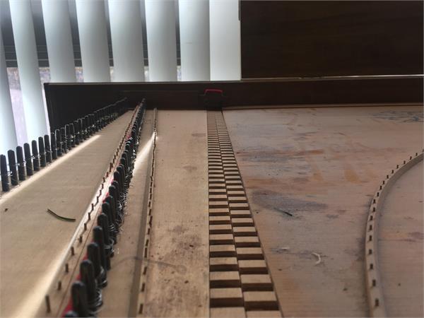

    The one thing I am now concerned about is a crack along the tuning pegs (closest to the keyboard).  It doesn't look wide or deep, but it does run horizonally across the pegs.  Any advice from you kind folks on how to fill or stabilize this crack (see pics).
    Also the soundboard is FILTHY.  Now that I have the strings off and can see it, wow.  Something dripped / spilled onto the wood.  I'm worries about the stains.  I had just planned on gently sanding the surface and coating / sealing the wood.  Thoughts on how I should proceed on this as well?  Keep in mind I do not have a shop and am doing this in an apartment.  Using a belt sander is a no-go.  LOL.  Not only would the sound bother the neighbors, but the dust would make one hell of a mess.  All repairs will have to be done 'by hand'.
    Thankfully the keyboard is just peachy with no warping, excessive play, or rubbing (just a smidge on one note).  I did note that there are ZERO weights added to the keys.  None in the front, OR back.  Wouldn't that make the keys WAY too light?  I don't mind a bit of a light touch, harpsichords are not pianos, but zero weight seems like it might be an issue with being able to play repeated notes.

    Typically a layer of spruce, matching the soundboard, is glued on the top of the pin block. Assuming this is the case, a crack in it is purely cosmetic.
    To clean the soundboard, I would start with a cabinet scraper - rectangle of steel sharpened to have a wire edge (curled bit of steel that extends beyond the flat surface of the scraper). This can remove very thin layers of wood, and won't rub the dirty dust into the pores as sandpaper will. It is possible that applying a thin coat of orange shellac will make it look quite a bit better.
    The keys have been undercut for balance - wood removed under the fronts of the keys so that the back is heavier than the front. That is a normal way to accomplish what is needed. Typically one wants minimal mass, and just enough difference in weight that the back of the key will float down to the back rail. 20th century modern design harpsichords (like Neupert, Sperrhake, etc.) have​ bushed keys and key leads. At this point Zuckermann was still bushing keys (which adds friction), but was trying to be more historically accurate and avoiding lead weights. The mass of the jacks is enough to assure return and repetition.

    Those jacks are original Zuckermann. The later ones are an I-beam in cross section, and so you need a slot instead of a round hole for the bottom guide. Hubbard jacks have a square bottom, but it is in line with one edge of the upper body, rather than being centered. As far as I know, nobody is making a jack with a centered square bottom at this point (though they can be made from wood, and there are people who will do that for you).
    I experimented, and found that the Hubbard jack would work fine in my Zuckermann Flemish, without replacing the bottom guide. They slant a bit, but function just fine. Any jack you purchase, you will need to trim it to size, often both bottom and top. This isn't a problem if you have a band saw, but it more time consuming otherwise. You will also need to install screws top and bottom (if the design uses screws), and possibly drill for the bottom screw. Current Zuckermann jacks have no screw, but you do need to cut the bottom to match the size you need - and since there is no bottom adjustment screw, you need to do that very carefully, as it will permanently set where the plectrum is relative to the string. That needs to be consistent, or the feel and control will be lousy.
    I don't know Zuckermann's model numbers, but it is 8 X 4 with "lute" stop. Another source for wire and parts is the Instrument Workshop, along with Zuckermann.

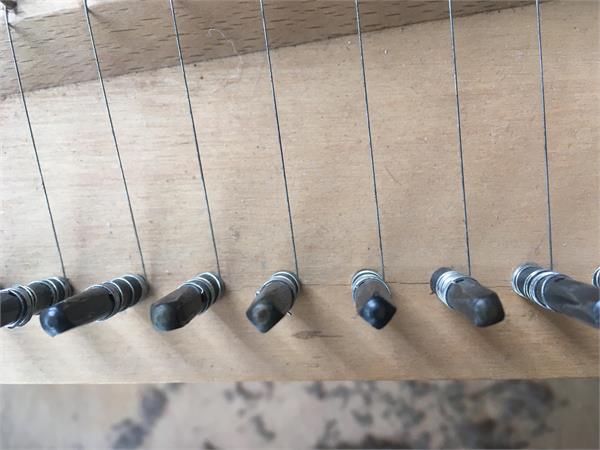

    So I ended up sanding the soundboard and part of the pegboard as I am not comfortable with any other tools.  The badly done stencil was easy to remove, and the shellac matched the rest of the finish quite well!  You can still see a little staining, but a nicer stencil will fix that - maybe - we shall see!
    Ryan Price

    Looks very nice! I would extend the shellac to the rest of the pin block, myself (go ahead and put it around the tuning pins).
    I notice there is a bit of separation between the hitch pin rail and the bent side at the top treble (at least it looks that way). That might be no problem, just a matter of the kit maker not getting it to match the curve of the bent side. But you should take a look while you have it unstrung, and ensure that the hitch rail is solidly attached.

    The gap was part of the construction.  The gap has glue down inside of it where the soundboard and outter case had a gap, then was filled in.  It's actually quite solid.  It just doesn't look good match.  That was an early concern of mine but I did google and fine a few posts about people not getting this right.  The biggest take away I got from it was that 'as long as it's solid, its OK.'
    I do plan on putting shellac down around the rest of the tuning pins, but I do want to remove the buff stop and do it properly.
    This is by far not a high-quality build for sure.  I can see why someone may have gotten discouraged.  There are just a lot of little things here and there that weren't exactly right.  I.e. - someone got in a hurry.  There's the gap at the hitch pin, a missing tuning peg, a few of the string pegs are not leveled correctly.  There is evidence on the soundboard that the inner 4' hitch pin rail was removed, re positioned, and then attached with some filler used on the previous holes to cover up the blunder.  However, they did get most things right.  The strings lined up correctly.  All of them sounded (the ones that had quills remaining on the jacks anyway), but the broken register rail is probably why the kit was abandoned entirely.  I have a feeling they didn't pre-drill the hole before putting in the set screw, or they over tightened it.  Either way, the screw was missing or removed and meant that the jacks didn't meet the strings properly. I did slide the register over and make certain I got sound on most of the board, and I did.  It also looks like someone just totally gave up as some of the quills look way too thick (the ones remaining) on some and all but cut away on others - i.e. someone had zero clue about voicing and stopped in the middle.  Ironically the middle range of the strings were in tune and somewhat voiced, so I know someone at least tried.
