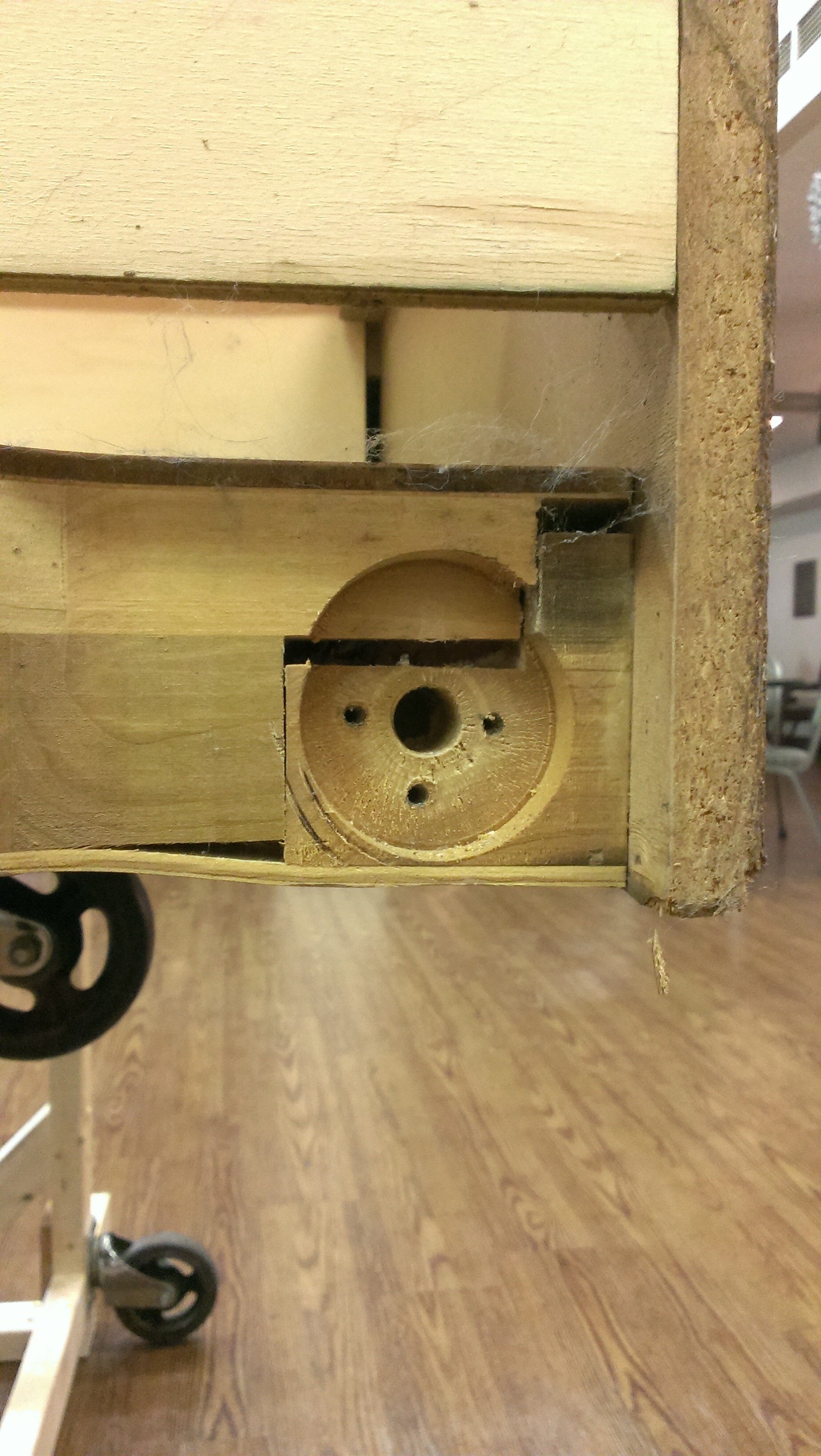

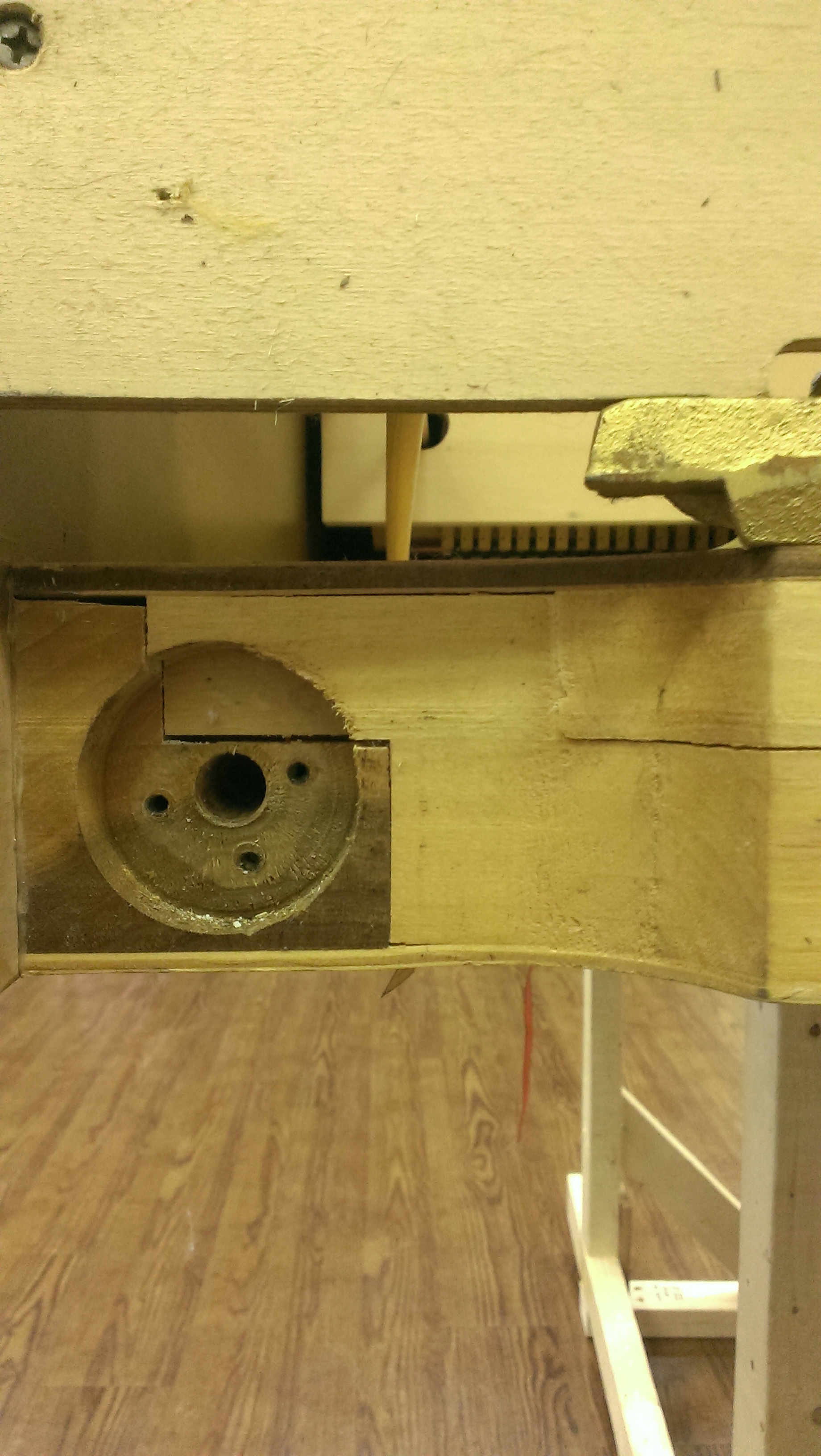

    Just wanted to follow up on my questions regarding the dollies.  I installed the set I was asking about today.  While the piano was on its back I saw some damage I hadn't expected that must have been caused by repeatedly rolling the piano on its original casters.  Thought I'd share the pictures with you all.  I am now much more inclined to recommend dollies to clients who need to regularly move their pianos.

  • 19.  RE: Piano dollies for console/spinet with skinny front legs
    Posted 09-24-2014 22:00
    I'm not sure why the second image is rescaling to be the same width as the first one...
