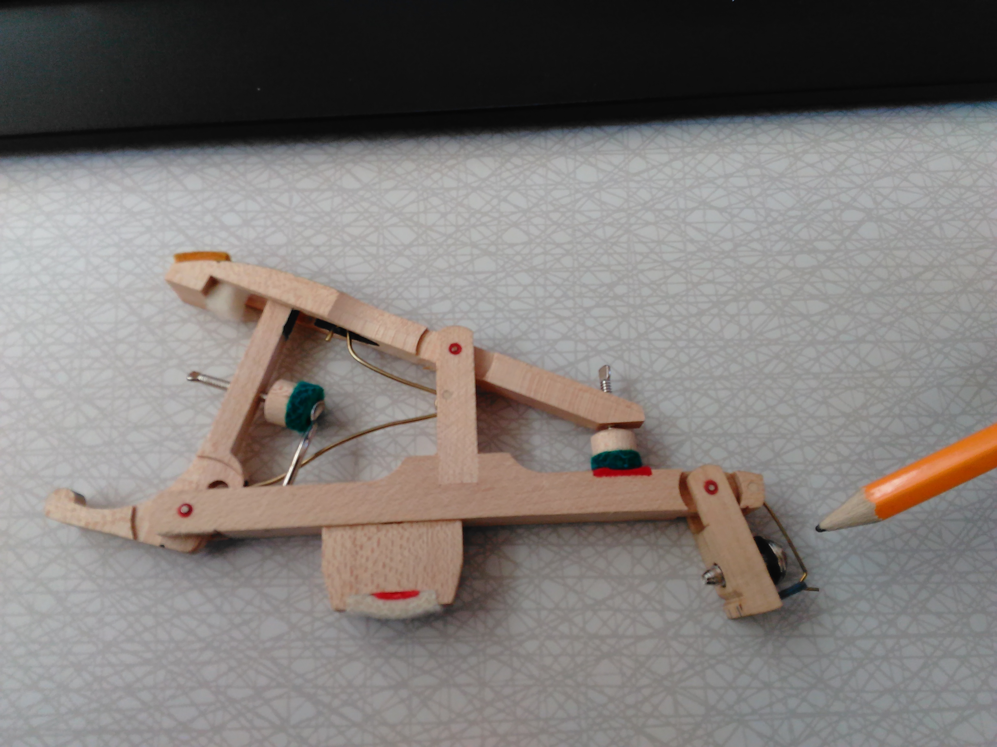

    Dear Technicians,
    I am looking to order one of these exact replacements (see picture) Its from a mid 1990s 5'8" kohler and cambpell grand. I looked on Schaff, and they dont appear to carry this model, with the little spring/rope flange. Do you know where to get one?
    Also.. the A4 in the middle went out, for some reason the jack got warped and therefore stuck, and the key woundt work. So i asked the customer if I could take the Highest 'C' whippen and put in place of the A, in the mean time, while her parts are being ordered. When doing the swap, i noticed a large different in the touch/ repetition spring weight. Bending rep springs is not something I do yet. Any ideas?

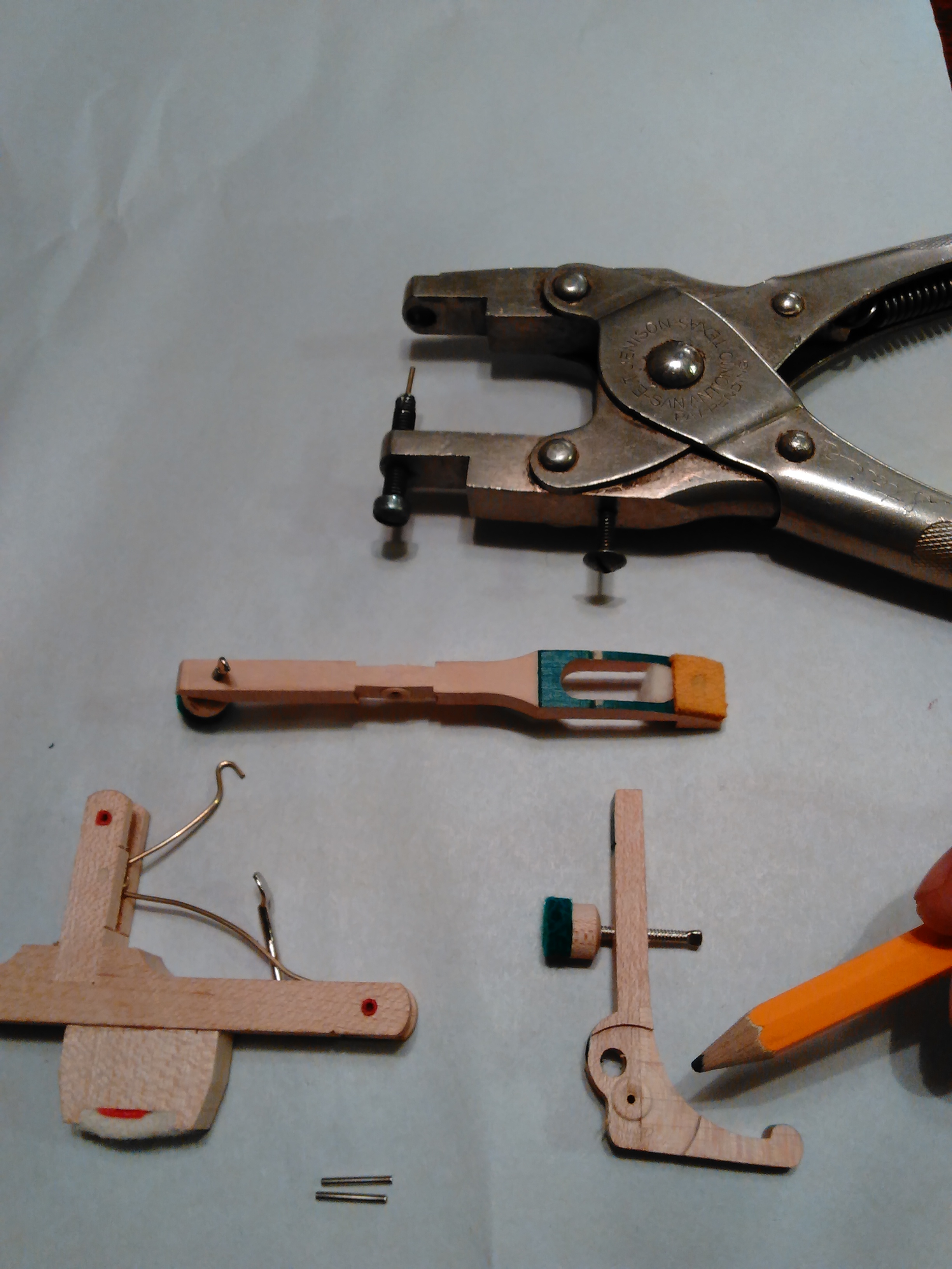

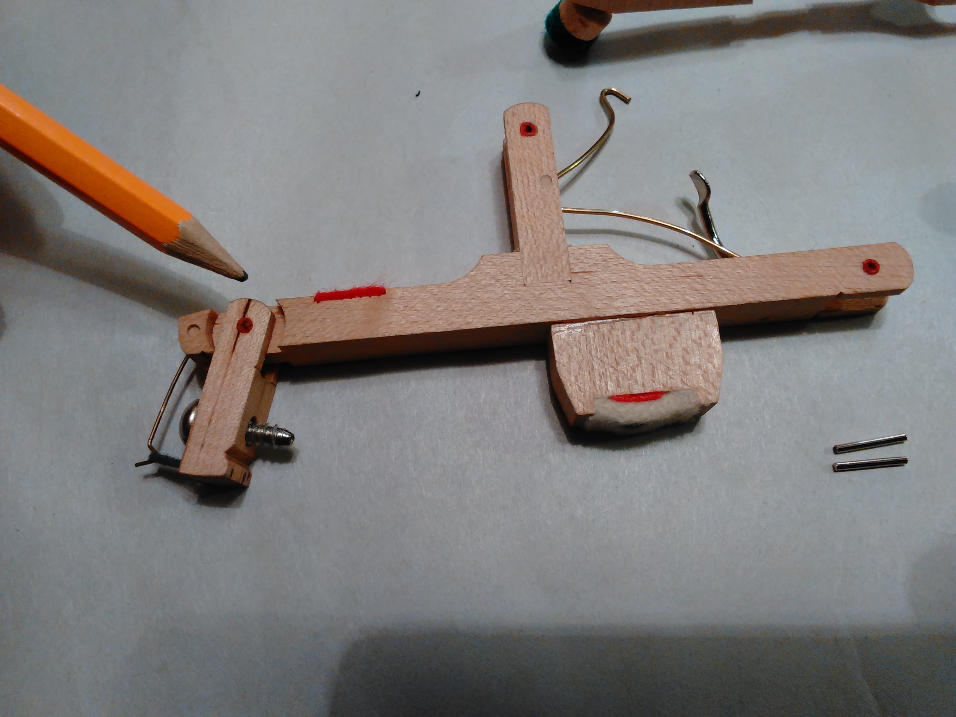

    I believe the problem here is the wood is warped in multiple locations. I did thouroghly inspect the center pins, and tweaked the tower, but in this case i believe a new whippen is much more cost effective over trying reglue a new tower, rebuild the whippen, add new parts ect. This particular whippen is a dud. It's semi slit as you can see.
    The customers home was also between 85 and 90 degrees (its winter, and they're an old couple), which I also believe added to the wood warping on this piano. Because I have tuned this piano for this customer at least 3 times over the last couple years and it never had this problem before.

    From your description it sounds as though the jack centerpin is bent, which causes the jack to rub against one side of the rep lever.  This is easy to remedy by repinning.  If the centerpin hole in the jack was drilled off-axis, you'll need to bend the pin appropriately to center the jack in the window; the technique for this process can be found on p.156 of Mario Igrec's Pianos Inside And Out.
    If you're assessing the diffierence in touch weight between those two wippens at the front of the key, there could be other explanations than rep spring strength (though that is a possibility).  Be sure to check the flange pinning of the wippen, jack, and rep spring.

    Hi Leif, as I recall there's an area of the whippens that don't have those whip flange assist springs.  If so, take one from right next to where the springed ones start and replace it with the "build your own" type that Schaff sells on page 110.  It would be a non-assisted one replacing an assisted one but I doubt anyone would notice.
    Option number two, choose a suitable match from the ones shown and modifiy it to match.  (grind off the hammer cushion with a Dremel)
    Option three, purchase a minimum order of them from K&C (Samick).
    Option four, maybe someone on the forum has a suitable replacement you could purchase.
    Larry Fisher
    Vancouver WA
    360-256-2999
  • 9.  RE: 1990s Kohler & Cambpell Whippen Replacement
    Posted 12-10-2015 10:16
    option five, replace just the offending/warped part.  Jacks are available individually if that's the bad part.  If it's the tower, you might be able to get a way with rebushing, and then repinning.
