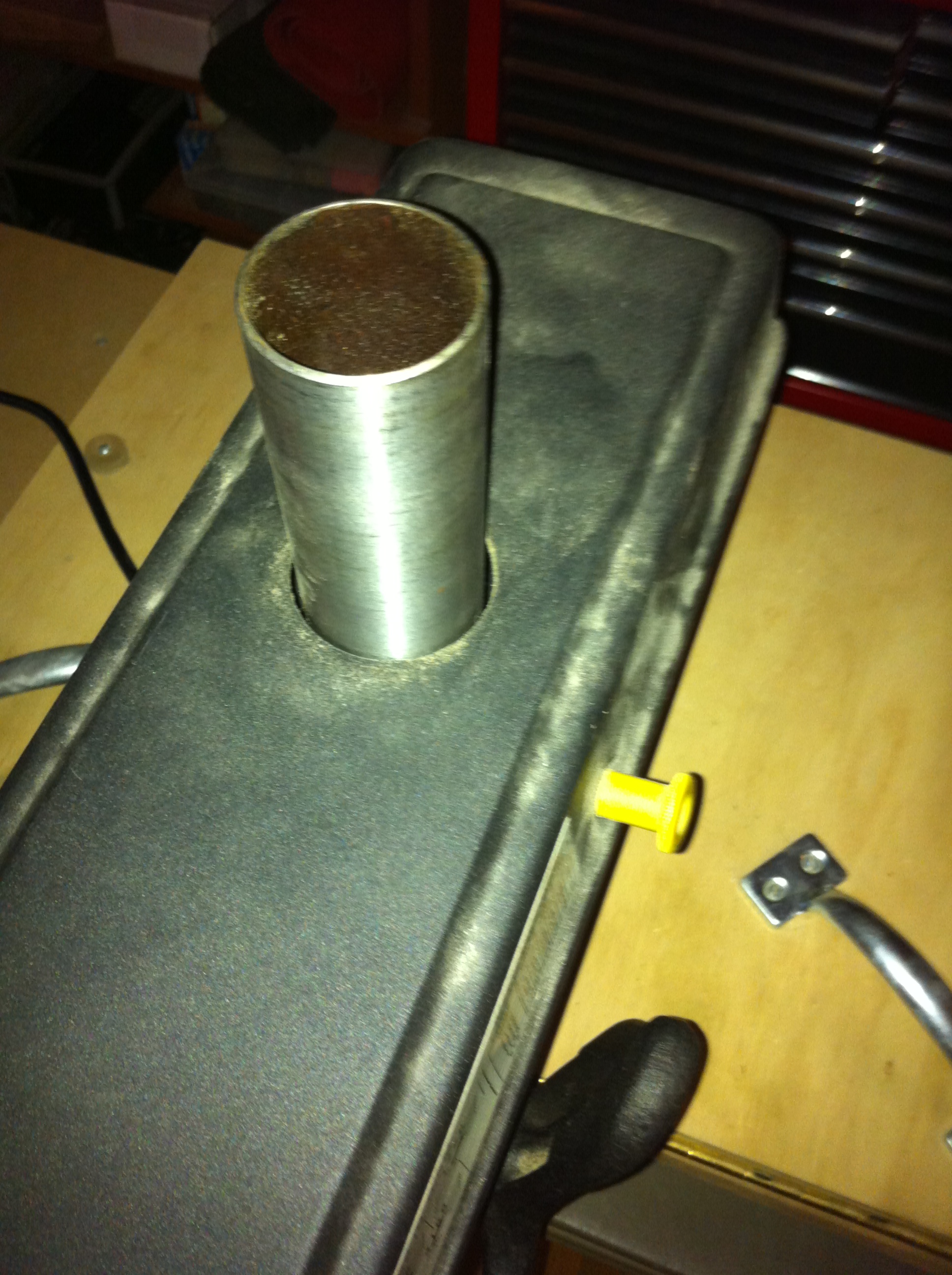

    Another alternative:
    Buy a good quality floor standing drill press for general use.
    Buy a small, cheap table top press and modify it for use as a designated pinblock drilling press, turning the head 180 degrees and making a base which can be tilted a few degrees. Use it floating on a table that you rest on the piano, double-drilling the pinblock in place.
    704-536-7926
  • 8.  RE: Drill press info
    Posted 12-21-2015 19:07
    I don't have a full photo of the small drill press, but this detail shows how I converted it into a small radial drill press. I cut a hole in the top of the head case, which made it possible to slide the head down to the bottom of the support post and rotate it back 180 degrees, from which position it could drill pinblocks in the piano.
    704-536-7926
