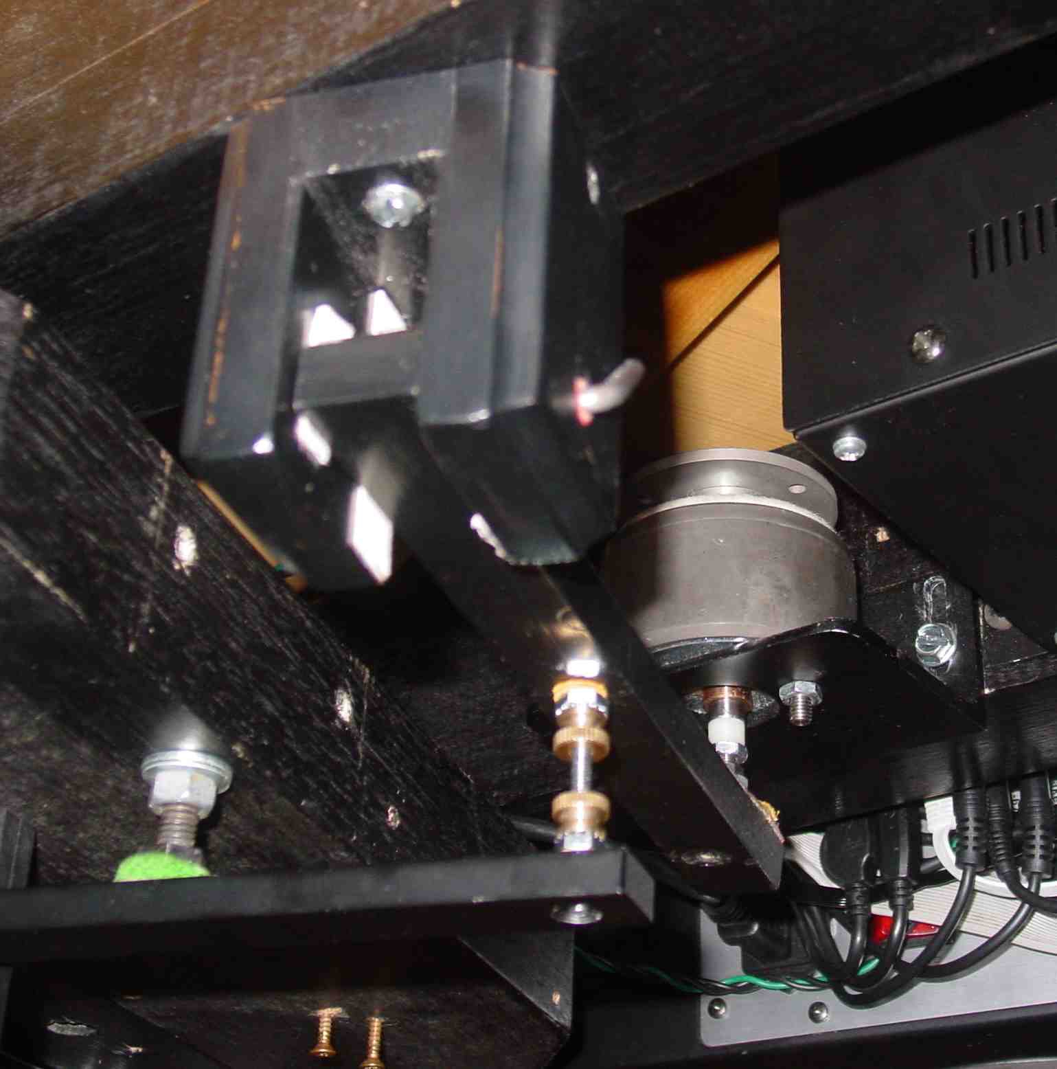

    I made a lever to work the iron PD lever which cut the leverage in half. The solenoid works better as does the pedal.
    >>Correction, this application was on a QRS PM II. It initially did not have a pedal solenoid. It utilized something they called "Magic Fingers" which held the played keys down a little longer (I suppose). It did not work well and I installed the solenoid, then the lever to make it work better.

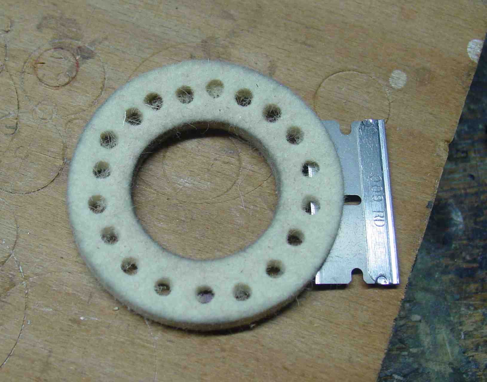

    I also punched holes in the solenoid felt and sliced it partway thru to quite it down.
