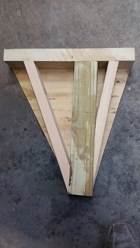

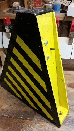

    For those who don't want to spend over a thousand dollars for something so simple. i offer this design for a DIY Piano Tilter. I used a 4 x 4, a 2 x 4, and 1/2" plywood.  Its all glued, screwed, and doweled together. I will be using it soon and will post pictures after the next move and show it in use.
    And all put together, and given a little paint job.w17mSKaQimVhDov0hbnN_mandhdone 044.jpg

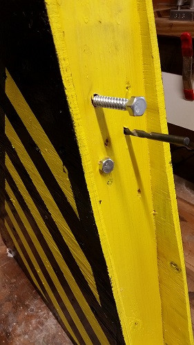

    The lag bolts and drill bit for attaching it.

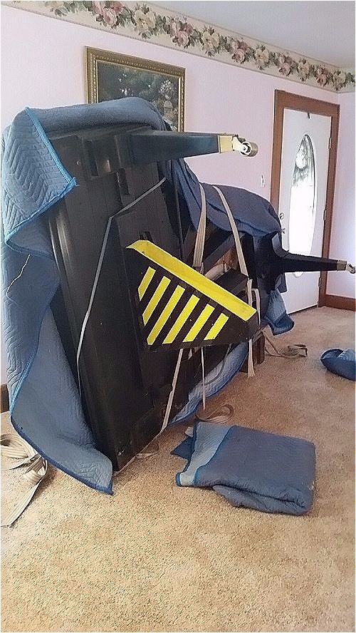

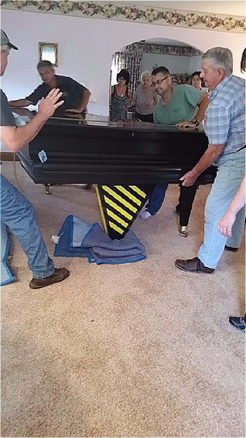

    Well, the titler worked awesome on its maiden voyage. In Fact, now I got a name for it "The Earth Cat". Because its so down to earth and i like cats. Anyways, It easily handled a Mason and Hamlin BB.  Tilted onto a folded moving pad, which allowed it to hold the bass up high enough to allow us to put on the final leg. So easy and it cost less than a hundred dollars to make. ufQeQMVLQPCmsfa4WrSj_mandhdelivery 025.jpg
