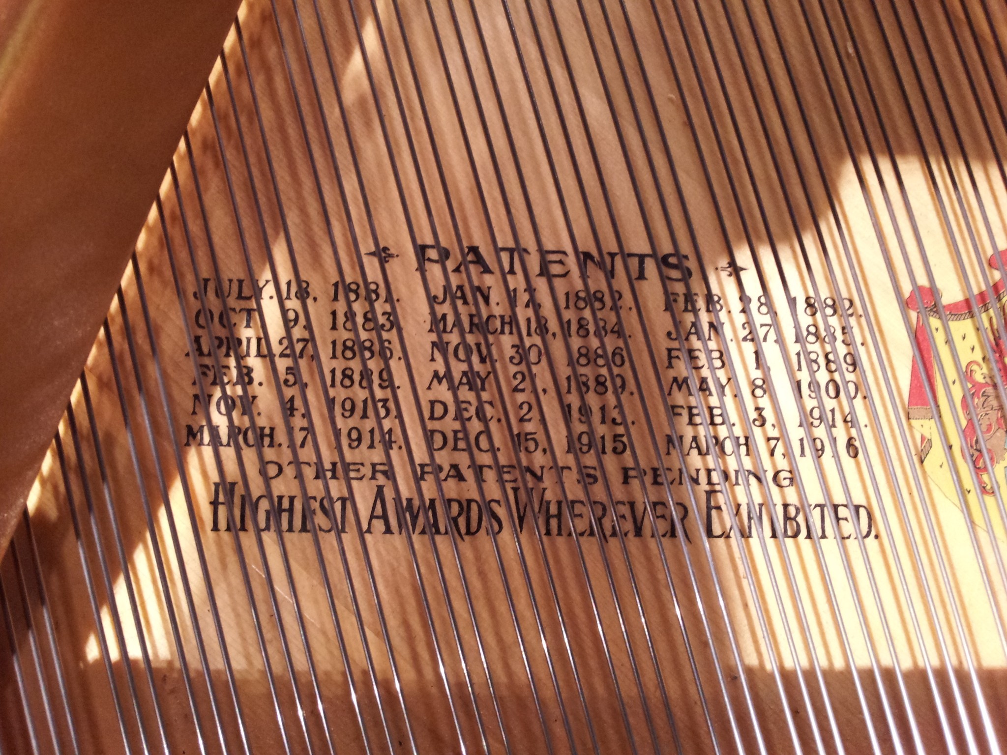

Mehlin and Sons pianos that i have rebuilt were built like shrick bit houses. I have developed a nickname for Paul Mehlin, I have always thought of him as Mr. Patent.Pending.

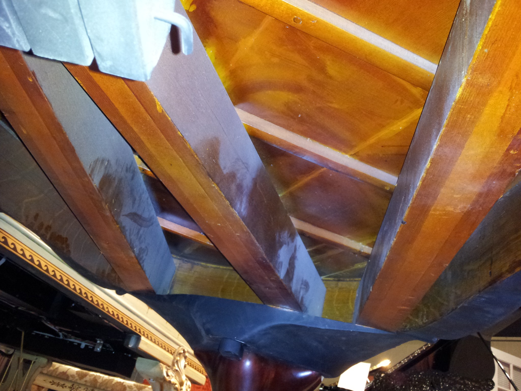

In the grand i worked on, the beam structure had laminated beams and the inner rim and bellyrail was ash. pretty stout!!
I thought the soundboard had lost it's tone on this one, but the owner didn't want to spring for a new one. I thought the rib structure was too spaced apart too.
Overall Good bones (so to speak).
