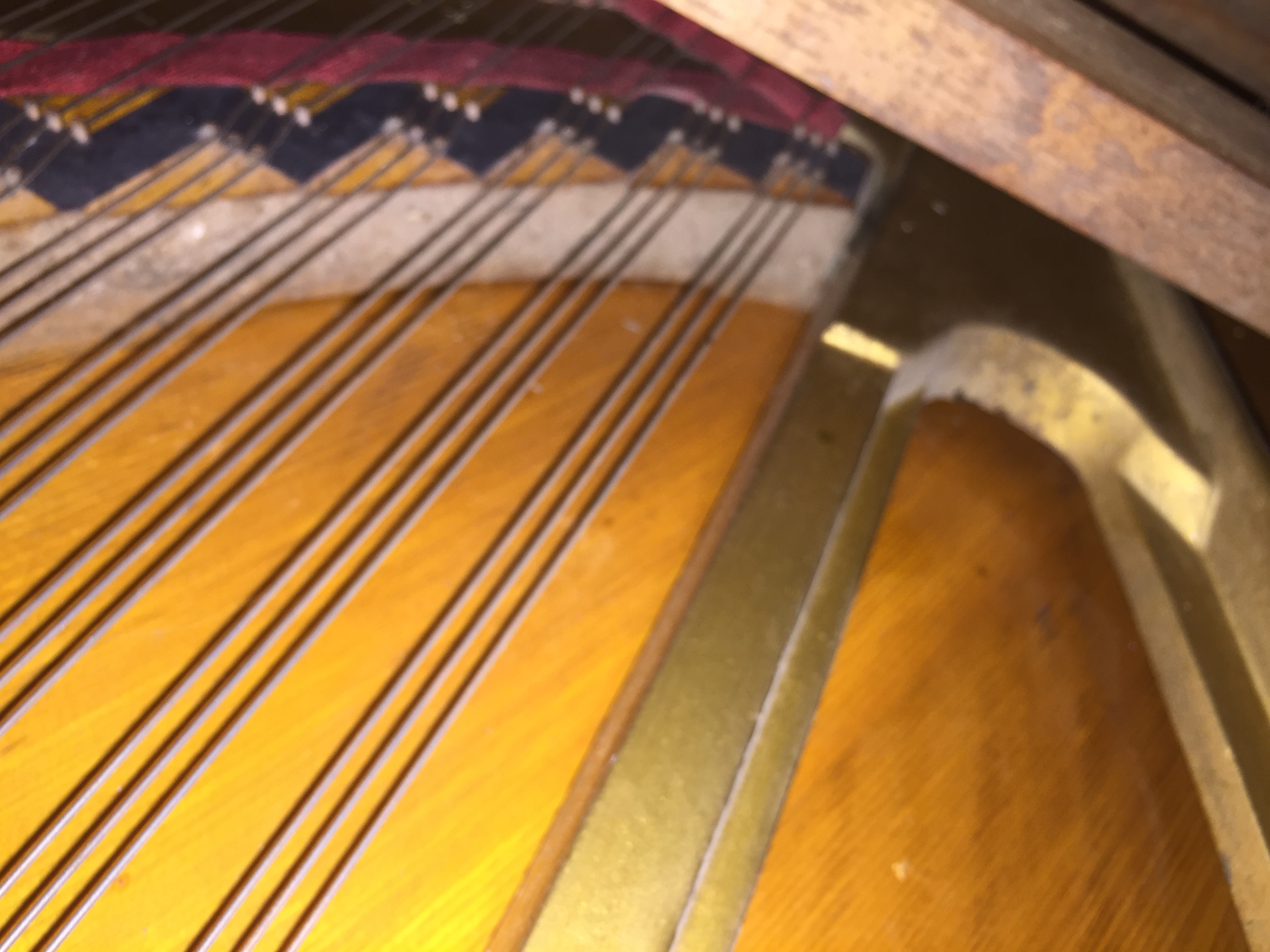

    For inquiring minds ...
    Seems like this is still part of the same topic.
    Here is a photo of the part of the bridge I thought looked strange. I am 99.999% sure it has nothing to do with the buzz. But someone requested a photo. It's pretty blurry.
    Basically, the first few inches of the bridge (starting at the bottom/left end of it) are glued "normally" to the soundboard - the part of the bridge to the left of the first set of strings. Then there is a stretch of maybe 5" where just the edge of the bridge that would be against the soundboard is carved away a bit (behind the next few sets of strings), and then it's flush against the soundboard again.
    I know manufacturers were always experimenting, but I can't figure out what the point would be.
    A thin stick of wood with three nails in it, rounded edges on one side. I looked all around the piano for some place it could possibly have come from. The piano was designed with only two pedals, so it's not a muffler rail. I couldn't find nail holes anywhere. Hmmm. Just now I'm wondering whether it was something that held a cloth over the back of the piano - like when the back is facing people instead of a wall. I didn't look up there on the back for nail holes, but I will. But what are the rub marks?
    Like all of you, I really hate not being able to figure things out. And the only thing that mitigated my self loathing about breaking off that antenna behind the plate was remembering the Squirrel Cop segment from This American Life. I have it on my phone but I didn't need to re-listen to it because I pretty much know it by heart. If you want to feel like it's a good day when you don't set somebody's couch on fire in an effort to "help" them, listen to that. Just google "Squirrel Cop." It's one of their most famous (true) stories.
